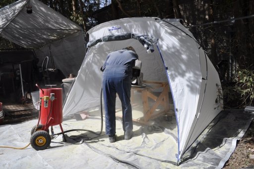

I sandblast a fair number of things either in my cabinet in the garage or in my outdoor “containment cabinet” :blush: which is a spray shelter. It works but is far from ideal. Iv'e blasted items that were powder coated and it definitely takes more time and effort.
I agree that poorly done powder coating is usually the problem. I think that’s sometimes the case with after market companies that want to get things out the door at competitive prices. Some of the black steel wheels for example, although many of those are probably just painted. Good powder coating shops can usually do a much better job.
