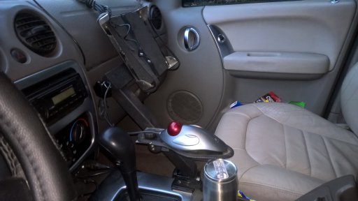

Made a new bracket for the Jeep. So I can use the toughbook also when I am doing a solo tour.
So now I have two "tablets" during a trip. The Galaxy tab and the panasonic toughbook.
And the bracket provides "flexebility" to change easy from solo to co-pilot situations.
Co-pilot stand, needs a bit of adjustment, but will look like this.
And this is the solo position
When all finished it will look better and will be sturdy.

Old trackball mount and angle plate: Makes a new Trackball Mount for the Jeep. If it works nice on sunday, will make it nicer.
