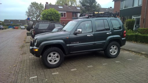

ok, first Mods are done.
Roof Garden on it and new tires (which I had for the Frontera) Falken 245/70/16
Well it looks better. The tires are better, but they look so lame. just bigger as standard.
Well first we need a lift, then we could do some nice MT tires on it.
But that will have to wait untill these are gone.

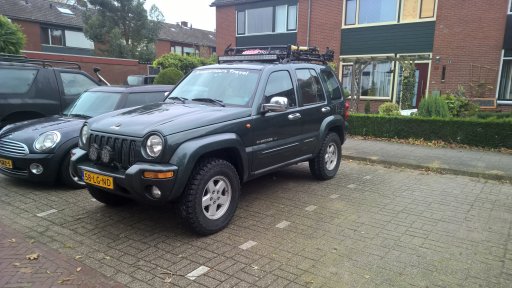

And again a little Mod done.
The LED Light Bar is mounted.
Wiring the lights in will happen tonight. Need to find all the right fuses.

Little update of this morning.
High Lift is mounted as well
This afternoon it will be USB time.

And again some work is done.
Now everybody knows this is a Dragonriders Travel vehicle.
And now it has some more LED lights as well.
