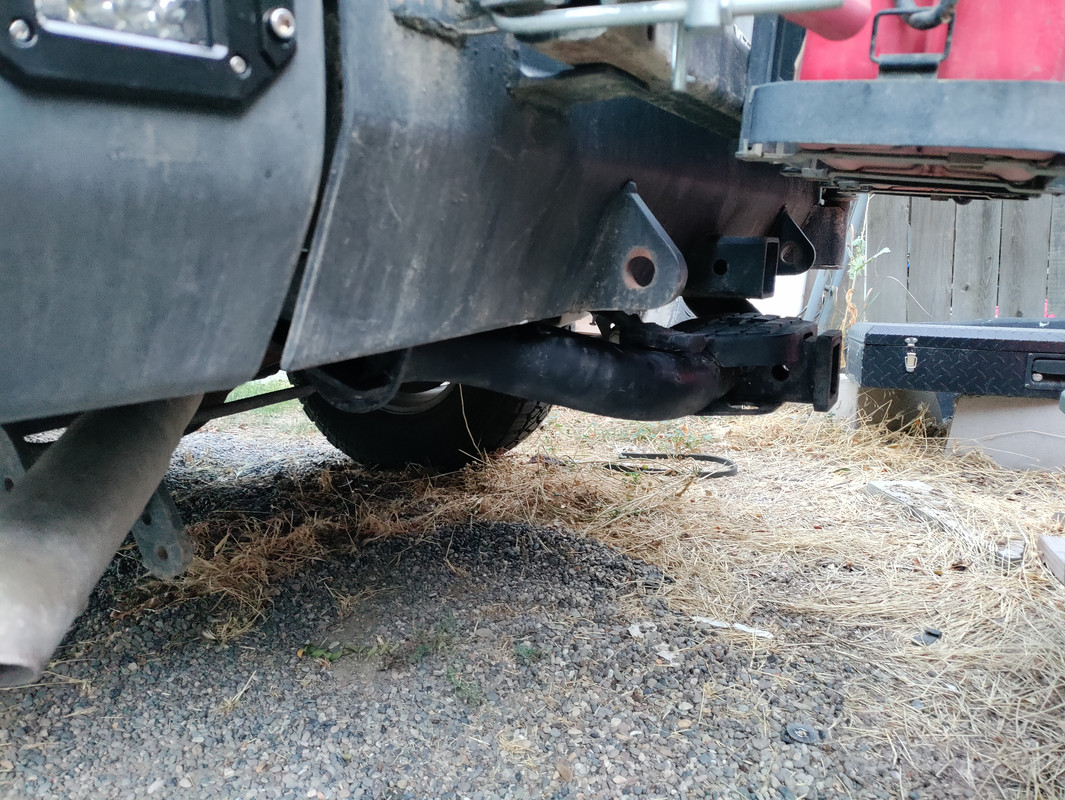

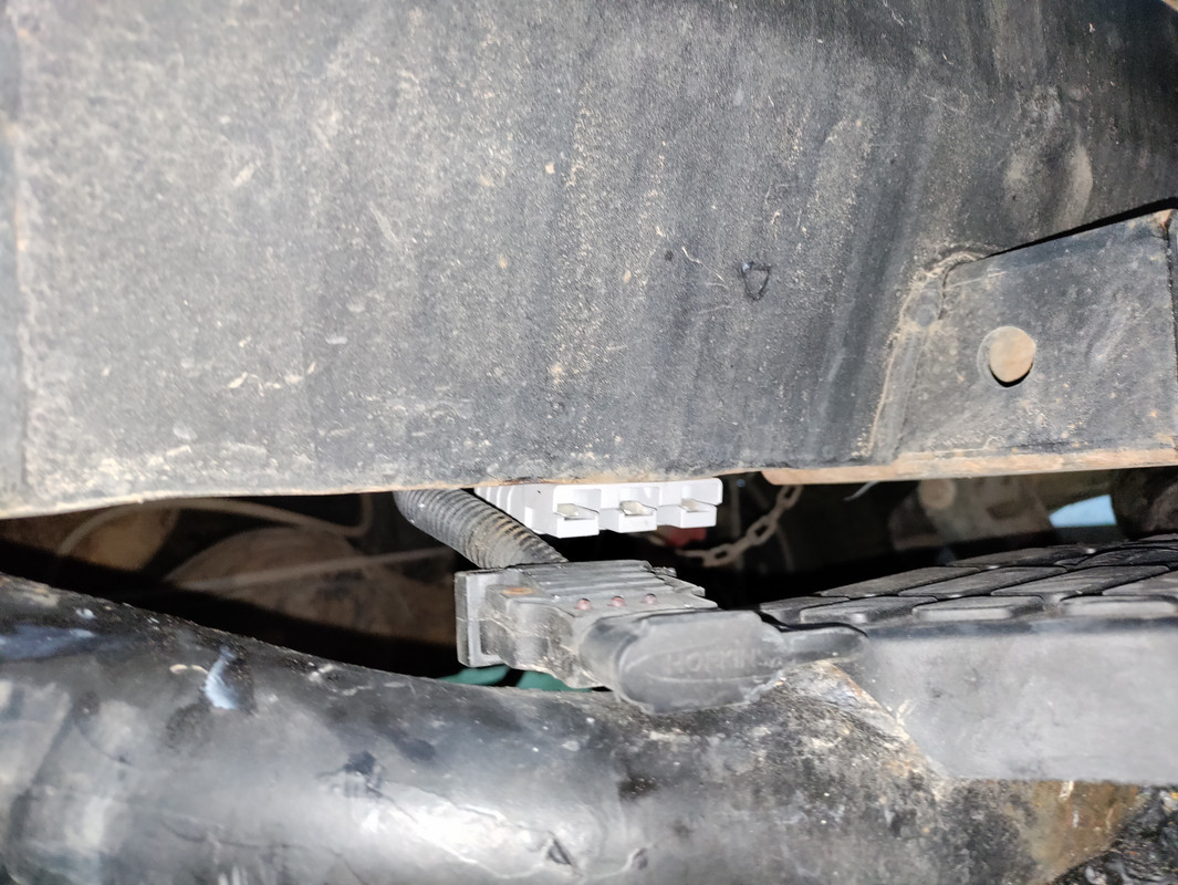

First up, is I finally installed the tow hitch, and wired up the 3-pin anderson connector to power the 20A dc-dc charger when towing the trailer:

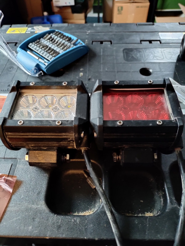

I also installed a new Auxbeam 5D light bar on the roof. I was hoping to test it out and see how bright it was on the last trip.... But alas.
I'm also going to be replacing the 20in bar in the front with a couple of 7 inch spots.

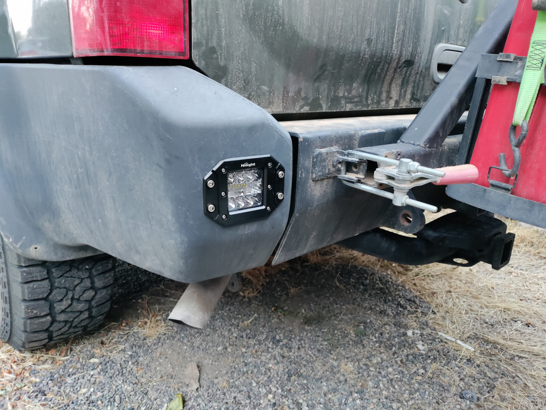

We also mounted and wired up my auxiliary back up lights in the bumper caps:

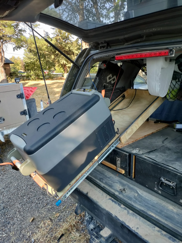

And finally, I built a new tilting fridge slide to house my new setpower AJ30 fridge. I went with the 30 since if I take just the X, I never fill up the 40L, and it's the perfect size for day trips with the family, or just myself for 4-5 days.
I opted to forgoe the gas struts this time, and went with a limit strap in the rear. I use 1/4-20 t-nuts to mount it to the drawer system.

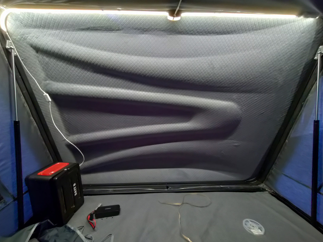

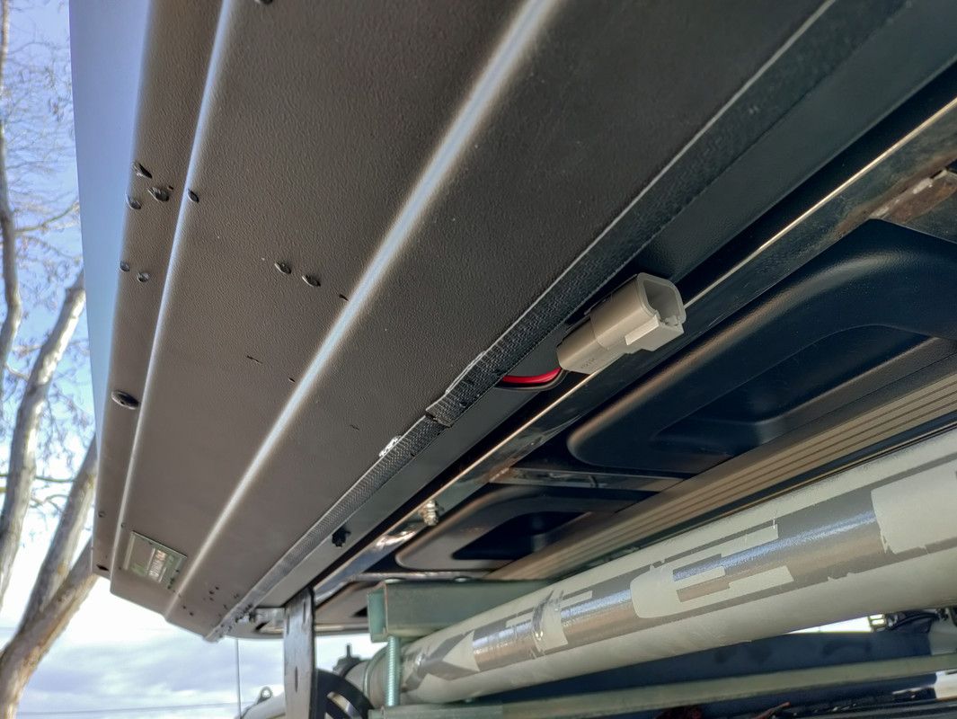

Finally got around to opening the new rooftop tent.
Got the light installed in it:

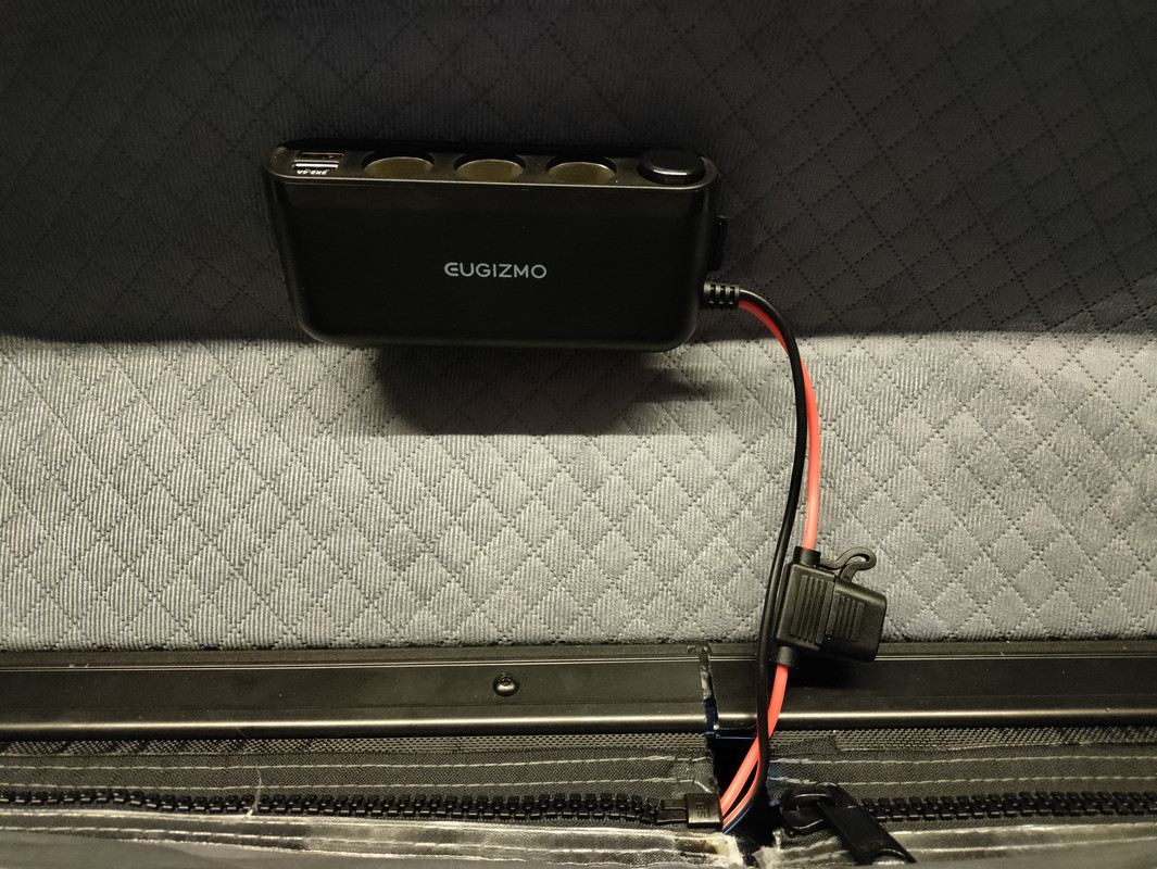

Got the power box mounted, and the plug run to the bottom side of the tent. Still waiting for some 12-2 wire, that should be here tomorrow.

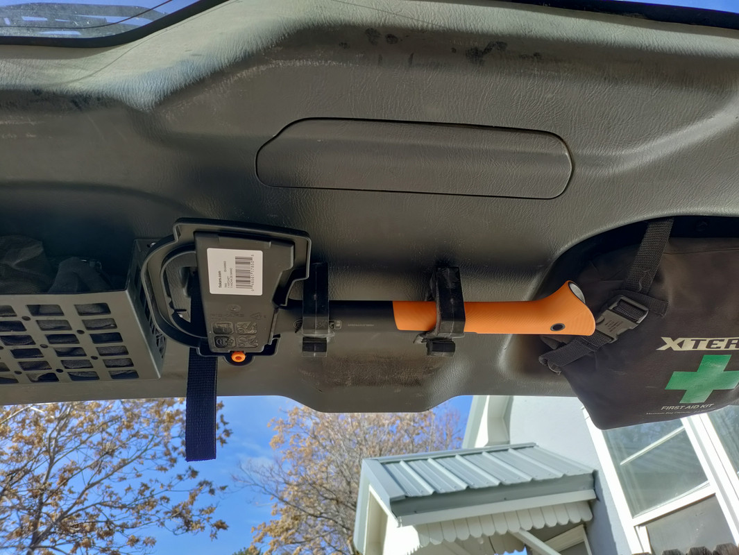

Got my new hatchet mounted to the inside of the hatch using quick fists:
