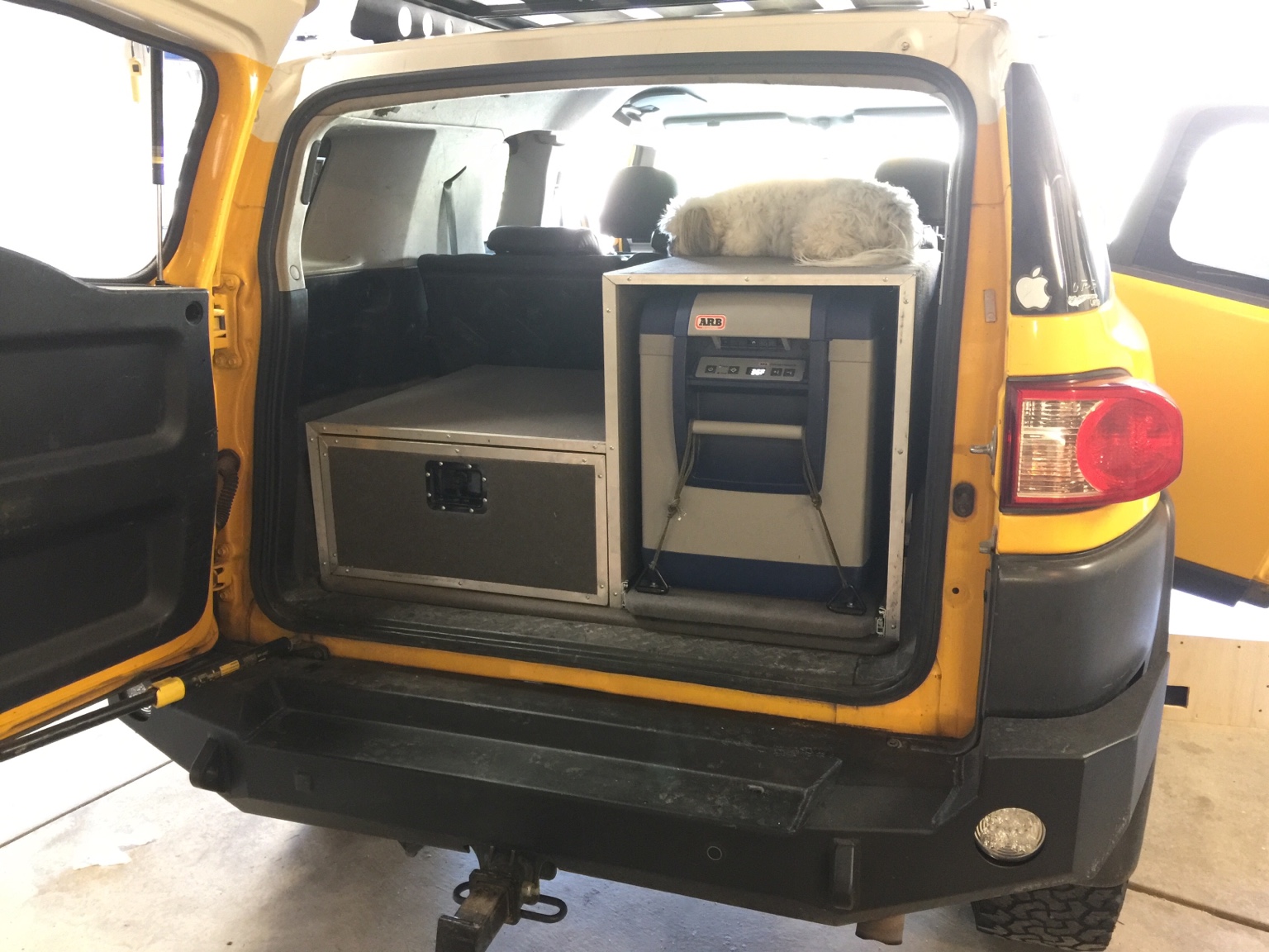

I've gone through a few home built setups... but I've finally settled with my current iteration.
I removed the rear seats. There's one full length drawer on the drivers side. On the passenger ide I have my fridge on a slide out and a small kitchen drawer under the fridge. Behind the fridge is where house my fuse panel, 1000w inverter and some camera/drone battery chargers.
Video tour.

I have built several of these. I like the one drawer setup for weekend trips and fitting in the errands around-town. The two drawer worked well while traveling on long trips to keep the dry food organized and camp gear separated. I finally nailed the design fit. It fits an ARB fridge, bolts to factory mounts, and with the rear seat up. I’m building now to sell.

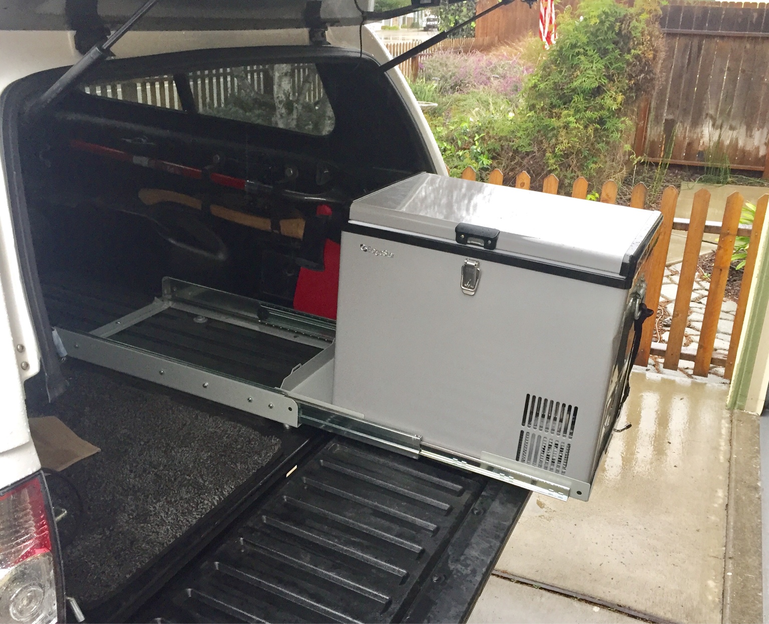

I found a dometic fridge slide on amazon that fit my edgestar fridge with enough room to store a couple 1 gallon water jugs and a few other things. I’m thinking about building a cabinet to surround it with storage above it to maximize useful space since I want to keep the rest of the bed open.

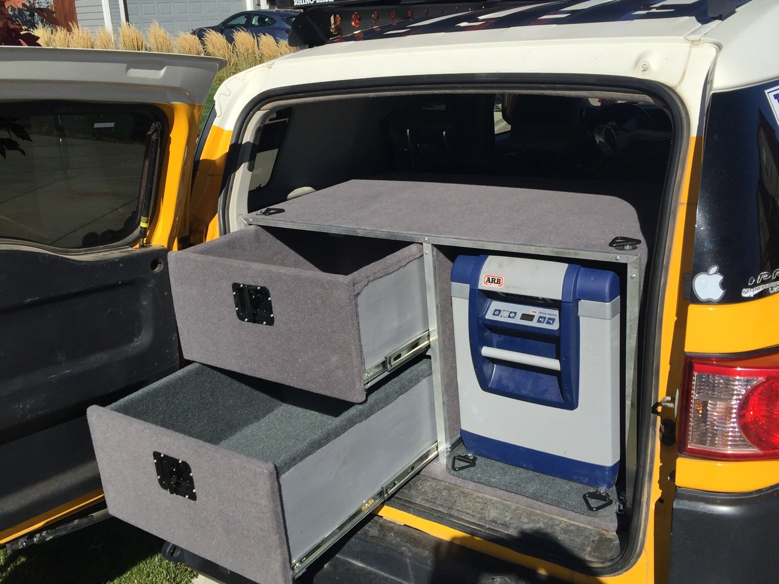

Okay so here's the current progress on my first prototype. I opted for one large drawer (which i cut a small hole into to access my power outlet) that I'm thinking of adding some organizing dividers into, with a slide out 26 inch "table" up top that I topped with a durable linoleum kind of material, and I braced it so stays level when fully extended so i can run my camp stove on it. I kept the left side open for storing backpacks, muddy shoes and stuff, that also fits my small fold up camp table, and carpeted every surface so there isn't visible wood, metal etc except on the sides of the drawers. There's also a small gap behind the box that I built in small space intentionally for putting valuables and such out of sight that can be accessed by folding the back seats down. I'm starting to weld up t track rails for keeping an ice chest in place up top, and adding some D rings for a cargo net/tie downs etc. once I have it topped with a rubberized mat. Next comes handles after I find ones with the right look. Just got back from a trip out to Fordyce trail with it loaded up, and it held up well on the rocks and stuff with no rattling around. drawer.JPG drawer 2.JPG
