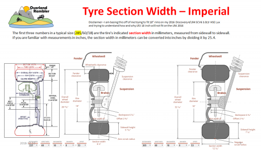

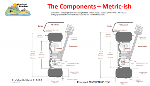

All,
I have put this together as I was having issues with tyre and wheel sizes for the Land Rover LR4 and couldn't understand why the LR3 18" ET53 couldn't fit my LR4 when the 19" ET53 wheel is the same size offset. Well after all of this I understand more about offset and the wheels but i still can not understand why the LR3 ET53 can not fit the LR4. What i need is the picture of the wheel stamp markings on the back of the wheel to understand more.
However the LR4 Lift kit from Johnsonrods will allow me to lift the vehicle and allow me to fit 18" PD1881 IN OFFSET - ET44 TO SUIT THE LR 4 DISCOVERY and from what I see in the chart I will not have to do any modifications.
View attachment 79093 View attachment 79094 View attachment 79095 View attachment 79096 View attachment 79097 View attachment 79098 View attachment 79099 View attachment 79100 View attachment 79101 View attachment 79102 View attachment 79103 View attachment 79104 View attachment 79105 View attachment 79106 View attachment 79107 View attachment 79108 View attachment 79109 View attachment 79110 View attachment 79111 View attachment 79112
Is it possible to get some feedback.
