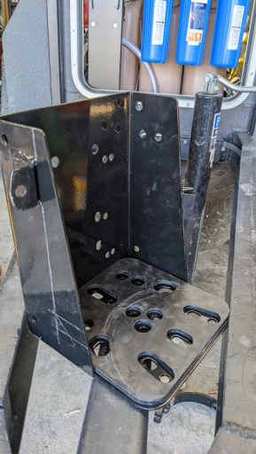

The Kiddie 20lb fire extinguisher mount has been used for mounting small propane tanks. I was hopeful my new Flameking 11lb tank would fit snugly in the Kiddie mount. Unfortunately, the Flameking tank is a bit porkier than others on the market and did not fir the Kiddie fire extinguisher mount. I decided to modify the Kiddie mount to fit my propane tank.

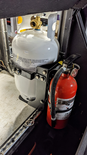

My initial plan was to mount the tank on the outside of the trailer. After all, this is how most off road trailer propane tank mounts are implemented. I was unable to find a spot on the outside of the trailer I liked due to road grime, security and space. I turned my attention to the cargo area and found a great solution that protects the tank from road grime, mounts to the frame and is out of site from folks with sticky fingers.
I also mounted a 5lb ABC fire extinguisher in an easy to reach location. The propane tank mount worked great as a base for this.

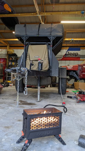

The trailer has never been able to be used without being hitched to the vehicle. This is generally not a problem, but has caused some annoyances when camping at the same place for a few days. I talked with my engineer friend about my conundrum and he suggested a simple single jack fit into the rear receiver. I cobbled together a support made up of a jack, my old pintle hitch mount and pipe clamps.
When used in conjunction with the front jack, the trailer is extremely stable when unhitched from the vehicle.
