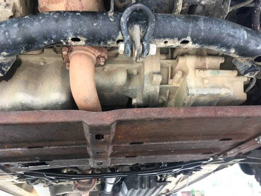

I finally got around to starting my skid plate protect. I started this project with an old fuel tank skid plate that I found at a junk yard for $30. (I think it was an f250 skid plate) As long as you can find a skid plate longer than the subframe bellow the Pilot you basically just cut to fit and bolt it up. On the passenger side I drilled a 1/2 hole through the subframe's 2 existing holes. On the driver side I used a u-bolt through two of the big holes in the subframe. I made sure to cut a rectangle out in the right place so I can change the oil without removing the plate. All of the bolts are secured with split washers to prevent them rattling loose. My next phase will be to create a front portion so the plate slides up and over terrain. It is a little crude, but it is better than nothing.
View attachment 74228 View attachment 74229
Great idea. I will be looking at my local u pull it![emoji106]

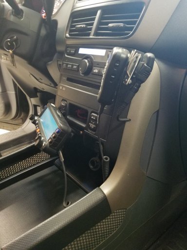

In the spirit of some give-back...Anybody interested in mounting radios (ham, CB, etc) in their Pilots? I attached a snap of my install. I used a product for mounting the speaker/mic that I've not seen mentioned in the Pilot world so far: Panavise InDash Mount #75117-903. I thought maybe some of you might find it interesting.
-Mike
