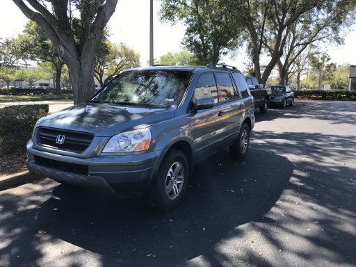

Hello All,
I am starting to work on my 2005 Honda Pilot. There are not too many builds that I have found online so I thought I would post mine here. It is a work in progress and I will update as I add to the rig.
I purchased the Pilot from my mother who bought it new and I know all the maint. was kept up and could not pass on buying it. It has the VTM-4 system and I look forward to seeing what it can actually do. I have owned a few Hondas and know they will run forever if you take care of them.
I started by upgrading to Firestone Destination AT tires in the same stock size as it will be some time before I lift it. (there is only one lift kit I have found) I also installed a hitch receiver and roof rack rails and basket.
One of the next things will be to fabricate a skid plate as there is no protection to the engine/transmission at all. I also plan to get a full size spare and then a rear tire carrier from Wilco Offroad (Hitchgate Solo).

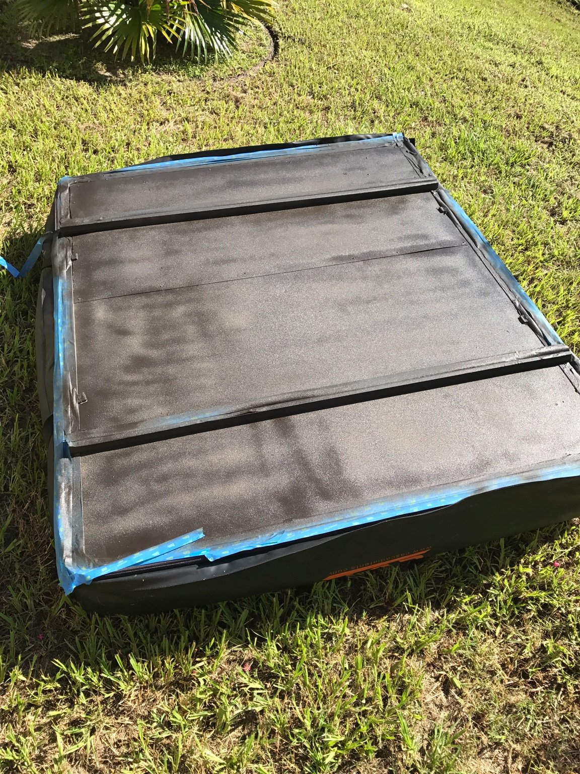

I do have some projects to make the rack sealed better to prevent rust that I will be posting as I get them done.IMG_0609.JPG IMG_0610.JPG

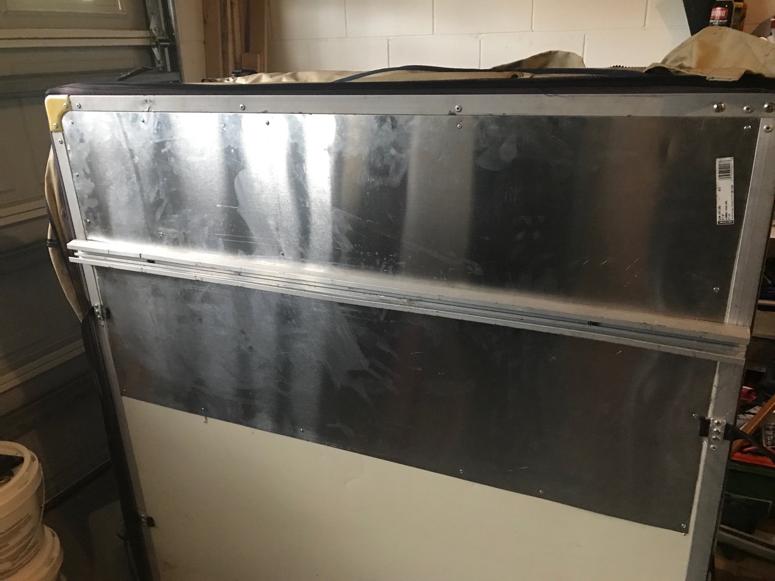

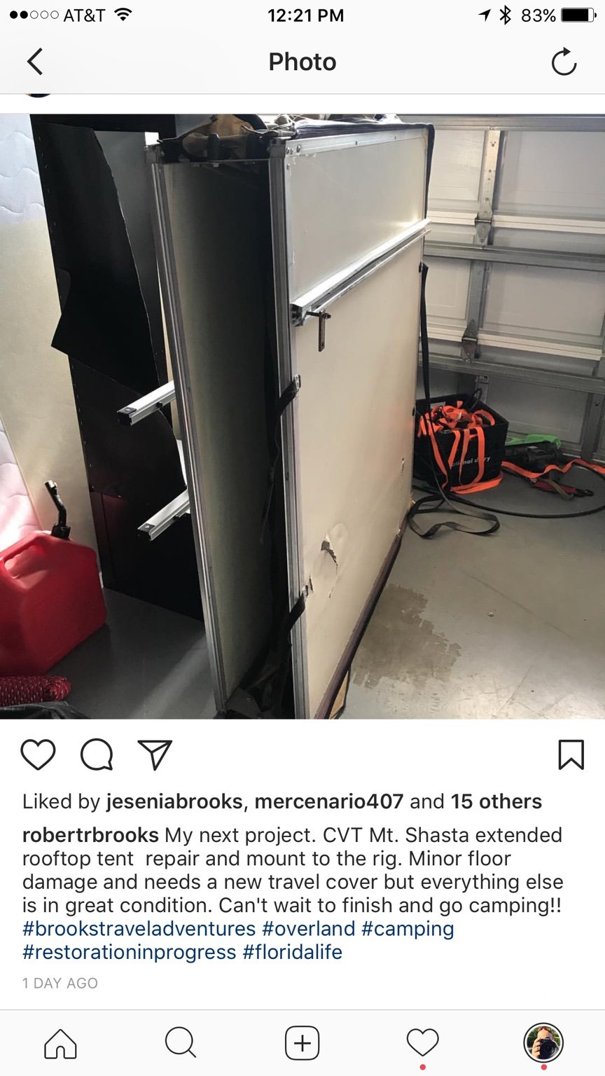

It has been a while as I have been busy but finally making some changes. Just picked up a CVT Mt Shasta extended for $350.00. Needed some work and mounting hardware as well as a new travel cover. Fixed the floor as the last owner hit a branch but it is coming along. I will post more once it is mounted.

I found the tent on offer up. The guy was asking $500 and when I went to see it he showed me the hole in the floor. Also, he was missing the mounting hardware, rods for windows, and the travel cover needed to be replaced. I wound up getting it for $350. and have put about $250 into it. The floor just had damage to the shell of it and I just sealed it up with sheet aluminum. The structure was good. The only thing I had any trouble with is the mounting hardware as everyone has them back ordered. I did order a set but have found a solution by making my own out of aluminum. going to try to mount it tomorrow to see how if it will work. I will post pics then.

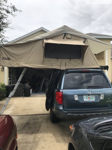

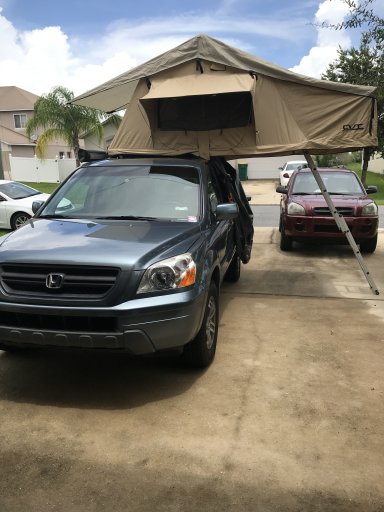

Ok so I got the tent up and all the new parts are here. The breakdown is as follows:
Used CVT Mt Shasta Extended that needed work. There was a hole in the floor from the last owner hitting a branch. He also did not have the rods to hold up the window flaps and the travel cover was ripped. He also did not have the mounting hardware.
The biggest issue was the mounting hardware as everyone has them back ordered. I did order a set but found a solution by making my own brackets. Here is an Instagram video showing what I came up with.
In total, I am happy with the setup and can't wait to take it out next weekend!!
Breakdown of cost:
tent $350.00
Aluminum and rivets $80
Rods $30
Travel Cover $150
Material for Brackets $20
So total for the tent is about $630. Not too bad considering the Price for a new one.
Not sure what the next project will be yet. Looking between 2in lift, rear tire carrier, or front hitch for better recovery point in front.
