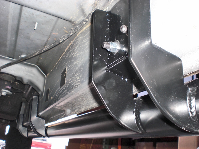

Sliders are going on very soon. Decided to go with Aluminess. They are local and was told at the shop that they are frame mounted like the white knuckle sliders.

I'd double check on that dude, the photos on their site show them body-mounted.
"They bolt right on to factory mounts and provide great protection to your rocker panels."
http://www.aluminess.com/dodge/dodge-power-wagon-trucks-2010-2013/sliders/
When I had looked at Aluminess a while back they were all body mounted. I would also suggest a steel slider over aluminum. The aluminum is "sticky" and does not slide over things as easily as the steel will.
Their sliders are made of steel, I asked about this when I was shopping around but they have it mentioned on their site now.

They are the only steel product they offer. I specifically asked the sales rep at the shop about what I saw online regarding the body mount and he told me they are frame mounted. I might ask again to be certain.

I've been told the factory offered Mopar sliders were frame mounted.
