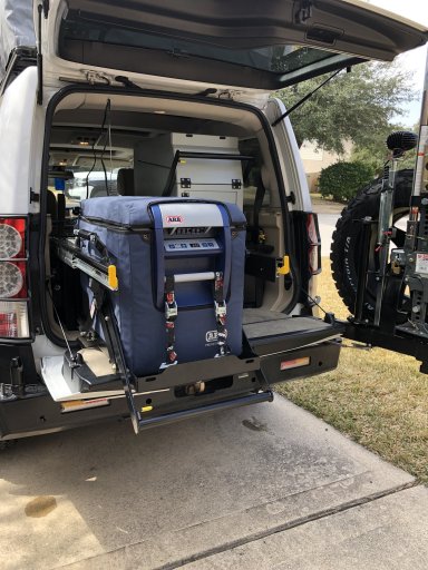

It’s the Clearview Easy Slide. They offer a straight slide and a drop down slide. I have the drop down since the fridge is on top of my drawer box. Purchased it from Atlantic British (www.RoverParts.com).

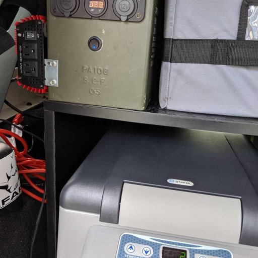

Yeah with solar...i was out for a fishing trip for 3 days and the fridge never stop and the battery was top few minutes after the morning Sun.(using a 90w solar panel on the top of the jku?
Easy set up without overthinking i like it!
...ive been racking my brain, since theres so many options, mostly overkill. After speaking with Jason from @SwellRunner, he uses a 100w panel and 1 agm battery for fridge and starting the rig..hes been using that system for over a year with fridge in the rig full time. I just bought a fridge made by Costway..all good reviews. I paid $339.00. I plugged this into an older 12v battery i had sitting around saturday 5pm..voltage was at 12.9 now today monday morning voltage at12.3. Im convinced i can get away with 100 solar panel and 1 agm battery for my particular use. Good luck20190624_073546.jpeg20190624_073552.jpeg
