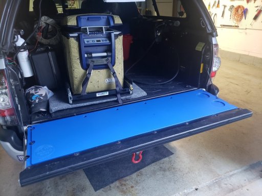

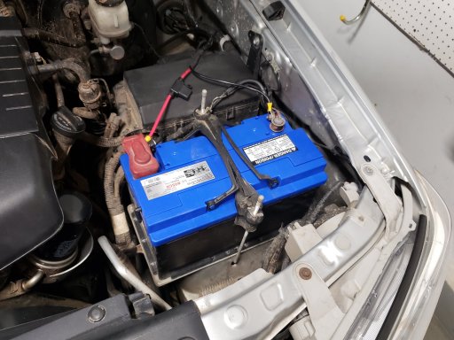

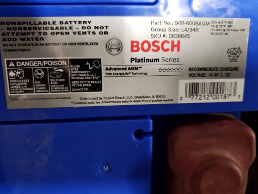

I run my fridge off an 80AH Bosch AGM 94R battery. No dual battery or power packs here.
I don't think your system would work for me. When I camp out it may be for up to 14 days without starting or driving my car. I'm not a weekender that only needs elect. for a couple of days. My solar and back up gen are necessary for my needs. I want to be basically a mobile off grid system. If I'm remote enough I may even leave my Travel trailer for a few days for a short visit to someone, the grocery store or pharmacy. Your set up would be fine for your needs as I see it. Thank you for your input. Lanlubber
