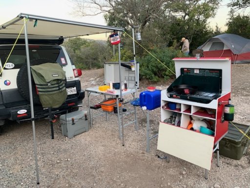

Used the REI plans to build the kitchen box. We keep our coleman stove, spices, plates and utensils, coffee pot, 2 cast iron skillets, steel comal, collapsible sink, 2 bowls, paper towels, and odd stuff like spare batteries, etc in it. Never weighted it, but I'd guess it's pushing 75-80#

I like it but I couldn't lift it. Reminds me of the chuck box we had in the scouts that was always ready and never failed us.

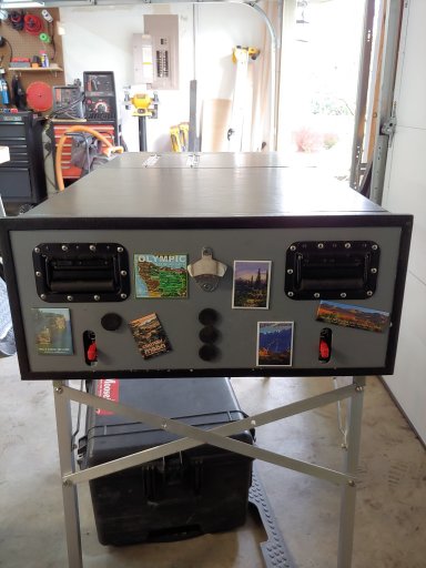

This is our kitchen box we built. Its integrated into a storage system in our truck bed, below a drawer under our sleeping platform. There are rollers on the bottom and usually we just pull it out on the tailgate and cook right there, with a table we set up when we need it. Its pretty heavy when loaded up, so we don't set it up on the legs often unless we are parked for a few days at least. There is a cutting board that slides out under the stove and a leg we can attach on the bottom so it doesn't tip off the tailgate. The back portion has the extra hinged top so it can be opened while on the tailgate without moving our sleeping platform.

Can you explain Kitchen3 pix. looks like you might have some electrical there for battery-solar power ?

Pic 3 is of the front. So two big handles, bottle opener in the center & magnets below to catch bottle caps. We have a plug in the rear bumper for extra power (coffee grinder, the like) that draws from two extra batteries mounted in the truck bed. No solar on the truck at the moment, maybe in the future....

Do you have a sketch with some dimensions so that I can get a better feel for the size. Looks like the top is made from 2x material.

Sadly no sketch. My husband does lots of this design work in his head honestly. Its (roughly) 26" wide, 14" tall, & 4' long when its all buttoned up. The stove pulled out makes it longer at that point. Fits the Coleman 2 burner and our pots. The front face is steel since its by the cooking area and the rest is 1/2" birch plywood. We used oak for some of the more technical pieces and dividers because thats what was readily available when we were making it. Its stained and sealed up with 4 coats of spar so water just beads right off the surface.

It looks very well made. Thank you for the info. Hubby is quite a craftsman.
