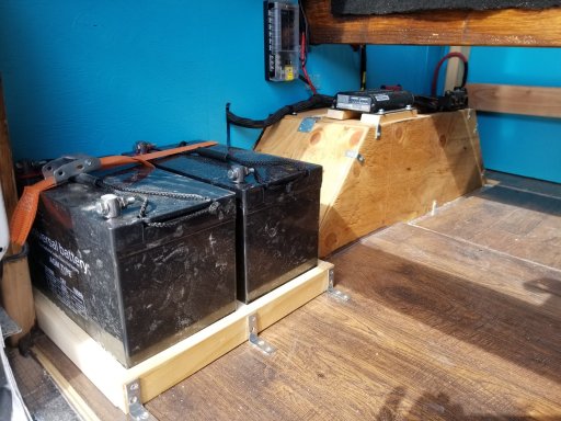

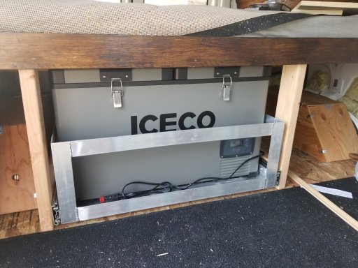

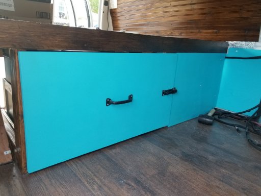

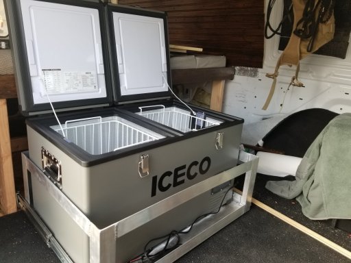

Got more done! Built the fridge slider and stuck the fridge in. Still need to box in the front, but that depends on building the counter...everything seems to depend on everything else:grinning:.
Got my 4X4 conversion scheduled for June...20210307_155006[1101].jpg20210307_154936[1099].jpg

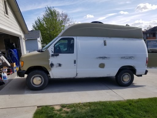

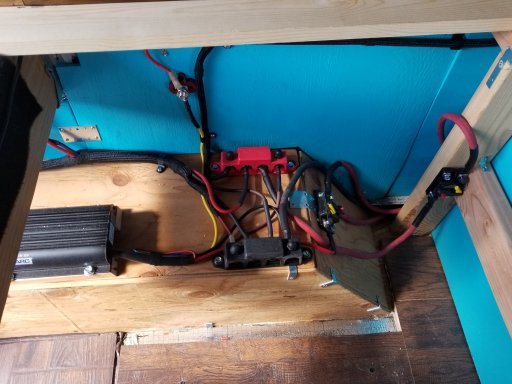

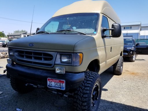

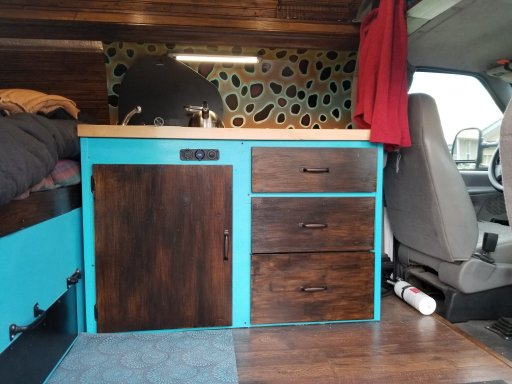

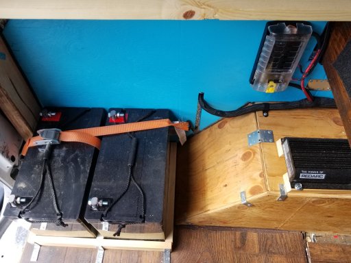

Another update:
Fridge cabinet/latches built.
Electrics run and wired in, except...I need more cable to make the battery cables (dammit!).
And now it's calico, working on the liner stuff paint job. Got the top (pain in the butt), front clip, and back doors done, and everything else scuffed waiting for weather.
Going to get hectic, I have lots of NG stuff this month and it's going to Oregon the 1st for the 4X swap.

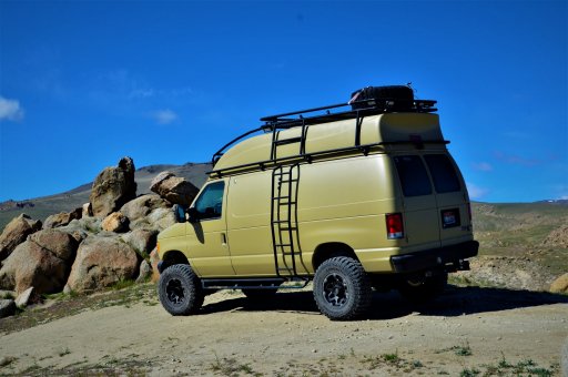

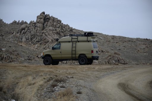

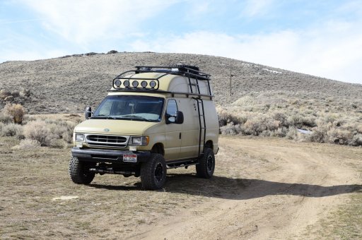

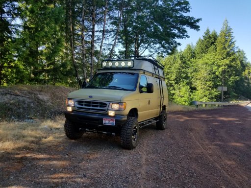

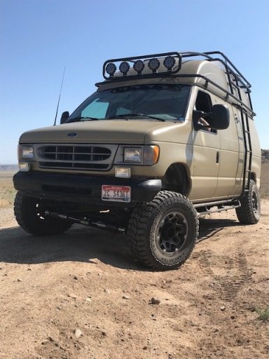

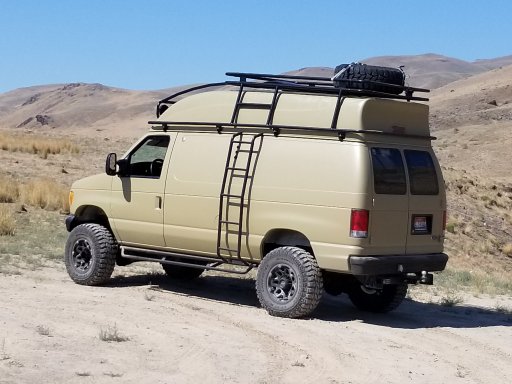

So, here's the rack, etc. Drove it about 550 miles home, no problems.
Felt a little squirrely at first, but a tire pressure adjustment calmed it right down.
8500 pounds all in, right at 10' at the top of the rack.
That looks great! I did a caster correction to help my squirreliness after the lift. Helped a ton!
What an amazing rig. Congrats dude!

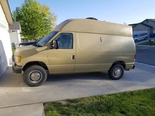

what did you use for the tan finish? Did you do it in the driveway or rig a spray booth?
loper
Monstaliner bed liner-type paint. Did it in the driveway. The manufacturer's (monstaliner) website recommends rolling it on with textured rollers, more than spraying.
Monstaliner has a lot of color choices, pretty easy to work with, BUT: the fumes will wreck you (even outside) and of course the prep work is critical.
