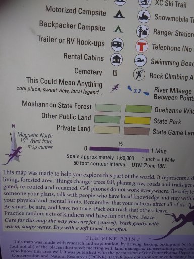

You will want to find this info on your map. The variation of magnetic north is shown in the bottom left corner here.
When orienteering it is also very important to make sure you are in the exact starting spot.
Using triangulation to find your location on the map is another thing to learn. If you can see 2 objects from the map you will get close
