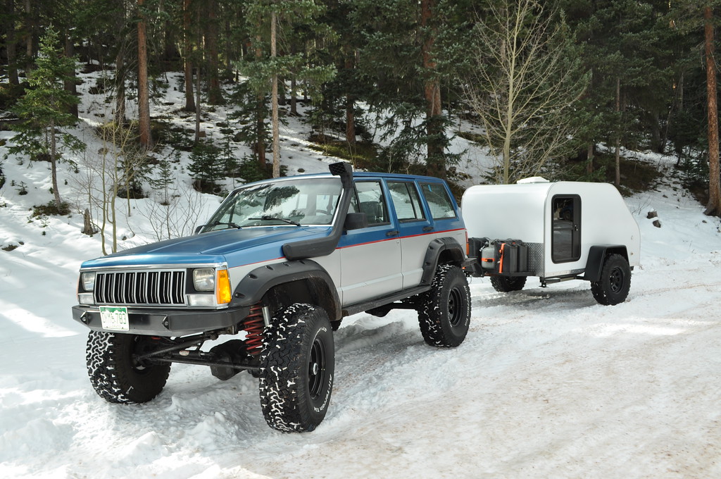

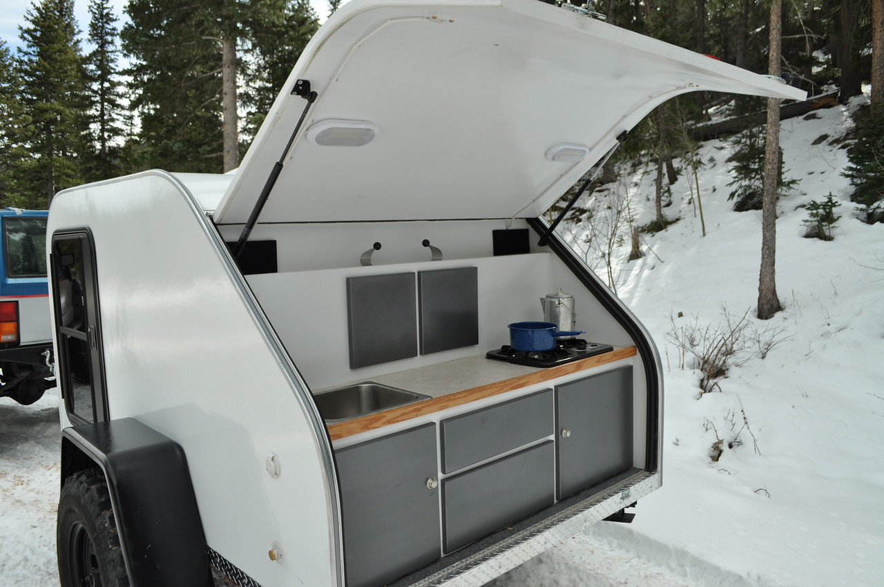

Here is a pix today near home at Camp Dick, Colorado. Elevation 8753 ft. I made a pot of Hazelnut coffee and some hot soup. I am working on a polished diamond plate backing behind and to the side of the stove to keep thing clean. I am also making the mounts for the propane grill so it will mount on the side of the trailer.
