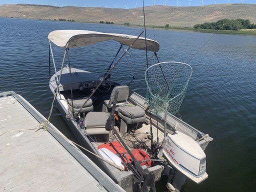

I just meant I have no brakes on the boat trailer, and when I do put brakes on they are going to be surge brakes... but yes the controller will be nice for when I build my adventure trailer.

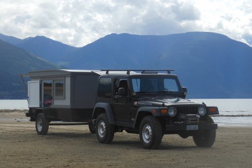

For the past 10 years I've towed a 2000# trailer full of tools behind my TJR without trailer brakes.... about 10K miles a year, summer and winter. Never had an issue, even at deer crossings. But I come down steep, slippery grades every winter and am darn glad there are NO brakes on the trailer. I know it would end up passing me. It is all about judgement and looking far enough down the road.
So 3 trailers, all under 2000# and I'll never put on trailer brakes. In BC trailer brakes are required at 2950#. When trailer brakes are required on a tandem trailer I've only put them on the lead axle so the rear axle will track and keep things straight.
That's a very light trailer for surge brakes, why surge brakes instead of electric?

Because Surge brakes don’t heat up as much as electric brakes, surge brakes are legal in Oregon, where as Electric Brakes on boat trailers under x feet require special Marine Grade Brakes, and my tongue is already set up for surge brakes, just need to put the drums and plumbing in... the PO started to rebuild the trailer and never finished.

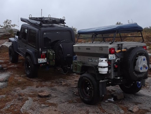

This is my overlanding rig. 1500# fully loaded.
I use my trailer brakes off road all the time, they work well to hold me in place when I'm sitting for a few seconds or help slow me down on a steep grade (yes I gear down). I don't go fast off road but I also drive on roads where people do stupid things driving around me so I like the extra braking power.

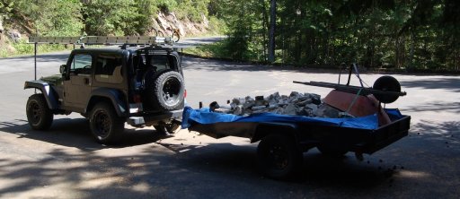

Picture a light Harbor Freight trailer with two small ATVs being pulled by a 1990 Toyota PU with a fiberglass shell on the back. Now do a panic stop at 45 mph and have that very light trailer combo, jack knife you.

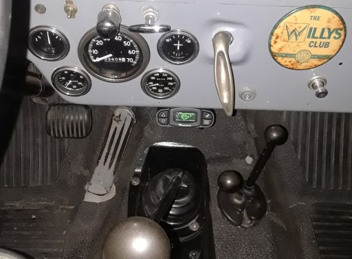

This is the brake controller I'm using with my little trailer - a Tekonsha Prodigy P3. I have three vehicles wired for using this brake controller (96 Dodge Ram 1500 4x4, 98 Jeep TJ, and 46 Willys CJ2A):
I just move it from vehicle to vehicle. It isn't the cheapest brake controller, but I like it, and it has worked well for me over the last few years. I can dial up-or-down the amount of braking it applies to the trailer, and there's a lever on it I can go to max as soon as I move it.willys and trailer.3 (2).jpgOverland Adventure.2.jpg
