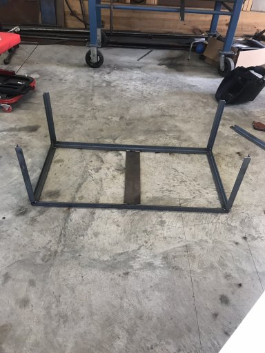

This is at my friends shop and it’s a rock buggy that he’s building. He’s a dirt track racer but building the rock buggy for him and his boys.nice trailer but how about a little more info on the buggy in the back of the shop !!!!

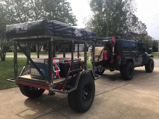

Jose thanks for the post. I am currently building a teardrop for the family but have the same trailer sitting. I want to say thank you for the motivation to build a new trailer for just me & mama. What axle did you use & where did you get it from thank you for your motivation & not to copy your build I am going to. Any info would be greatly appreciated & love the kids helping with the build
Awesome thanks so much for the info & good luck with your build looking very niceHey brother thanks for the kind words!!! Also any questions you have just ask and I’ll try to answer them for you or get you the answer. Lol. As for the axle I bought it from dinoot trailers.com it’s the 3500lb axle with break flange. My trailer is 48” wide and I’m running the 17x9 pro comp steelie wheels with a 4.25 backspacing. So with those numbers and measurements I ended up with a length of 65” hub face to hub face for the axle. Hope this helps and you can copy away all you want brotha!!

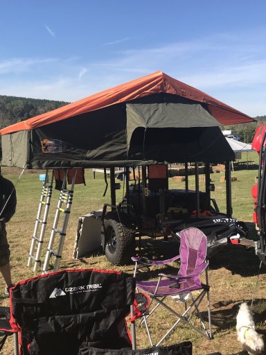

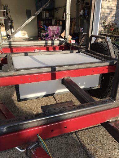

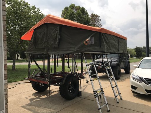

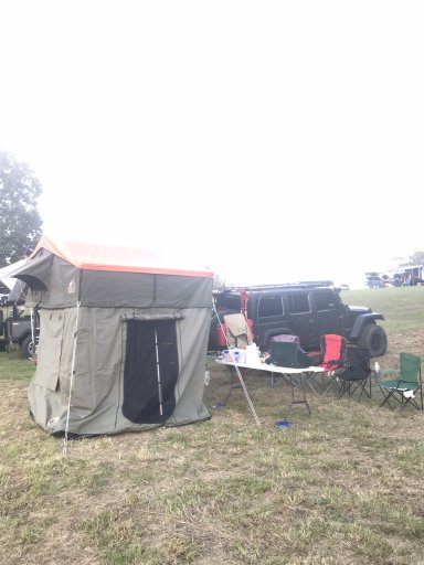

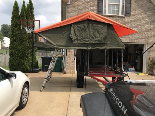

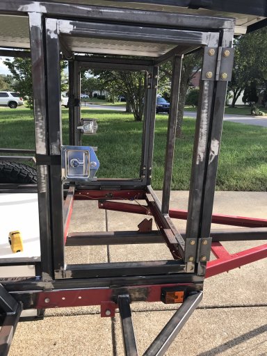

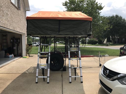

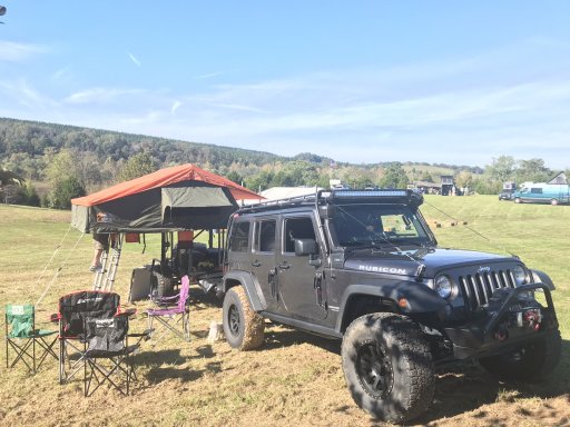

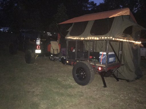

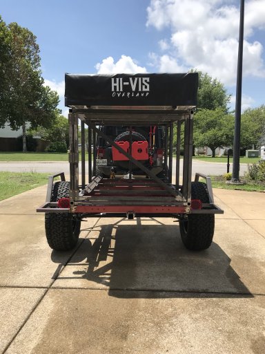

Been a while since I posted on here cause of issues I was having with the OB App. But here’s a little update on the trailer with the 3rd door done which is the right side, brush guards the start of the fenders, and finally got my Crag4+ person RTT mounted on the trailer for now until I skin it up in aluminum and build a roof rack for it. I’m hoping to have it all skinned up and ready for the Blueridge Overland Roof top tent rally in late October. Until then I’ll keep posting up updated pics of the progress.
So, the metal framing is slightly lower in the front? I assume you level the RTT for sleeping using the drop leg if that is in fact the case.
[/QUOTE]Yeah the trailer jack up front wasn’t leveled all the way up as I just took the trailer out the garage to just open up and season the RTT. The trailer jack still has another 5” to go up to lock in place and with the c-jacks in the rear the trailer is stable and won’t move around.
I just checked out the Hi Vis tents and didn’t see the one with the double ladder...which model do you have?
AWESOME BUILD! I’ve been back n forth on building one myself(lacking a welder) 1 question? What size HF trailer did you use?

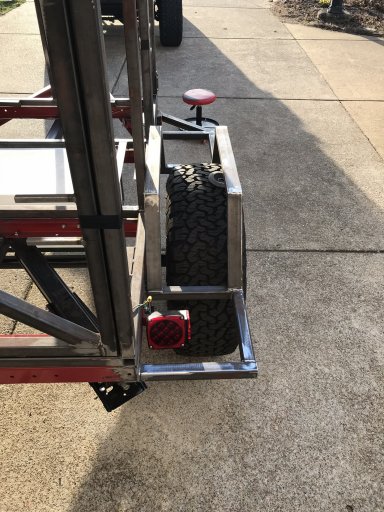

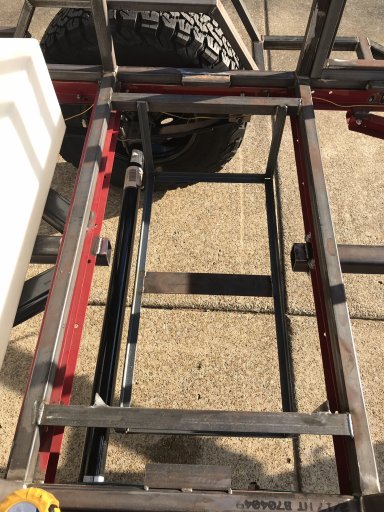

Awesome. Been looking for a good fender frame visual for mine. Looking great.
