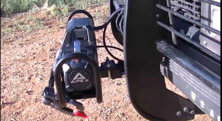

BTW, just bought a new Badlands Apex 12000lb winch with hitch mount that I will be installing in the next couple of days. If you look at the photo above you can see that I put a new front mount hitch receiver under the front bumper and grill protector.Hyde 2 08-12-2020.jpgHyde 3 08-12-2020.jpgHyde 4 08-12-2020.jpg (Oh, and in case you haven't figured it out, this is the 4wd version)

Just mounted the new Badlands Apex 12000lbs winch on a haulmaster hitch mount to the front hitch receiver. The leads are hanging, as I am still waiting for the quick disconnect plugs that will allow me to remove the winch without having to unwire it. You can also see, on the video below, the new off road leds in the grill, on the front, side and rear rack. I saw a lot of videos that showed the haulmaster mount wobbling all over the place, with a lot of negative responses regarding the wobble. I found that by using a hitch stabilizer clamp that wobble completely disappears. Due to the shortness of the hitch receiver (barely comes out past the bumper) I had to use a 7" extension with a second hitch stabilizer clamp. The combination works well and has no wobble or slip. winch 1.pngwinch 2.pngwinch 4.pngwinch 3.pnglights 2.pnglights 1.pnglights 3.pngSnapshot 1 (8-16-2020 8-40 AM).png
