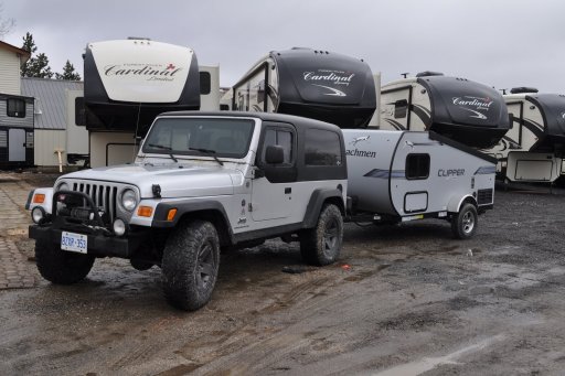

I have a Forest River product too, a Coachmen Clipper Express 9.0td, and I use it in the exact same way as Grubworm ... get us and our "stuff" to a campground and use it as a base camp to go exploring from. The frames are light duty but not bad and there's a lot you can do to beef them up, and I have. The bodies are a different matter. I've built and modified trailers and have built several cars for off road racing. I enjoy fabrication and restoration, am well equipped and have been doing it for decades ... and I'm OLD.
A lot comes down to what's right at any particular time and what alternatives you have. For many of us our spouse's priorities and preferences enter in to the equation. Mine does not have the patience I do when it comes to building things and I'm not surprised by that. I prepared many sketches, material lists, etc. for a tear drop build and my wife showed little interest in the project for the simple fact that she wouldn't be able to stand up in it. The Clipper solved that problem and my thinking was/is that if we liked it I could build a much more rugged duplicate and still have the original to use in the meantime.
If you guys want a bit of a laugh, go on the Forest River Forums. Ours is a different world to many of theirs, and again, fair enough. I started up with a general interest because I have one of their products and found some of these guys even argue over their pick-up trucks. They don't seem to like Jeeps Gladiators btw. Anyone Towing with a Gladiator? - Forest River Forums
We're well into the 4th year of using our Forest River based trailer. If anything, it's a lot wimpier than the NoBo and similar trailers because it's a pop up. I call it a "tear pop". Internally the side to side bulk head structure goes back to the foot of the bed and then is taken over by the cabinetry. That's OK but not great. There is no end to end roof for a box like structure. I've reinforced the frame from side to side and done some triangulation and in some areas from end to end but it is still NOT and NEVER WILL BE a good off road trailer.. I've taken it down many gravel and dirt roads and off road trails and it has held up well. I don't abuse it though.
It came with things we didn't need. I removed the fridge and AC (-72 lbs.) and the heater is next. I get it that they are good to have in some geographic areas and no doubt they are good for marketing. My wife ate that stuff up while I knew I'd be able to convince her that they were useless and the added space would be better.
Overall we're happy with it. In my original post above I said I might use it as a template for a more rugged build but unless it falls apart I don't see that happening.
This is what it looked like when I picked it up and then about a year ago. I've done more to it since then and, like many things it will never be done ... which is a good thing.

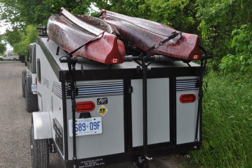

With 7' head room at the rear end, I could put my wife on my shoulders and we could do do all kinds of "bad ass" crazy things in there! :laughing: If only we were younger. Changing inside was the main thing for her and this works really well. What we bought it for though was to haul kayaks. I built racks for it and with the lid down they don't even touch it. There is no wear and tear on the lid at all.
This "her" trailer. I built an off road trailer for "me" and she won't go near it ... which is great. It has an RTT that's only 4' wide and is perfect for 1 not 2. I'm 70 and was concerned about climbing up to it even though it's only at half height and changing clothes inside but I have no problem with it. I like it! Using it for rougher trails and not the "tear pop" will extend the life of her trailer so that's a good thing.
I've totally revamped the rear end but this what it looked like when I first built the kayak rack. Part of it doubles as a stand for the external on demand water heater (mounted on the side) when not used as a rack.
