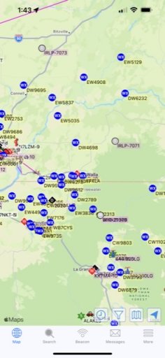

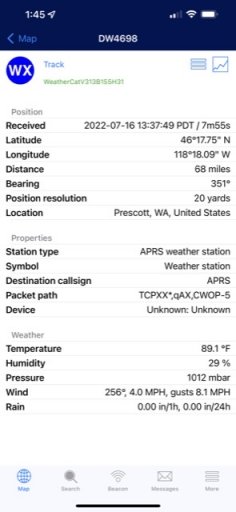

Having APRS can save you from going to the higher tiers, that certainly sounds interesting. And premium weather info (5 day forecast IIRC) is $1/message for all plans. Is there reasonable coverage for getting weather forecasts over APRS?
APRS has full weather coverage… and then there is the weather bands that you can program into your radio to get voice alerts as well…

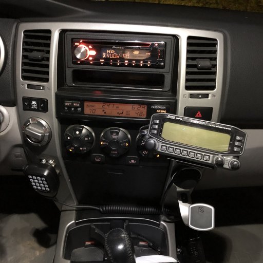

If you're going for a mobile radio, recommend making sure to get one where the head is separate from the main radio unit. There's not much space near the dash in a 4Runner, I used a proclip mount to hold the head of my radio and put the main radio part in the passenger footwell.
Thanks for the link. I’ve been thinking of options to mount the head in my new rig.
I have a couple of write ups on APRS, one of which is how to send SMS Text and Emails (OB Approved - SMS Text and Email via APRS | OVERLAND BOUND COMMUNITY ). In this same thread on reply #7 I also show how to get weather forecast for your current area or even a destination area.
I also have an Intro to APRS thread if you are interested, Intro to APRS | OVERLAND BOUND COMMUNITY .
Because I just see a modern cockpit on the picture: please be careful where you place additional equipment like radios and so on in the cockpit - such things must not interfere with safety and assistance systems. I see from time to time that devices are placed in front of airbags etc. - please don't do that! I can't see it in this picture from the viewing angle, but of course the hazard warning switch must still be easy accessible! This is simply a well-meant hint.
That is a very good point. When airbags go off they are very violent. Anything in front of their path would get launched like a missile.

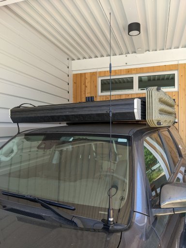

Progress... I got the antenna mounted and the coax cable routed to the inside. We already have cables running from the alternator to the charge controller for our house battery setup, and I could sneak the antenna cable along the same route (driver side thresholds). We have an ICS dash mount, which should allow us to keep all our devices clear of the airbags, and (using ram mounts & joints) also low enough that they don't impede the view through the windscreen. The display will live on the dash mount. We have a large vertical panel behind the front seats that has all our electronics and house battery setup, and fortunately there is still space for the main radio unit. The built-in speaker will be at shoulder height and face the center console, so I don't think we'll need an external speaker. We'll power the radio from the house batteries, through our RedVision system. So, if we wanted to, we could run our radio at camp.

@walkabout_ca if you get a whining sound in your tranciever’s audio, you might look into either rerouting your coax away from the auxiliary battery power cables, or add ferrite beads to the coax, or both. If no hum or high pitched noise is present (both RX and TX) disregard this comment.
Very good point, and in this case the radio is not in the path of any airbag.
