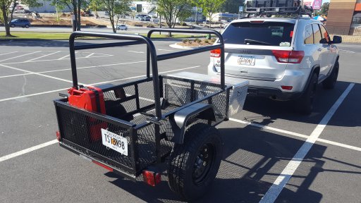

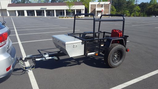

This is exciting! David was able to get my trailer done late Friday night and I got it picked up.
We went a little taller with the bars for 2 reasons.
1. So my kayak will fit under the bars.
And
2. So my coolers and totes will squeeze in under the bars when loading/unloading if/when my tent is mounted.
I'm impressed with the weight balance as well. It's pulling very well.
I had David weld on two new tabs up higher for relocating the tail lights. I stopped at Harbor Freight and bought a set of waterproof LED tail lights. Again, I had a couple reasons:
1. Up higher for better visibility for people behind me.
And
2. Up higher to keep debris from striking the lights.
I'll get those installed hopefully tomorrow and will post up pics later to show the change.

Wow, that's really looking cool! That's going to be so handy to use. I love having a trailer.

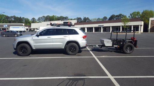

Ok, Tuesday night after work I was able to do a couple more things before I leave Atlanta for Arkansas for the Bonfire Rendezvous Friday morning.
I raised the tail lights up for better visibility and to keep them up higher to clear obstacles and whatnot. I then also added a 1st Aid Kit to the fender. I'm taking my kayak to Arkansas with me, so I added my J Bars to the rack. Hopefully that works out. The kayak normally goes to the top of the rig. Eventually, a nice new RTT will be up there. But this week, my Jackson kayak goes on the trailer.

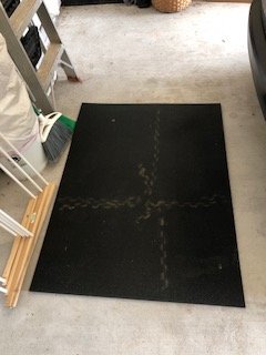

Had a problem with the metal screen wearing holes in gear...chairs, canopy etc., from the vibration. It was like stuff was being sandpapered. Went to Tractor Supply and found Stall Mats. They come in 2 sizes and 2 thicknesses. I got one in 3' x 4', 1/2" thick. It covers most of the floor and on sale now for $22. Problem solved.
