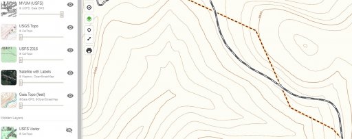

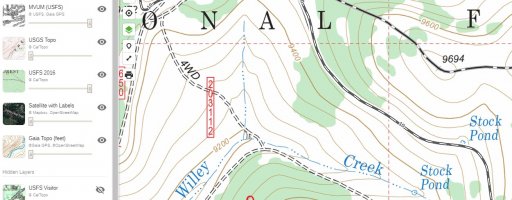

Ok, newbie question. So I'm planning my first day trip to learn a bit and see what is nearby. My question is about legal roads to use. In the first picture below you'll see a Gaia map where I've got two layers active, the Motor Vehicle Use Map and the USFS map. You'll notice a road labeled "4WD" and numbered 203112. When I look at map legend for the USFS map it says the double dashed line is "Unimproved, 4 wheel drive."
Now the next image I have hidden the USFS map layer and you can only see the MVUM. You'll notice that 203112 is gone. Does this mean that 203112 is not legal to drive on? I nabbed the most recent PDF from the USFS and it agrees with what is shown below, that 4WD route is not listed. In fact, there a many, many of these 4WD routes that aren't on the MVUM. Looking on satellite imagery with Google Earth does show a track there and in many locations that aren't on the MVUM. Not wanting to get busted my first time exploring, do I need to stick to the alternating black/white roads marked on the MVUM or can I go on the unimproved roads on the USFS map from CalTopo?

Last time I checked you have to stay on the roads listed on the MVUM or risk a ticket.
That's what it appears to be. When people talk about "finding" camping spots, where are they talking about, as it seems there isn't much to "find" when you know you can camp on either side of whatever road is shown on the MVUM. Maybe I'm confused on how one goes about "overlanding." I want to have the most options for exploring, but obviously don't want to break the law. The MVUM seems to only cover lands within national forest areas - are there types of locations where people go that aren't in such areas that allow driving and camping? Maybe BLM land?
