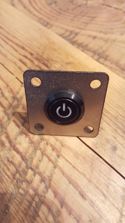

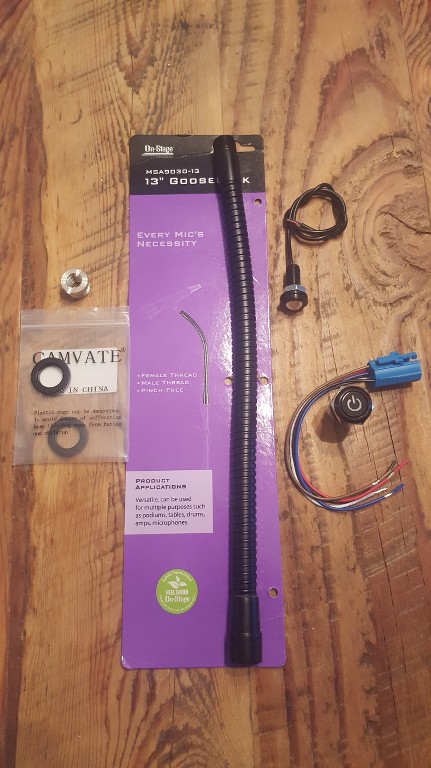

Moving onto the next rear bumper/tire carrier mod. There have been a couple times that some sort of lighting would have been great, and that leads me here. I picked up some microphone stand parts along with some Cat Eye LED's, and a waterproof switch that I plan on mounting to the tire carrier.

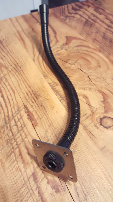

Below are the parts I'm using for the lighting. I'm still waiting for a couple access covers, screws, drill bit, tap, sealant, and hole saw in order to make this work.
Got my access covers cut this morning for the cooking light setup. Tonight I'm going to try to drill the 2 larger holes for the light, and switch. In addition to those I should be able to drill, and tap the additional 8 holes to secure the access covers. Then I should be able to powder coat the covers tomorrow, and put everything today before this weekend.

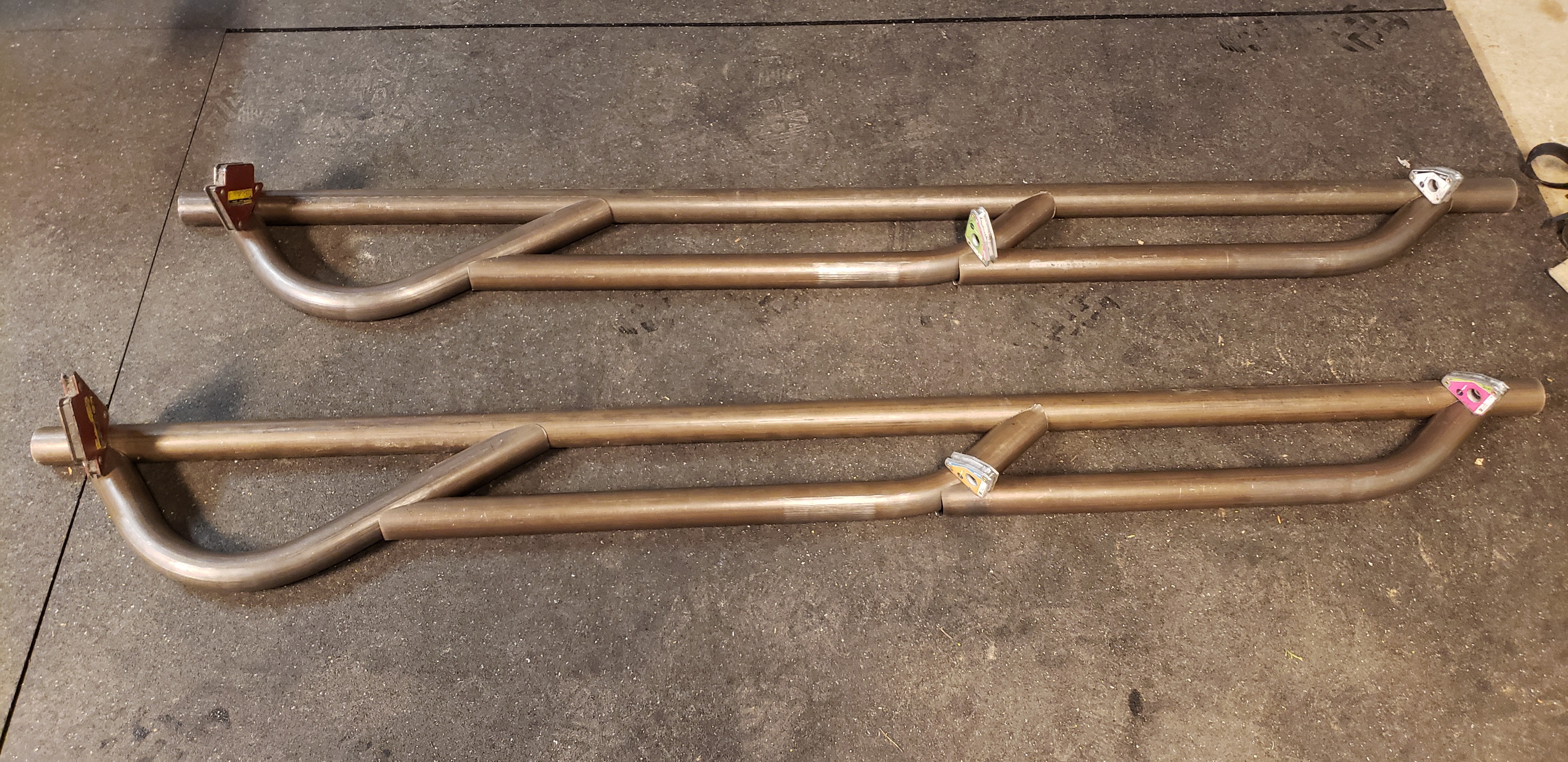

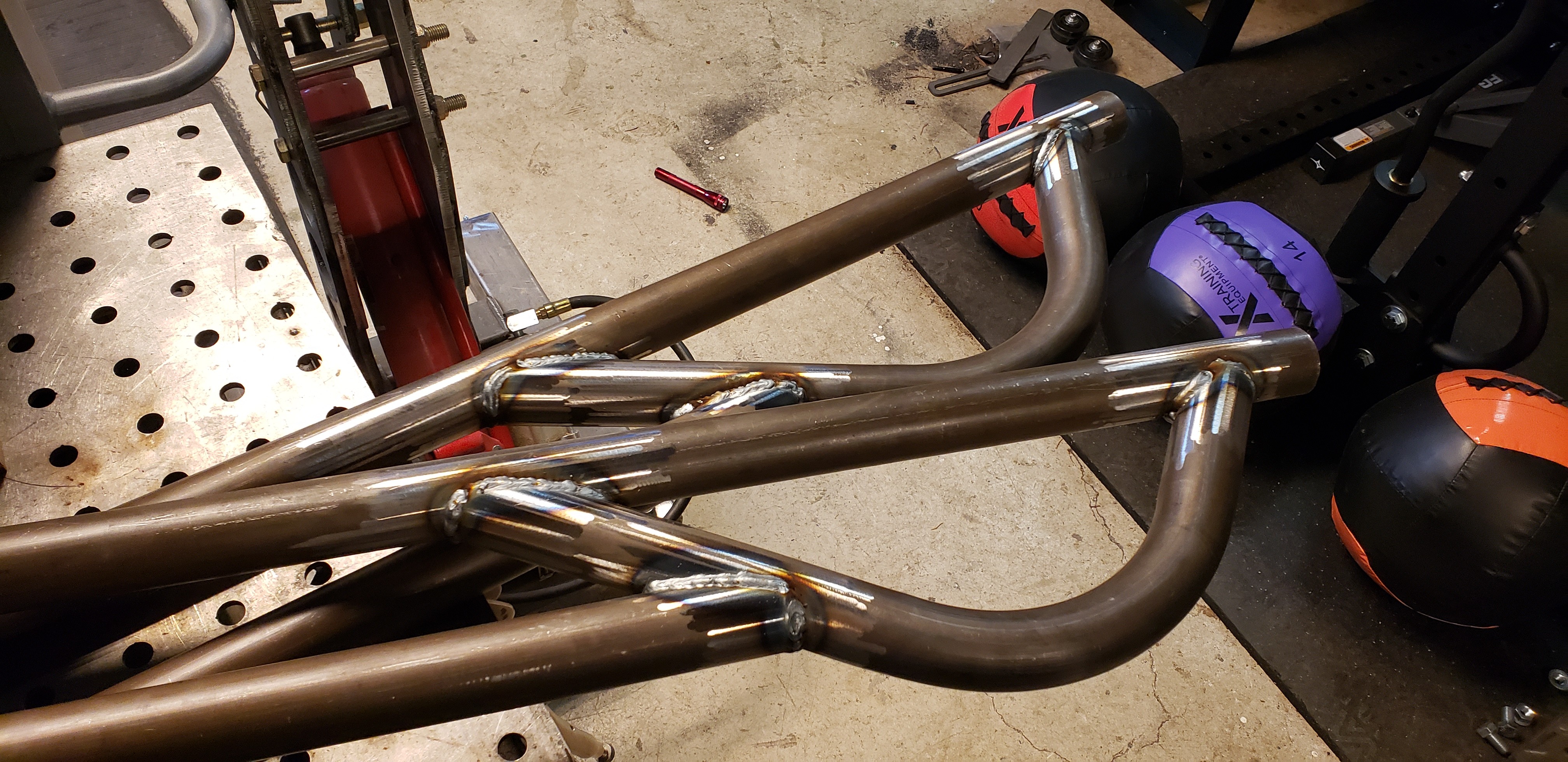

Over the weekend I completed one of the last items that I've wanted my 4runner to have. I built some slider from 1-3/4" x .120 DOM that are 68" in total length. The have kick-outs, two bend legs per slider, and I just dropped them off to get powder coated. Powder coat is not the best option for sliders due to the cost involved, but it's only going to cost me $10 for this and that's worth it.
