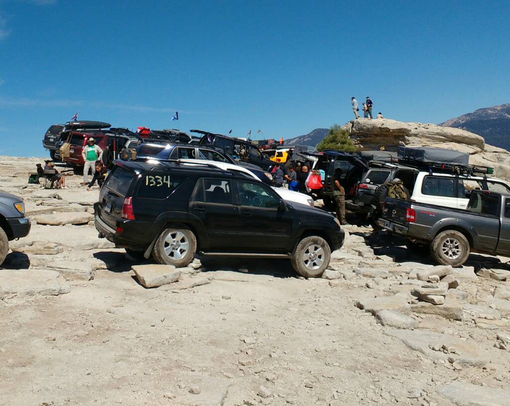

I've done the Bald Mountain trail in my stock 4RUNNER and had no problems going up the mountain. I did need some spotting on a couple of the gates. Going down the trail, I bottomed out at the last gate and I bent both my running board's (Driver error). After that trip, I went out and got a 2.5" lift. I say keep the stock suspension until you decide it's time to get it lifted.
