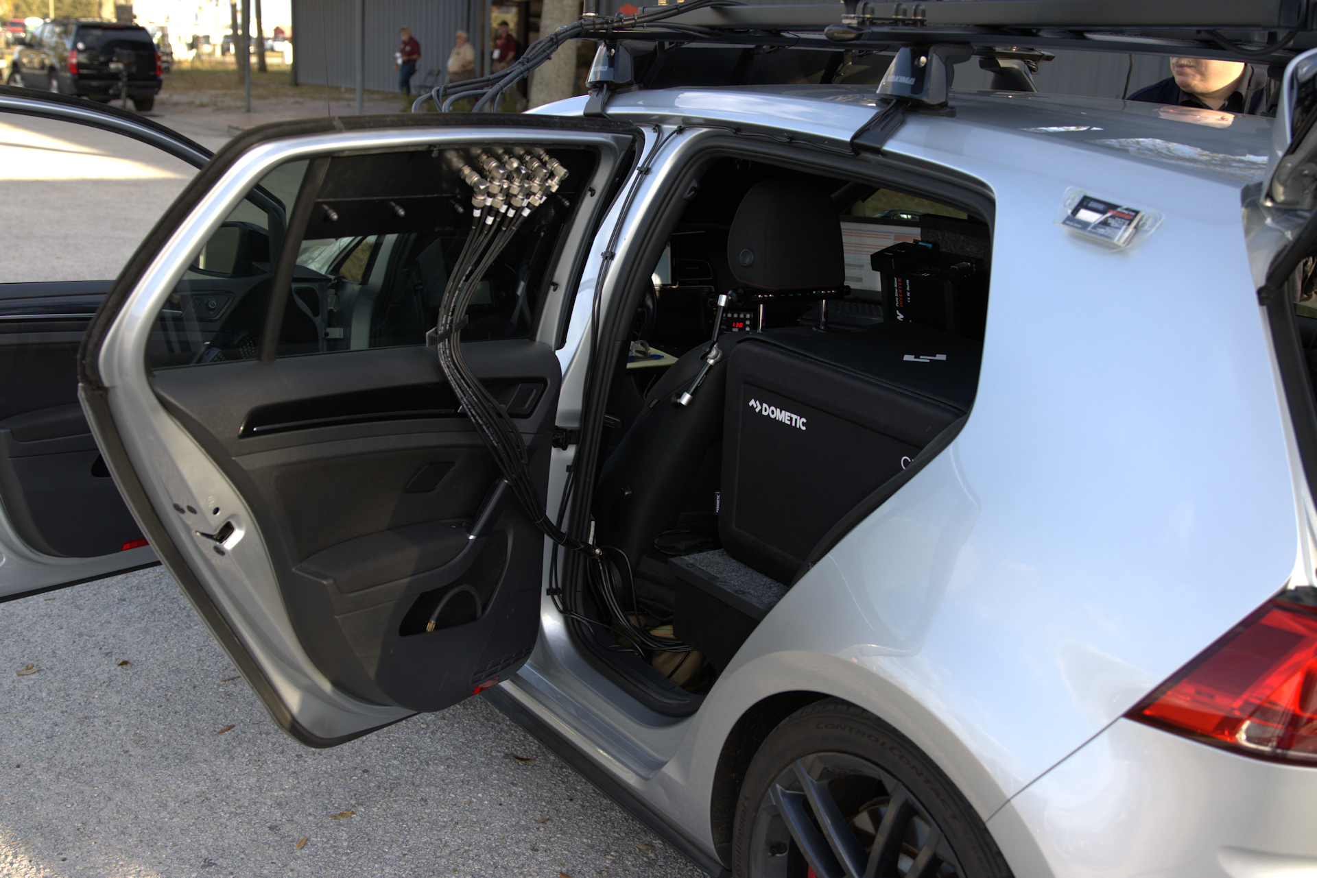

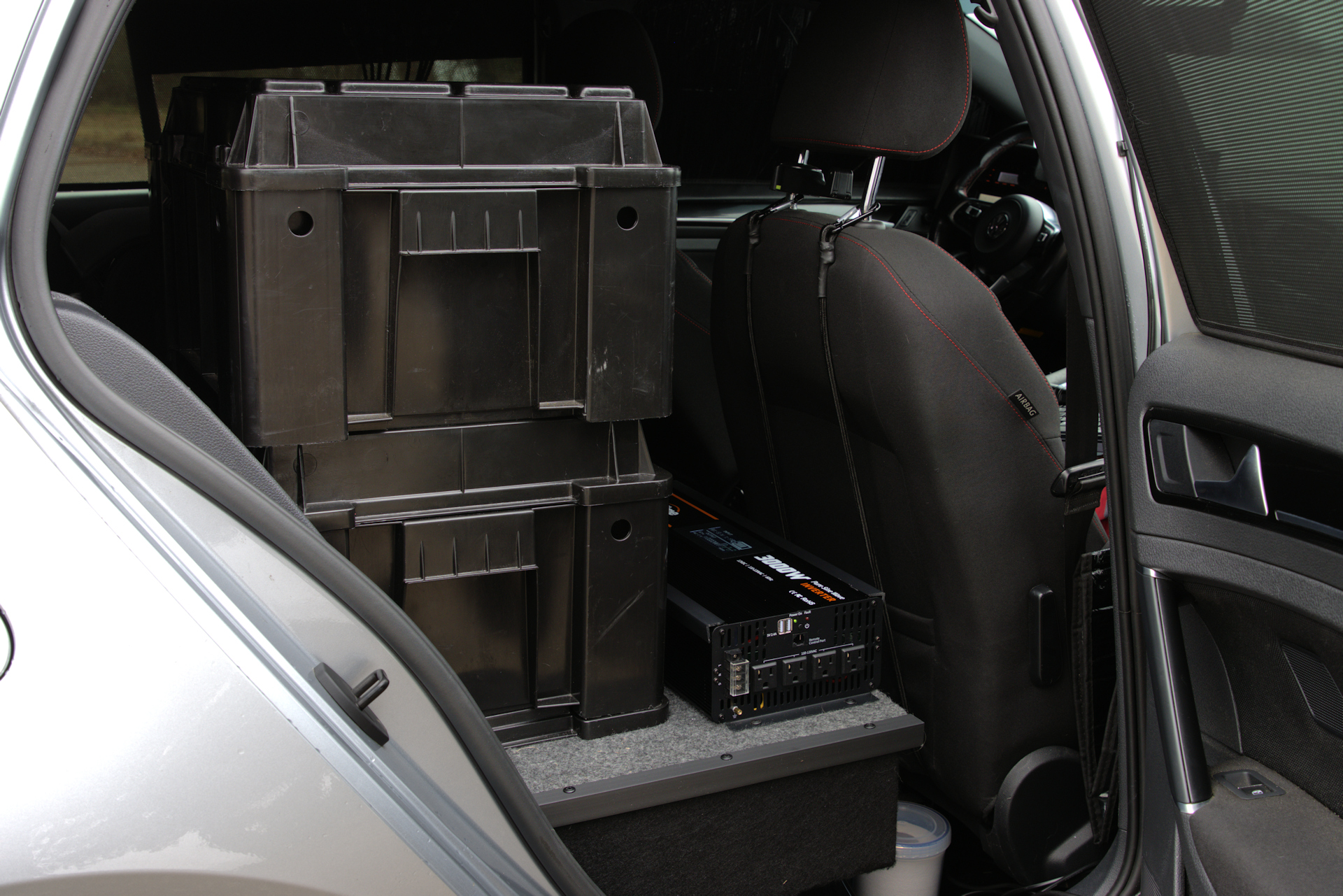

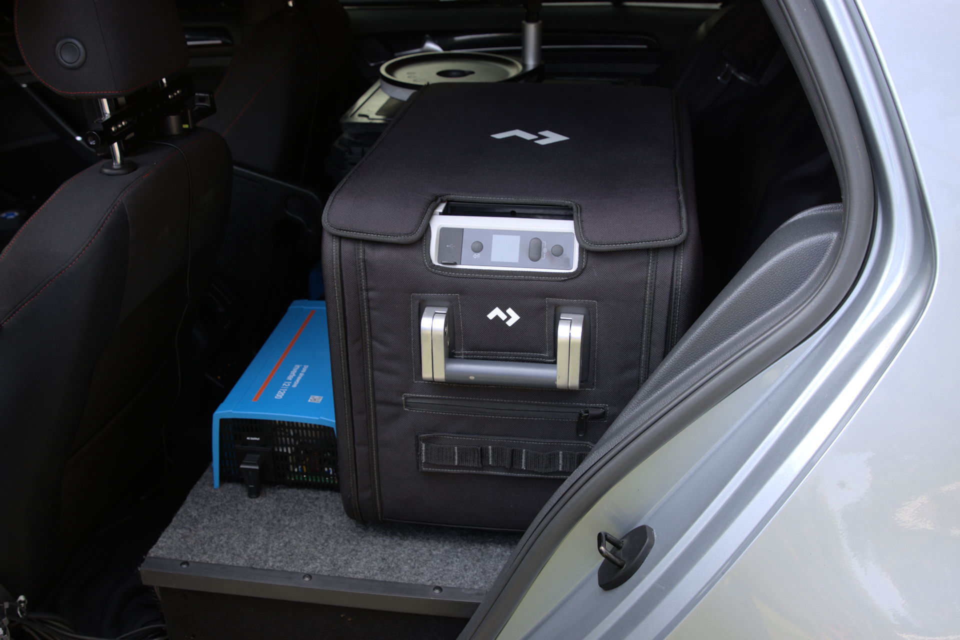

It's been a while since I joined and shared my setup. I STILL haven't been camping, but I continue to build and scheme in my mind. I've also driven to CA and back twice, around 15,000 miles traveled between November and March. I thought some might be interested in the changes to my "rear seat delete" and especially the LiFePo4 battery setup that I built for my ham radio setup. I had returned the rear seats to the car because I didn't like not having them. Now my daughter is out and on her own... definitely no need for a back seat. I started carrying the fridge full-time. That compelled me to get the "delete" back into the car...
Before the "delete..."
I built a new "delete" that has improvements over the last. It's stronger, fits better, and has ventilation that pushes air through my tight equipment area.

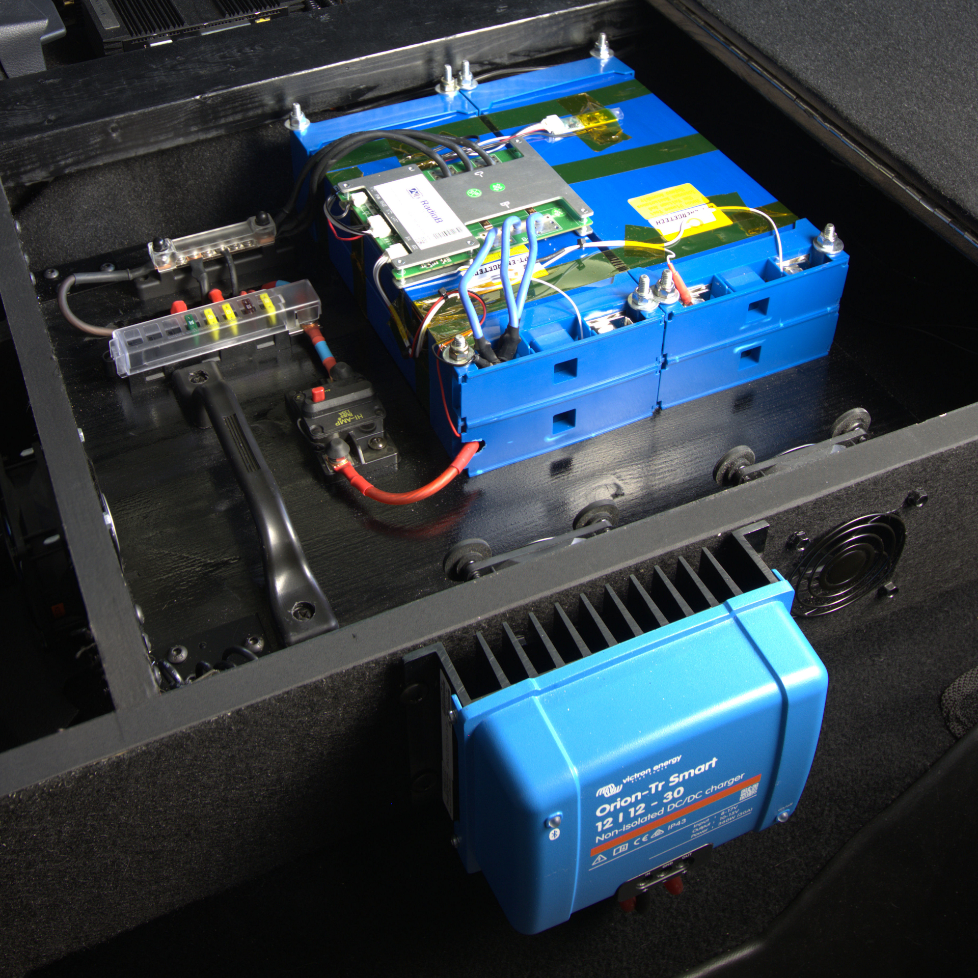

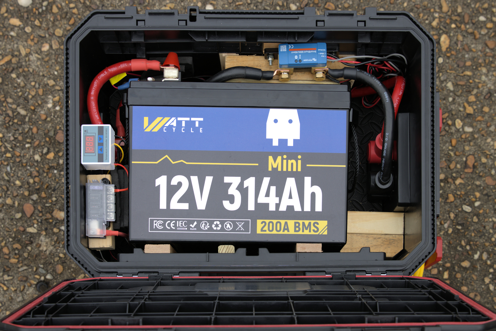

Anyway, my local ham radio club announced a class where they would do a "group build" session for 100-Ah LiFePo4 batteries, a popular power option for hams and Van Lifers. I jumped on the opportunity! We ordered the battery cells, 120-amp battery management system (BMS), and other components several months ago, then scheduled the build session when the parts finally arrived. The battery cells are by Fortune and the BMS came from "RadioB." In short, the completed battery can charge or discharge at 120 amps! I could even opt to upgrade the BMS and discharge at up to 200 amps someday. I don't have a need for that kind out output right now. But I could someday. :flushed:

I needed my battery to fit in a shorter space; so, I arranged mine in a "2x2" fashion to fit in this box...
Here's the build...
After the build, I removed the battery from the box so that I could paint it black...
Here's the box with paint...

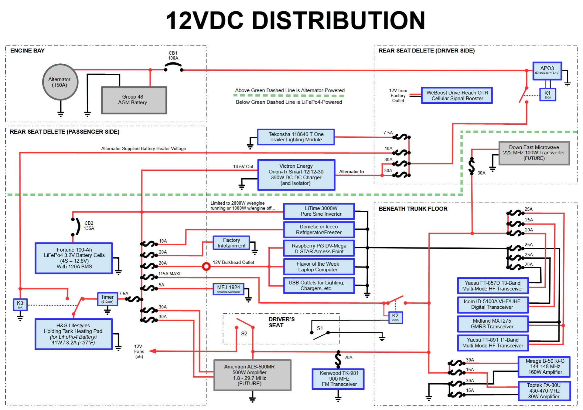

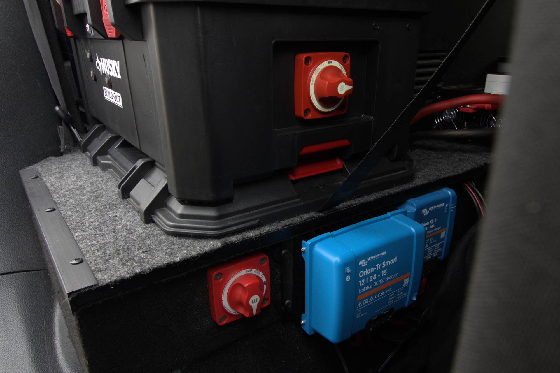

I use a DC-DC converter to charge the battery and to protect the alternator from excessive charging current...
I have it mounted separately from the battery box...
It's a 30-amp charger that usually starts around 27 amps and then settles around 21A...

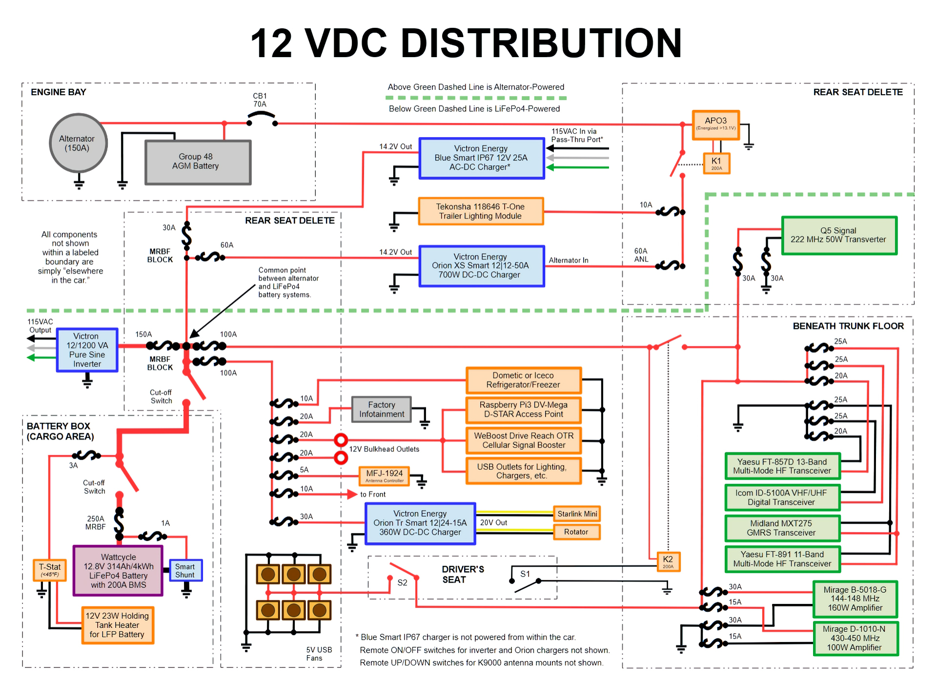

Here's a functional block diagram of what I have going on back there...

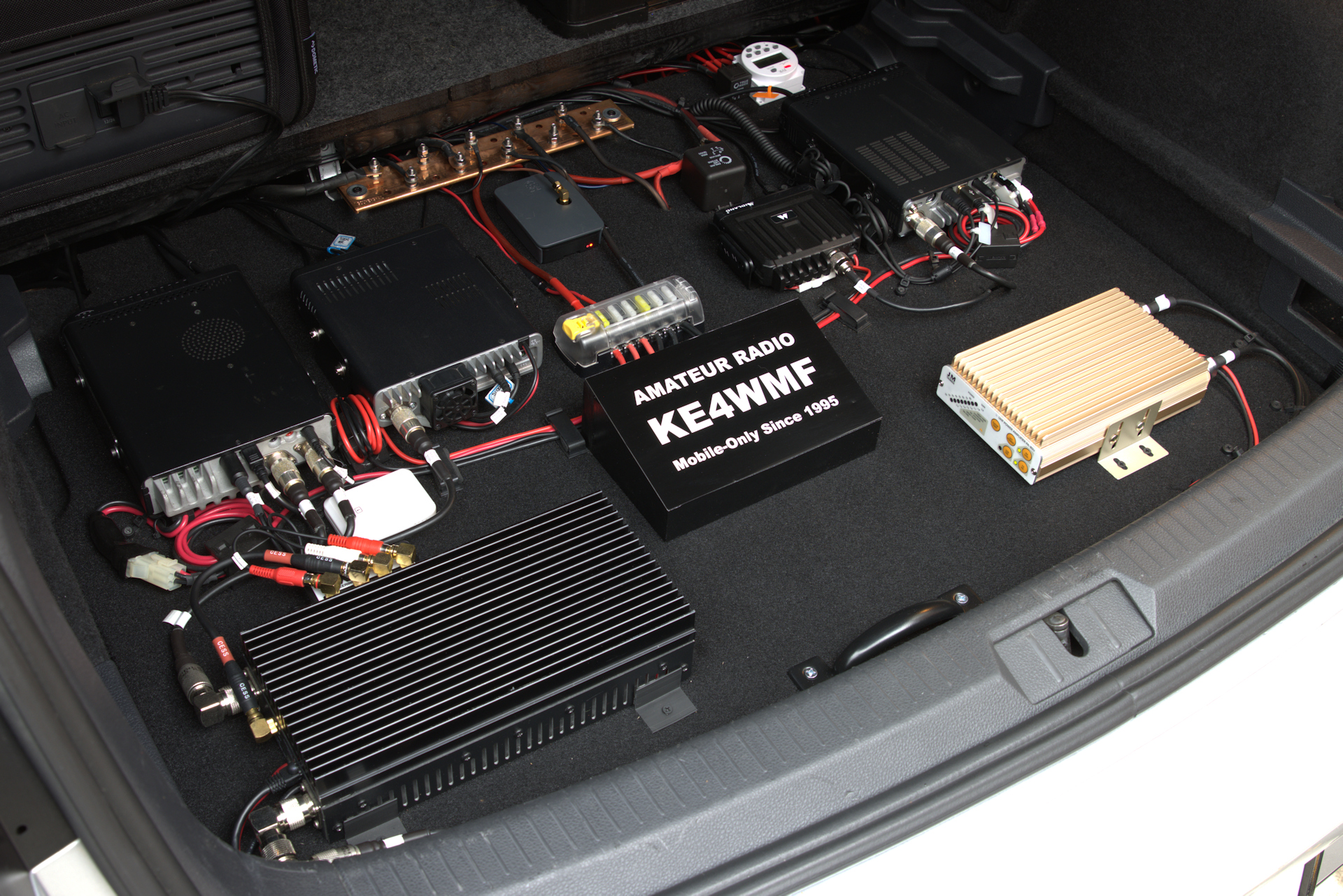

And here's the majority of the hidden equipment with the floors removed...

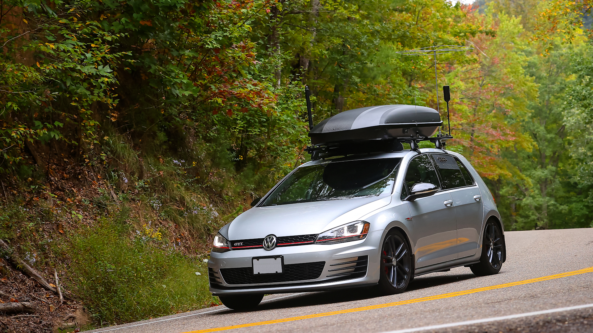

My progress will be slow, but I'll be sure to update this topic as we accomplish things. Oh, here's a photo of my "rig" from our trip to Maine:

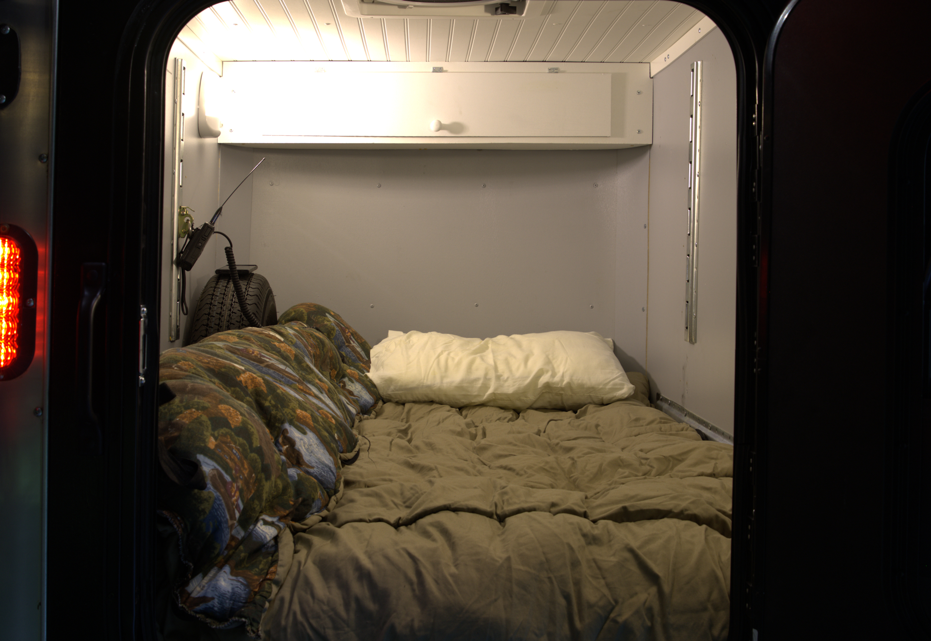

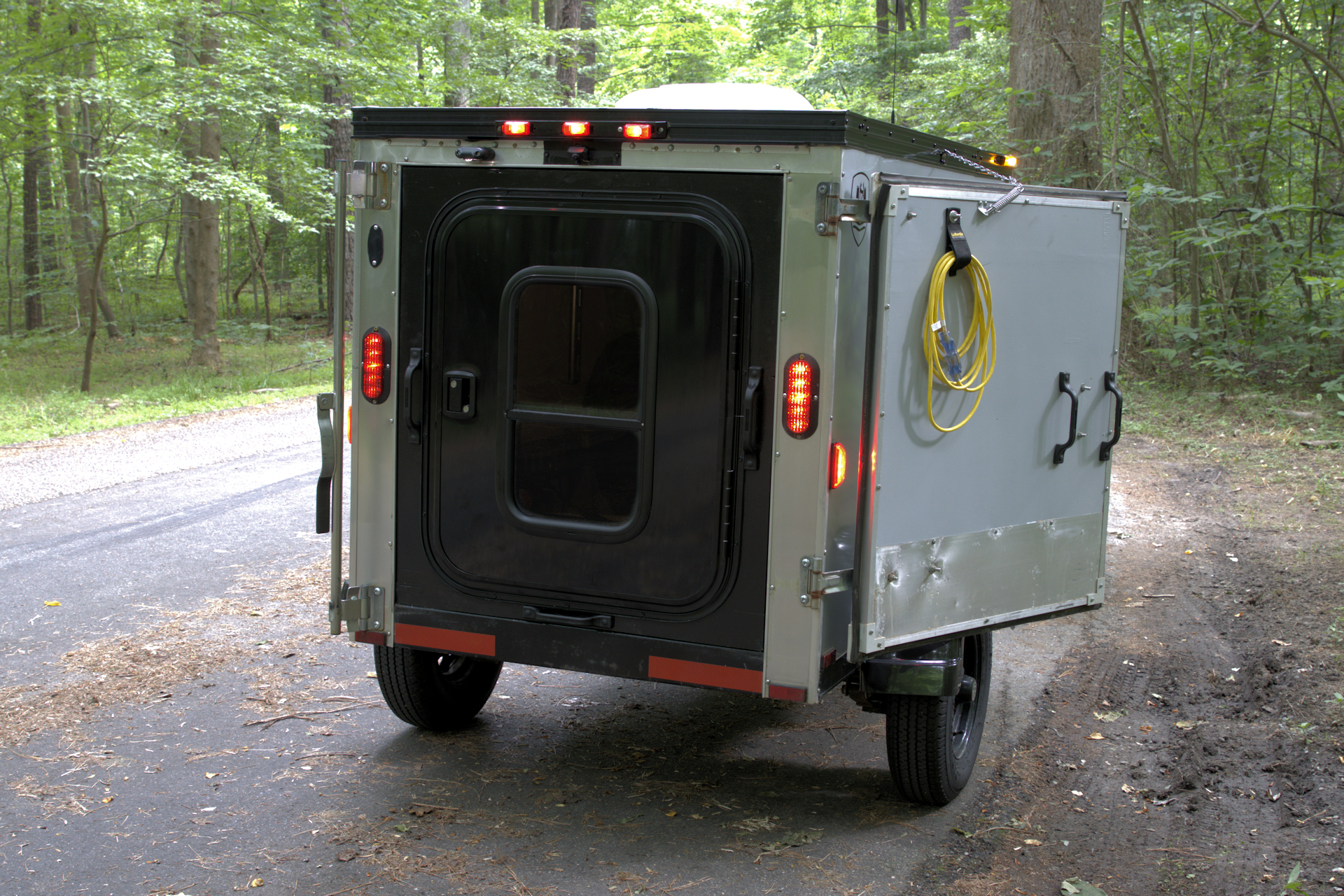

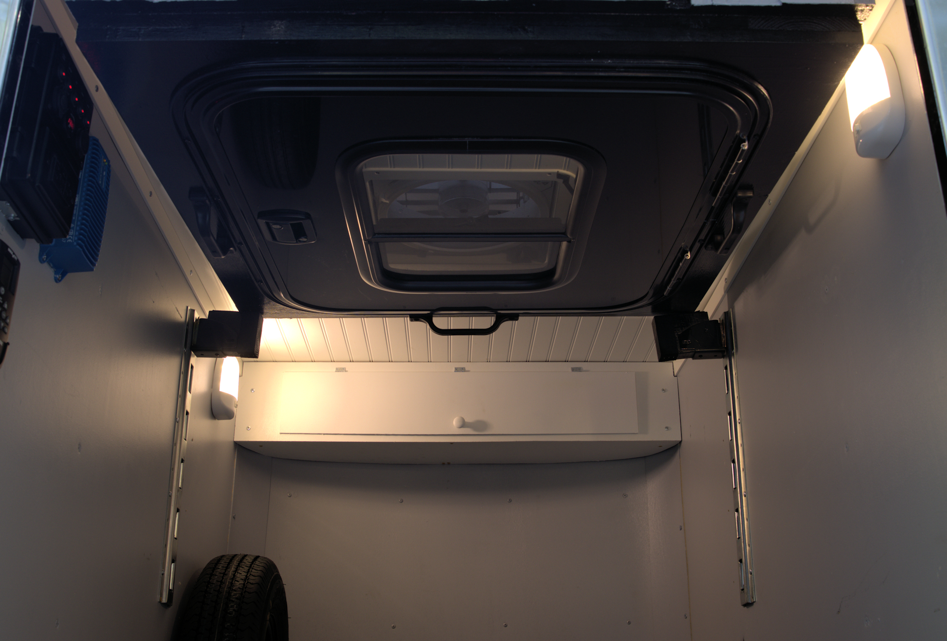

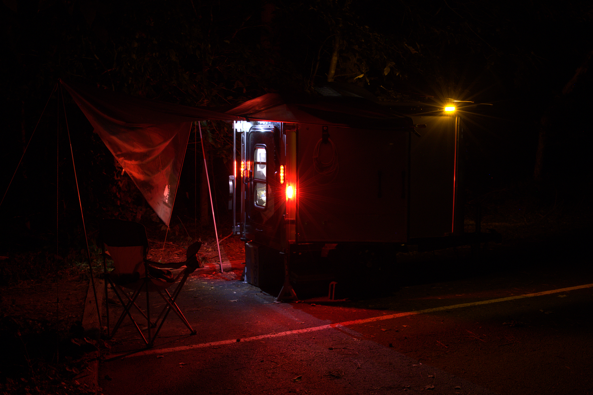

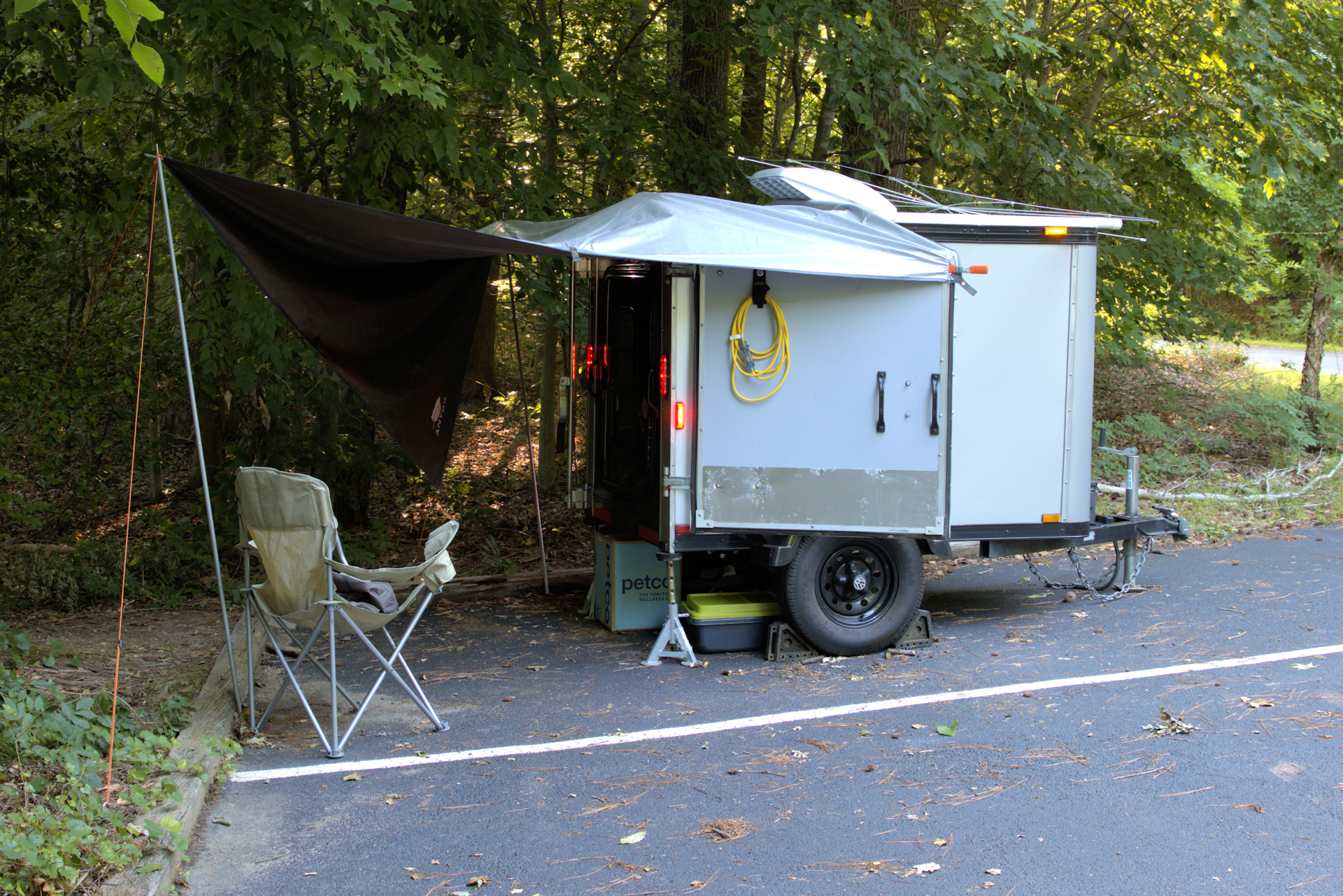

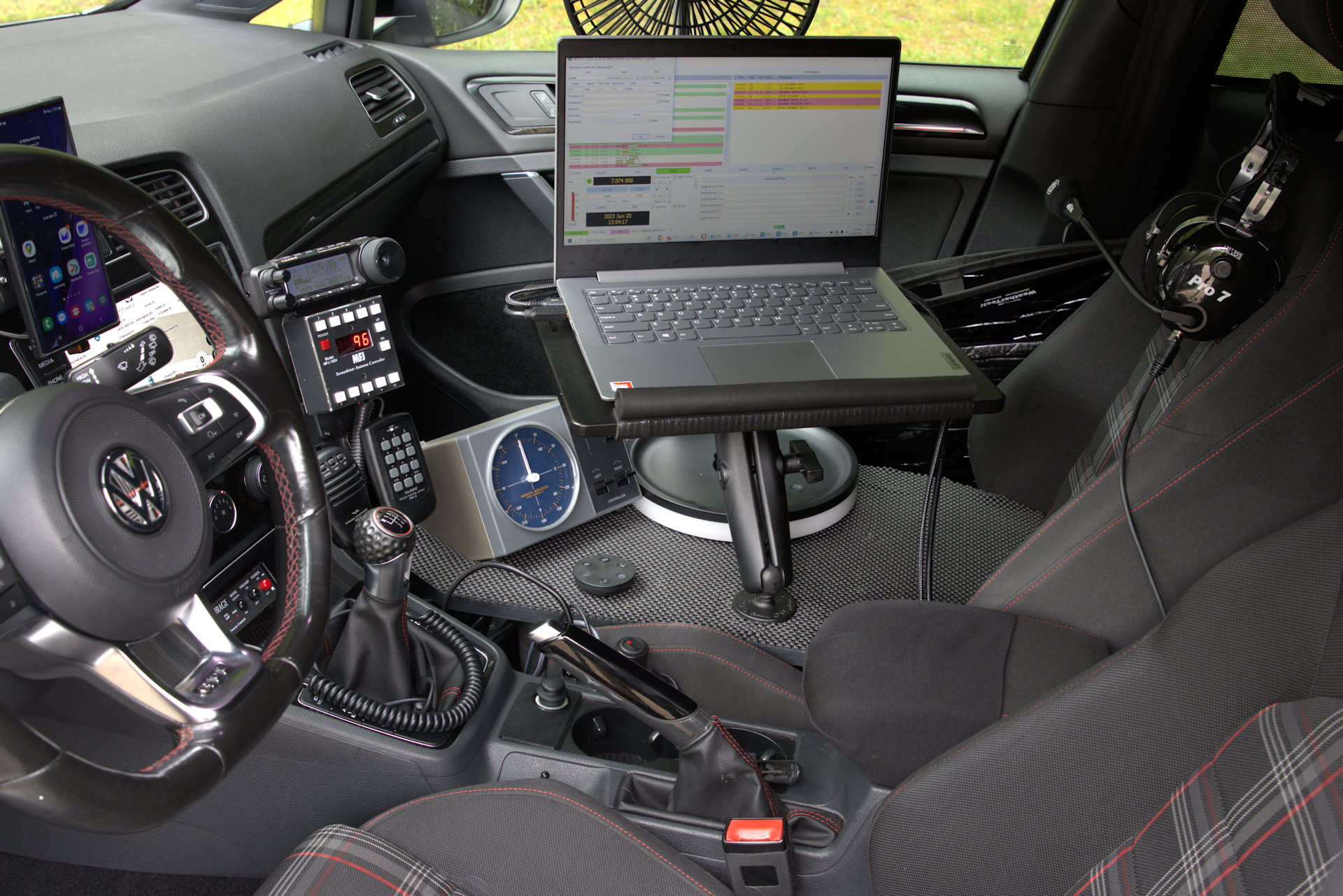

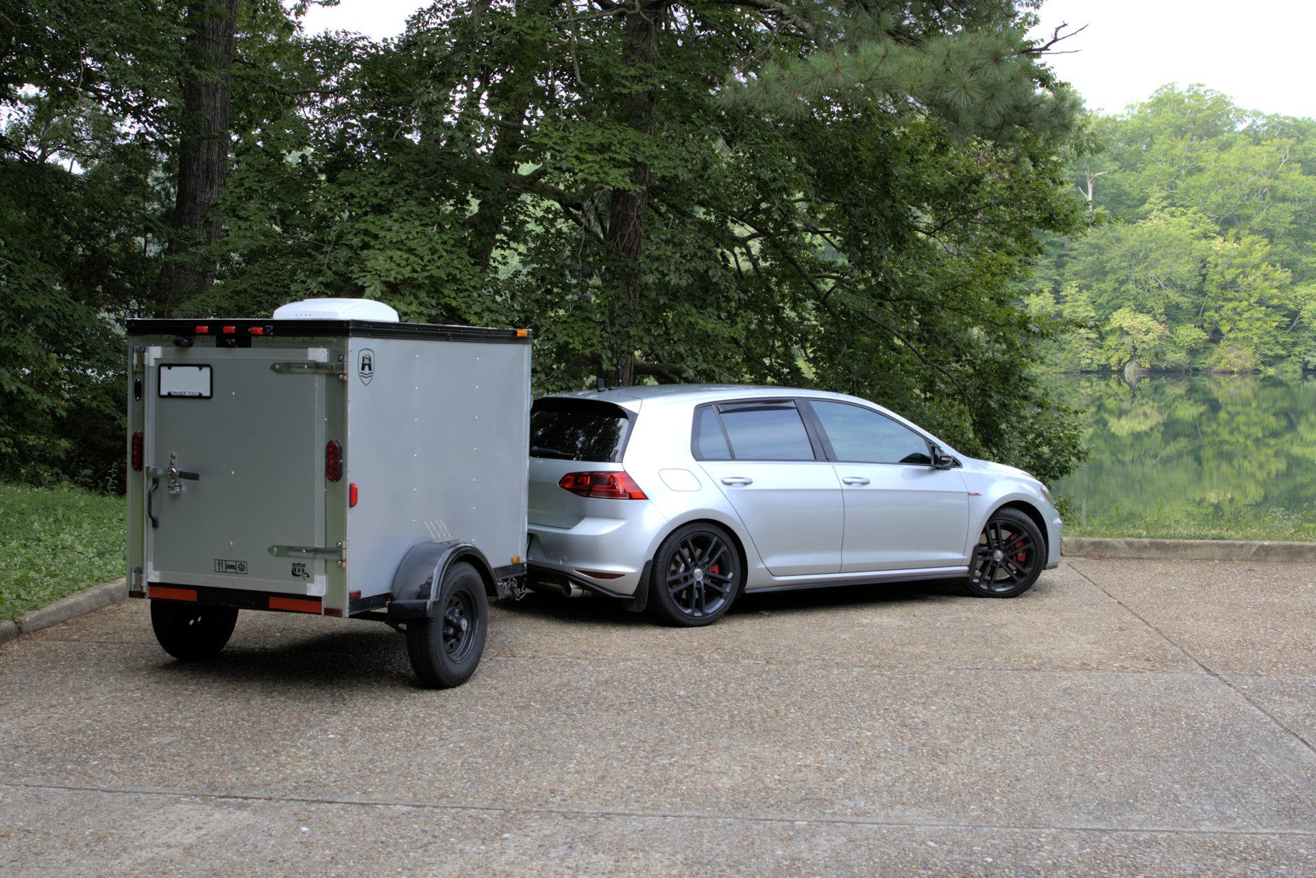

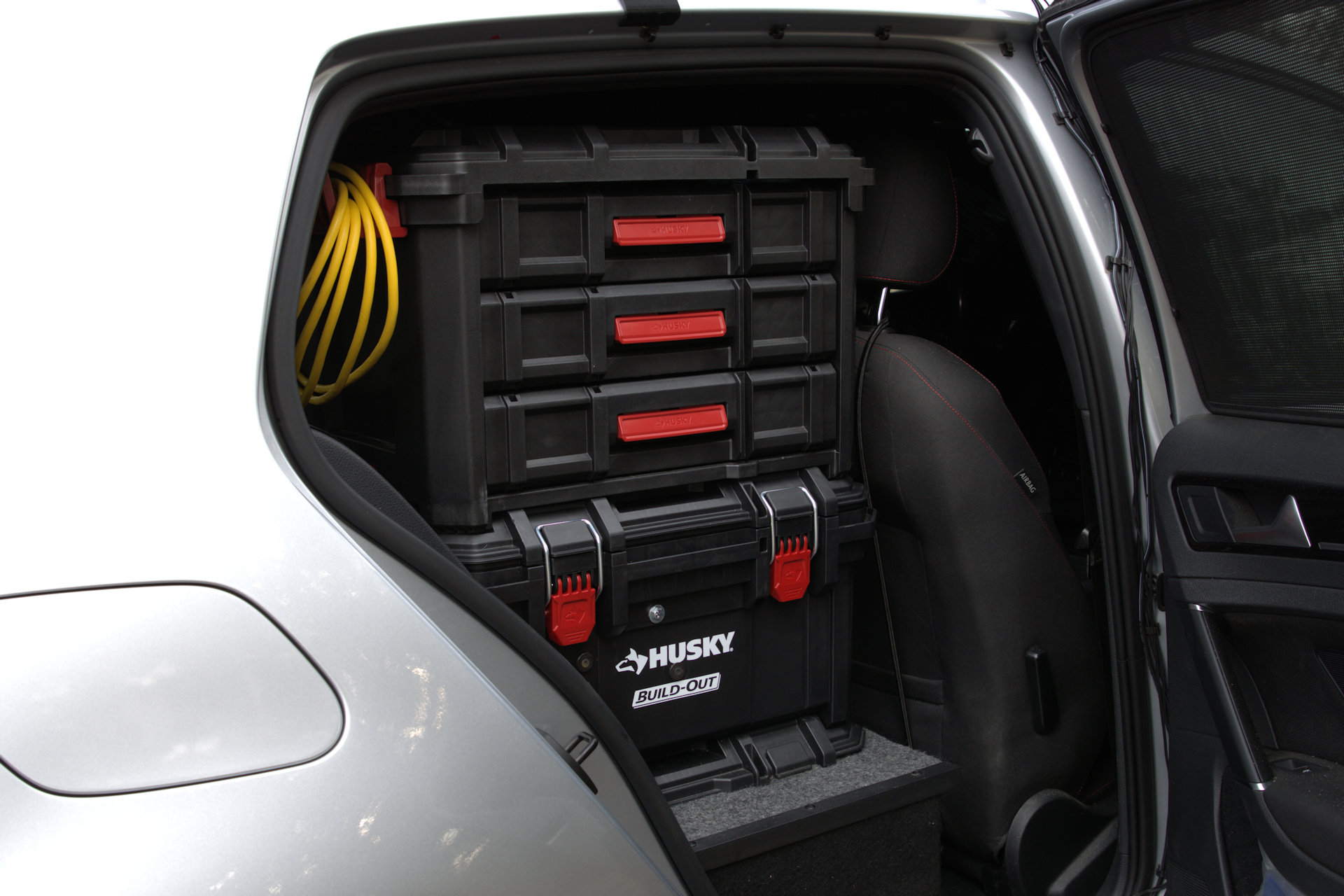

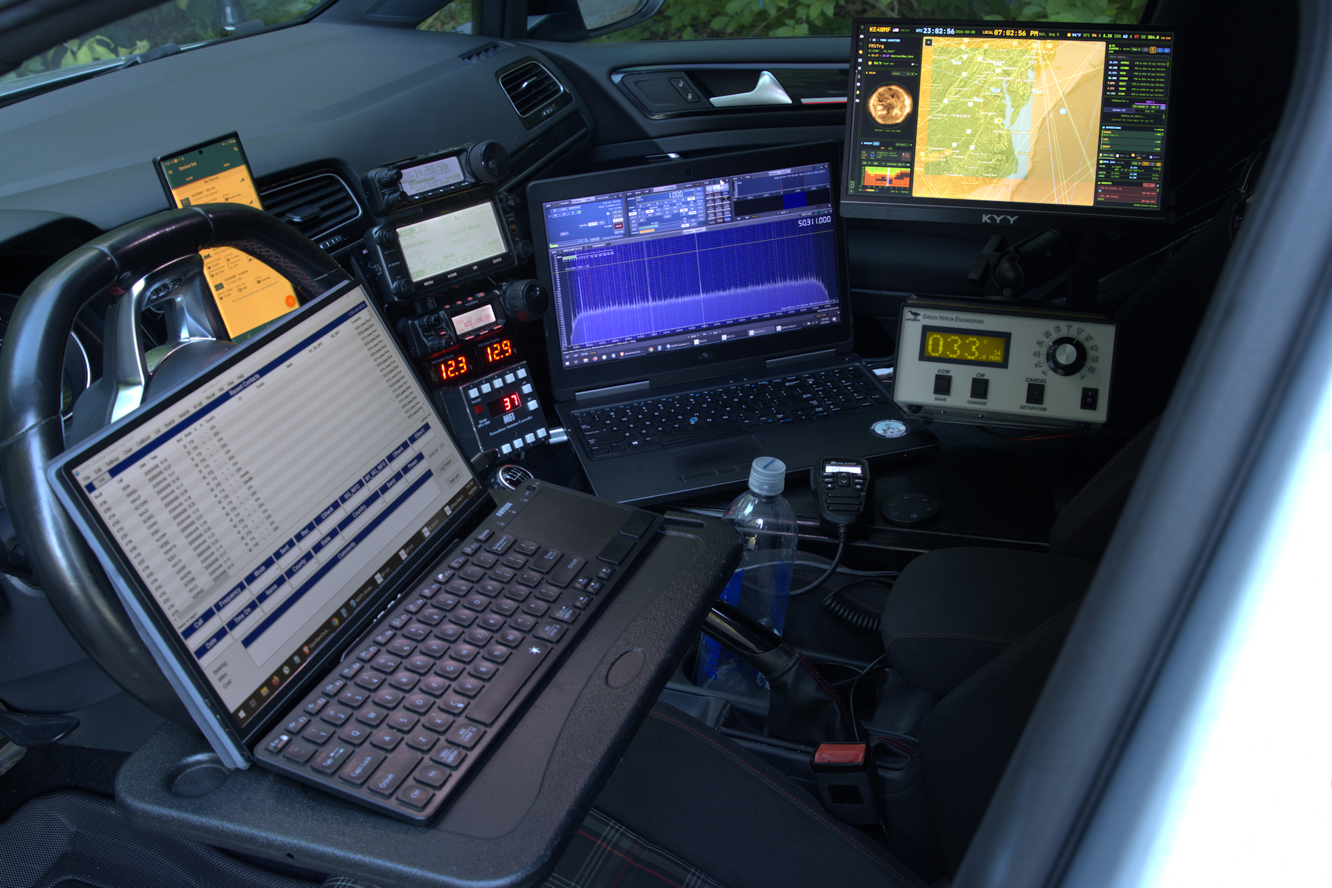

Whoa! Time has really passed. The car has grown a bit. More specifically, the ham radio station has grown A LOT! I'll share some photos, but I will also share that I have camped ONE night in a small cargo trailer conversion. It was for an overnight ham radio event called "Field Day." Here's my setup from that weekend...
More info about this trailer HERE. The ham radio stuff is out of control! I explain in this RIGS AND RADIO PODCAST that the foundations of the build are very much overland-inspired. I think I've already shared photos of the Dometic refrigerator. I've increased my inverter to 3000 watts. Not that my system can support that, but I wanted the remote control and "too much" inverter so that I don't risk overburdening a 1500W unit. My BMS and DC-DC charger will limit my inverter use to 1500W when parked or 2000W when the engine is running. Most of the time, though, it'll be OFF.

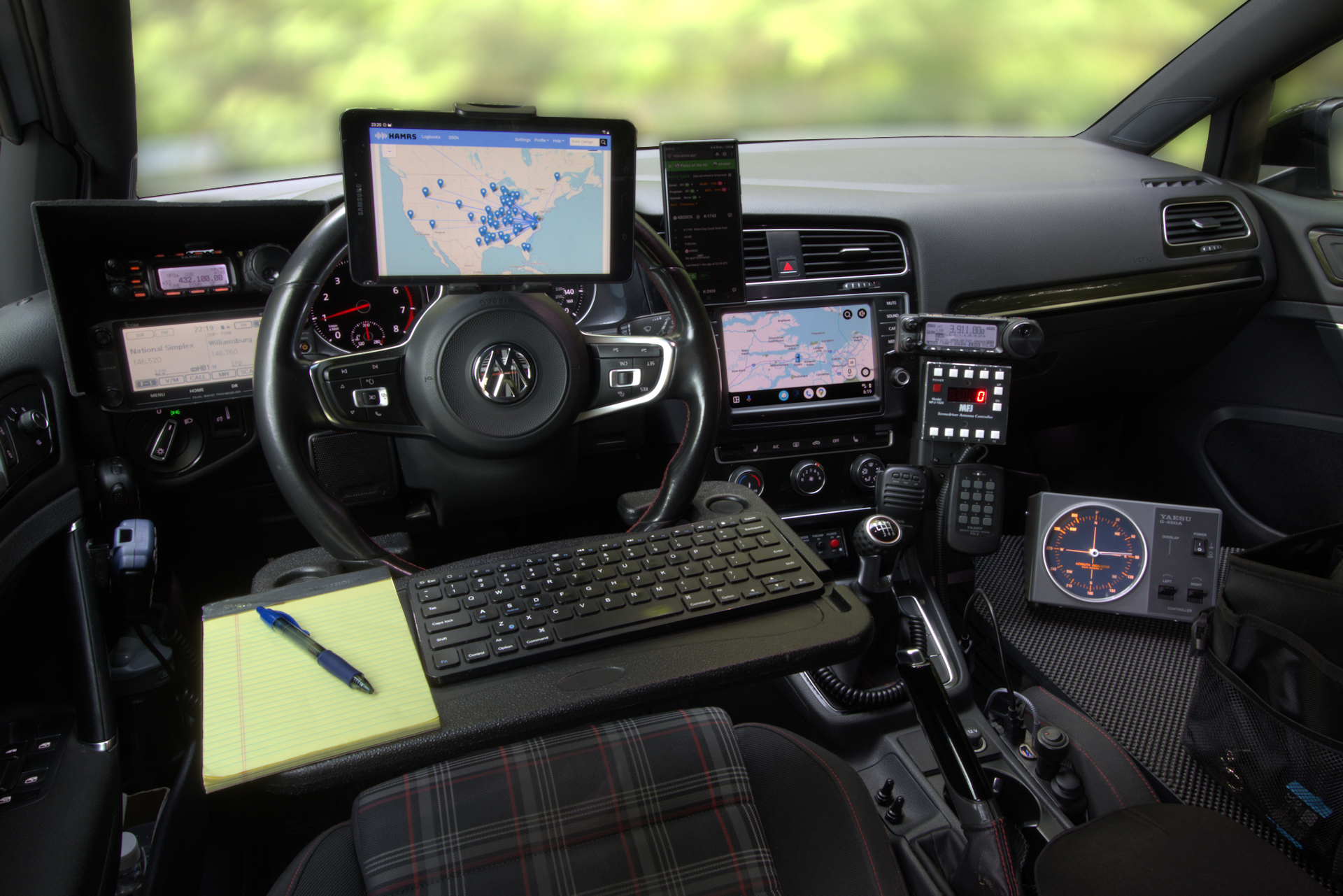

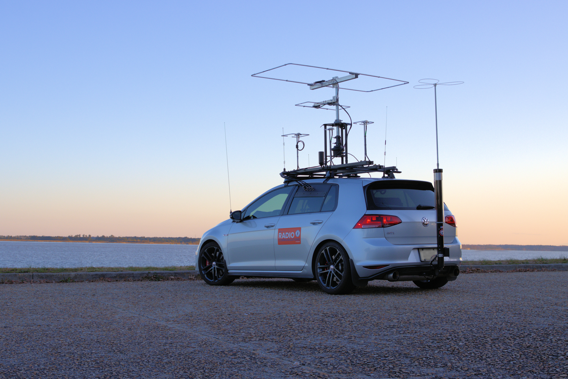

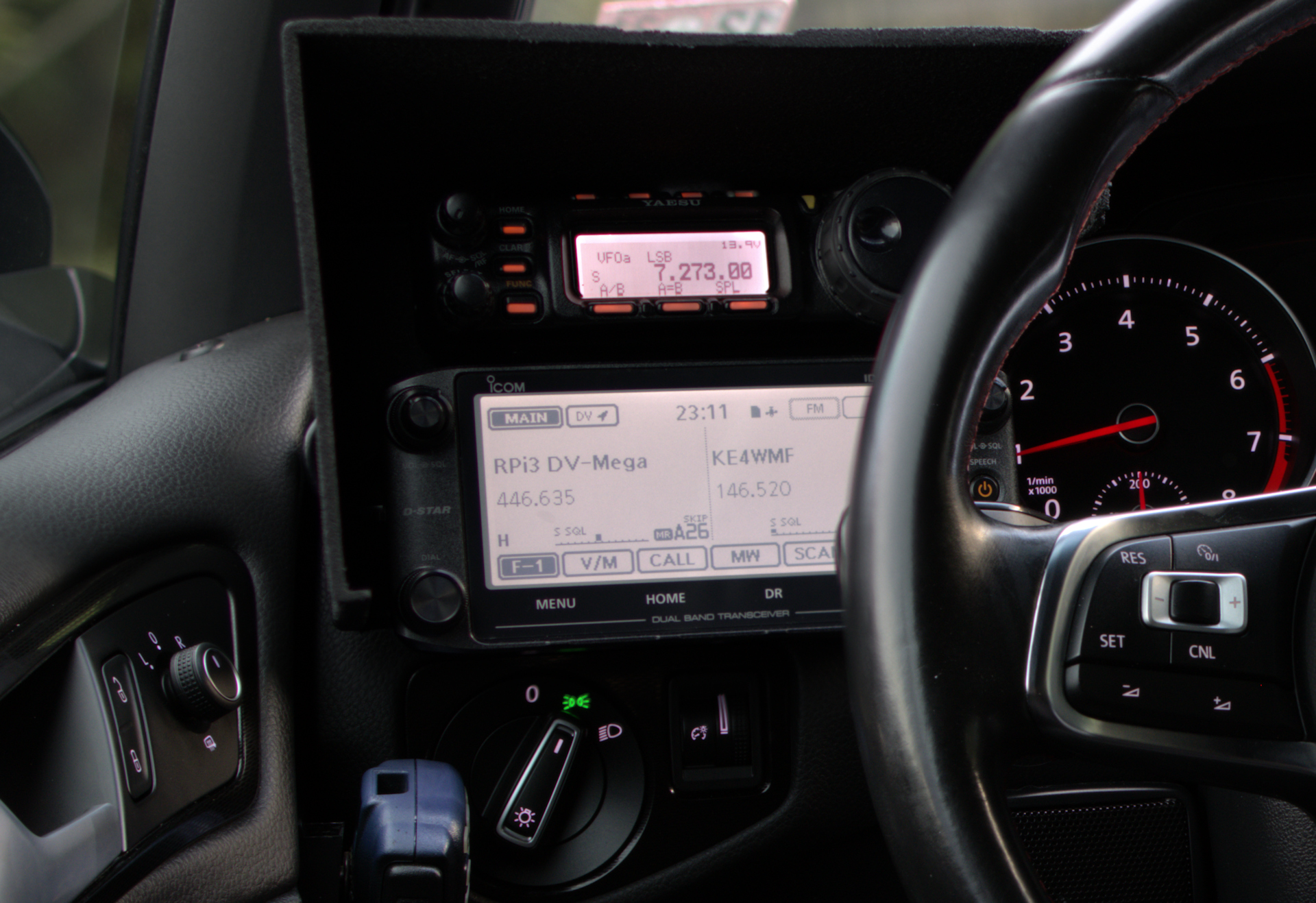

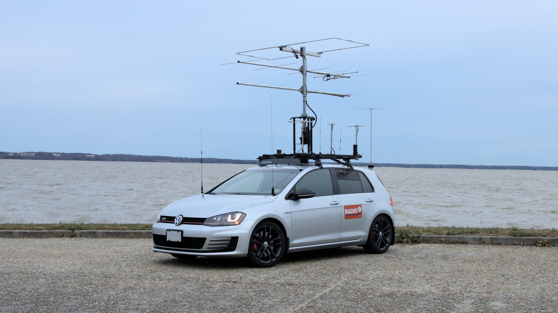

Anyway, here are the nutty photos of my expanded amateur radio setup... Interestingly, some of these images aren't displaying as I draft. I KNOW the URLs are good. Right-click on any "broken" X photos and select "open image in new tab." They display fine there. Weird!

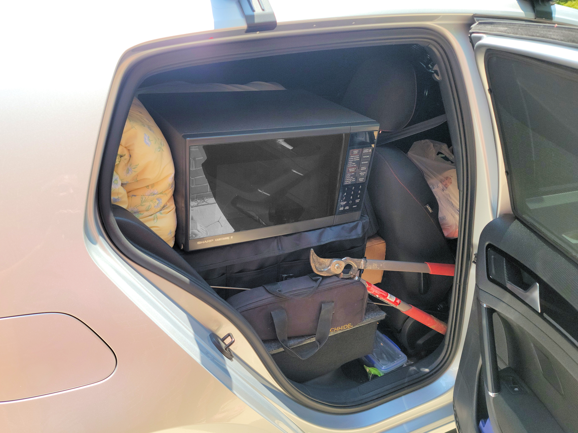

Everything is modular to mount and remove as needed. Most of the time, I run with just 4-5 vertical antennas. The other stuff mounts when my "mission" requires it. At this point, I think I'm using the car more for travel and radio adventures than for camping. BUT I still credit this community for inspiring a lot of the build. One of my radio adventures took me to an isolated area of West Virginia. Sure, the roads were either paved or good dirt roads, but there were no stores or places to eat for HOURS. So, the frig served me well and I even had a microwave oven with me...
So, while it may be years before any of you see me on a trip, I wanted to follow-up with my build and thank you for quietly inspiring me.
