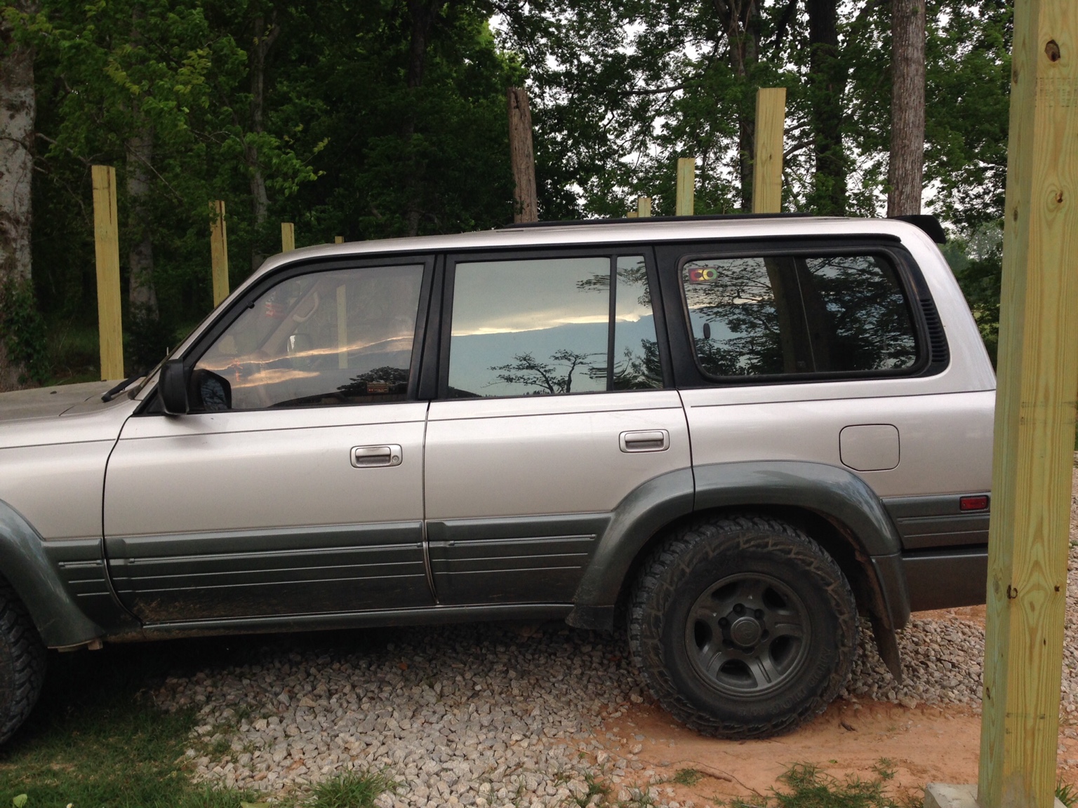

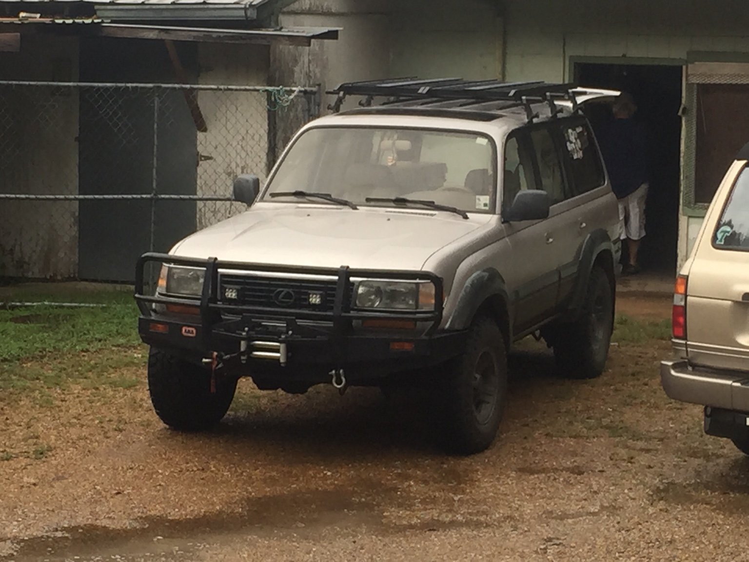

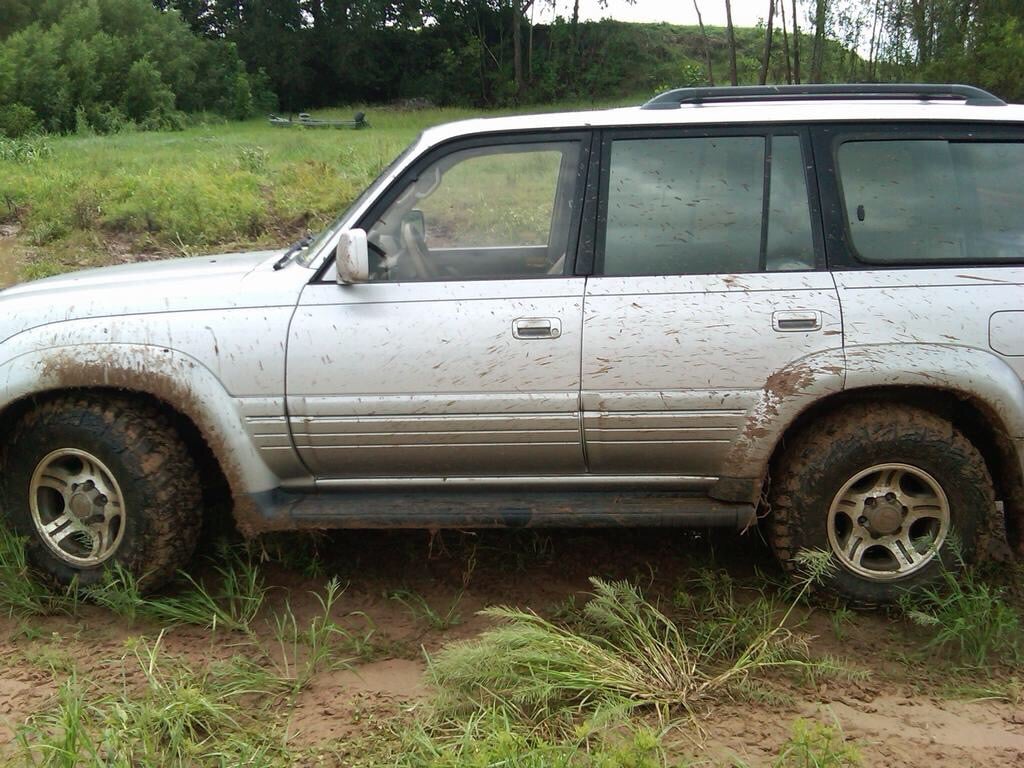

here is the first picture of the vehicle that I still have. Got some mud grips on it and was ready to go. As many of you know that wasn't enough.

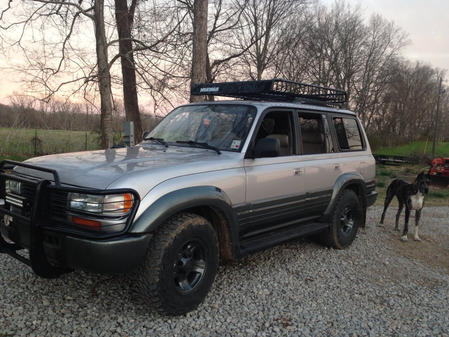

I got the molding painted and it was all cylinders firing now. I added a cheap grille guard and a Yakima mega load warrior rack

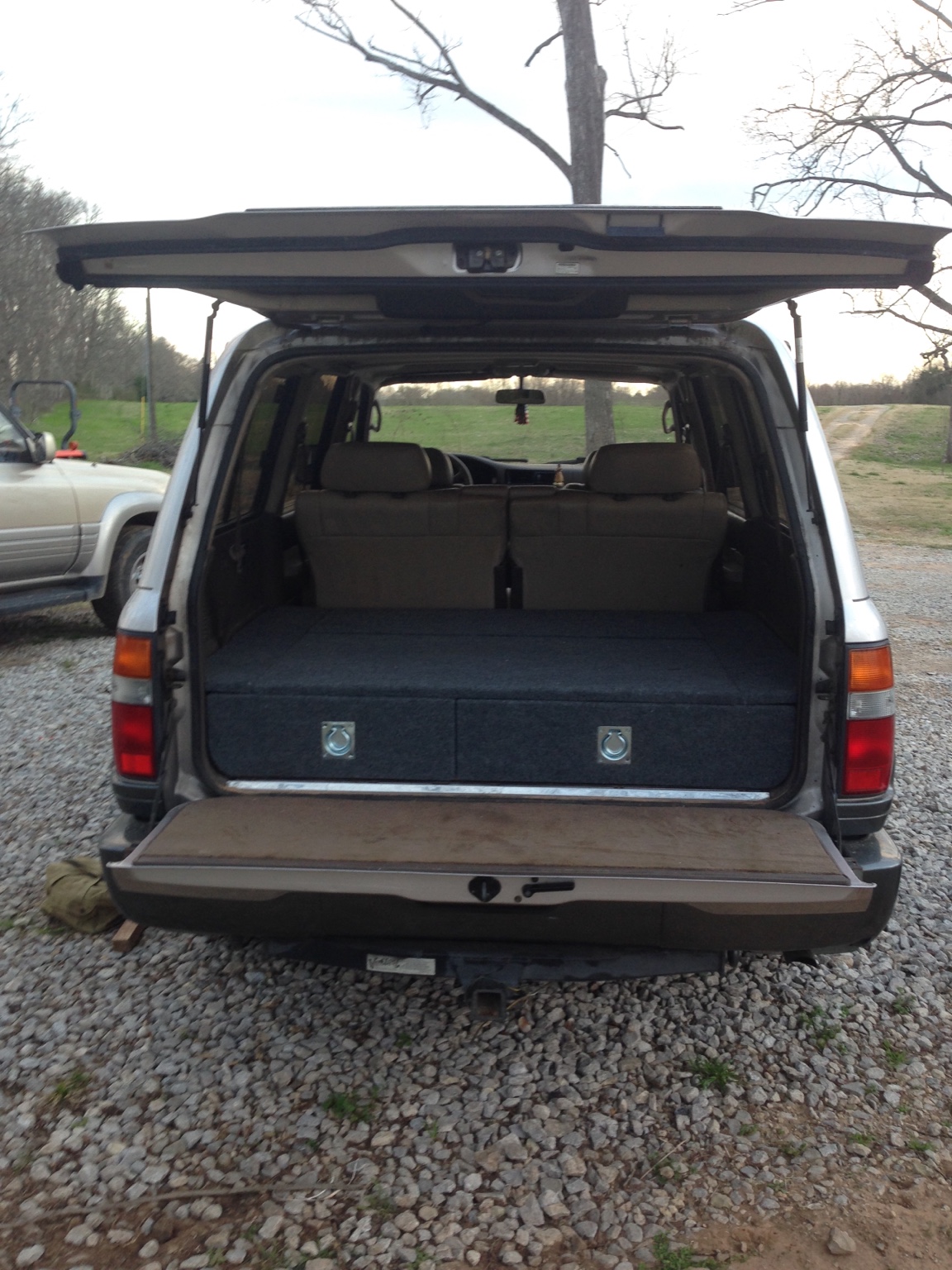

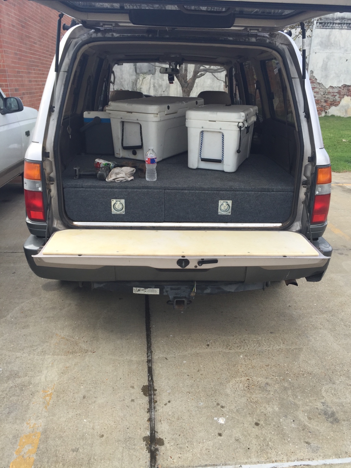

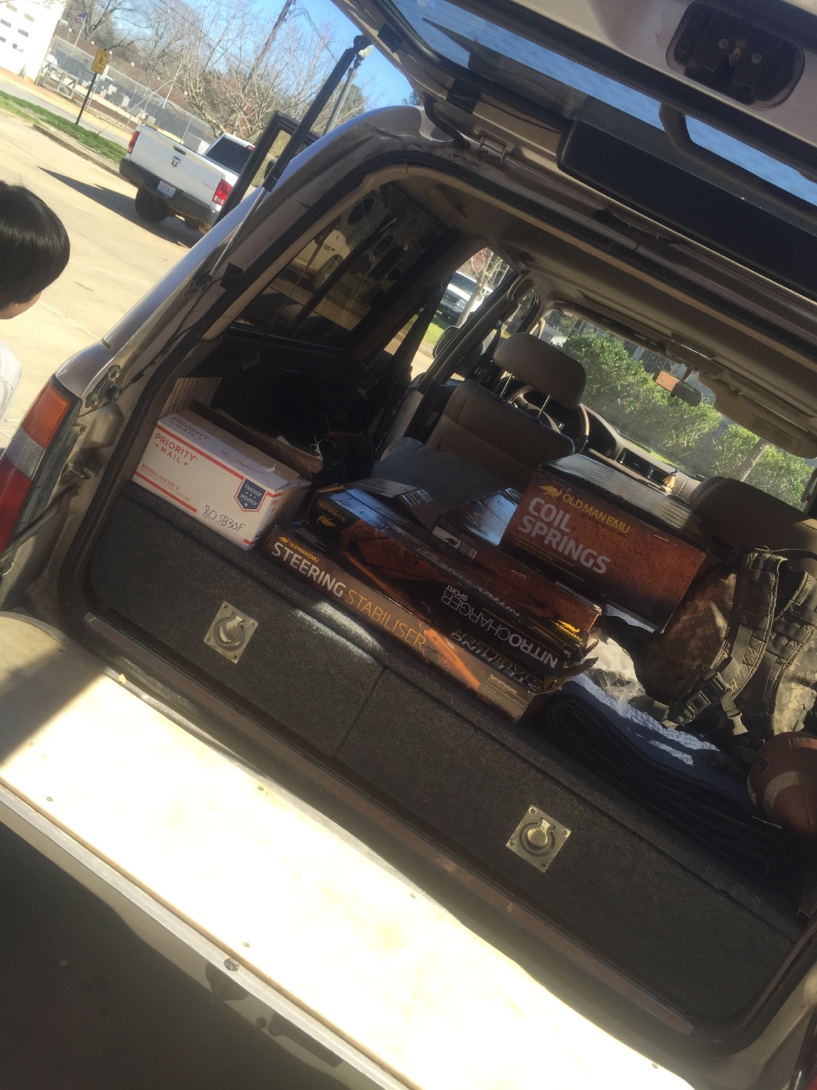

and I also build a custom storage box in the rear (probably my favorite mod) and replaced the tailgate carpet with a cutting board

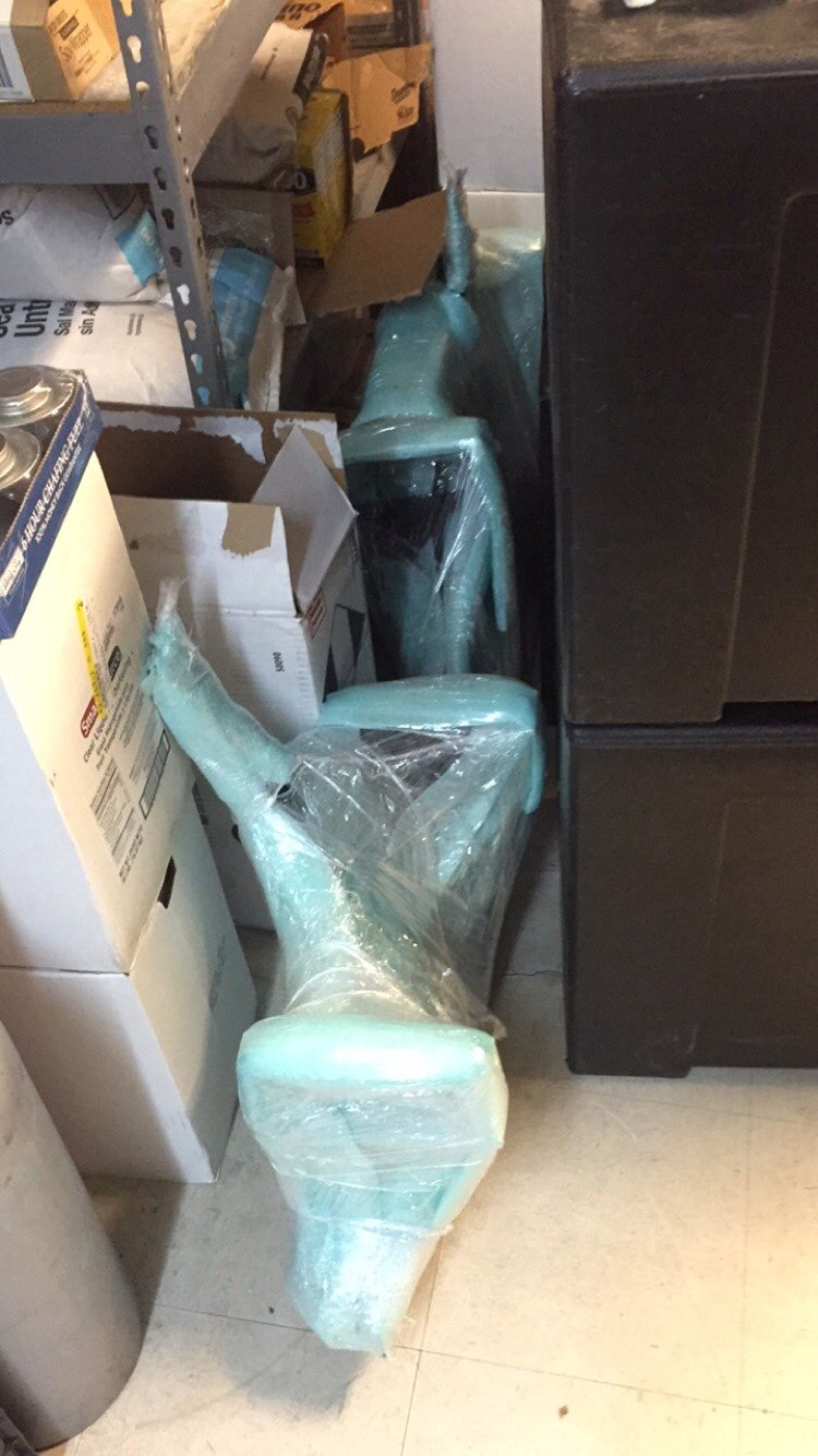

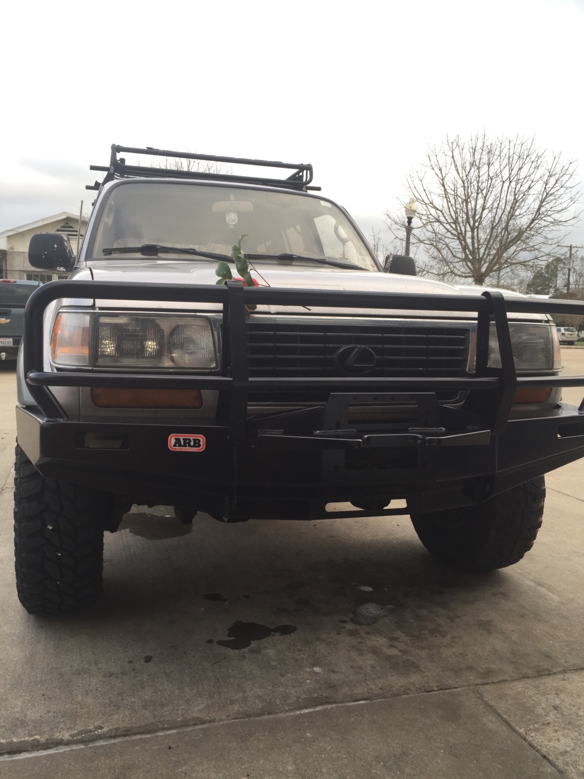

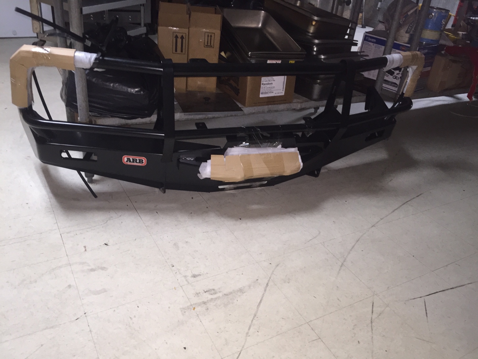

After lots of reading, saving up and people jumping my case, I decided to go with the ARB bumper that allowed sit a winch, I don't have a picture of the winch installed but I went with a tuff stuff waterproof 12.5K synthetic and I couldn't be happier

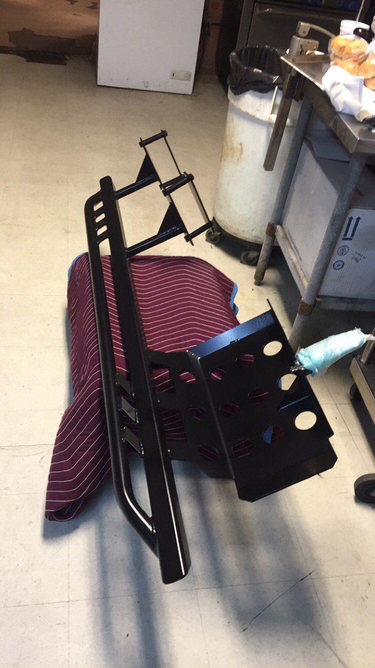

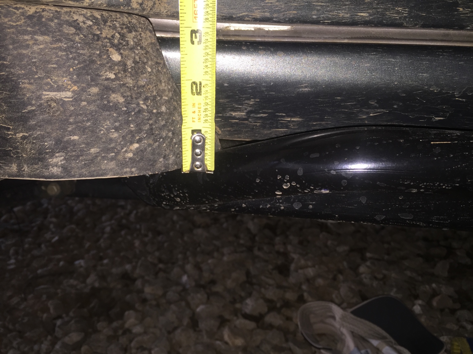

after some time more I was able to scrap up enough money for a DECENT pair of rock sliders. I went with Rocky Road Outfitters because they were the cheapest option at the time and I couldn't have been more upset. The sliders were terrible in their fitment. The from of the slider was almost 2 inches from the body and the rear was touching the body. After weeks of fighting with the company and then asking me to ship them back just to see if they fit I was able to get a 100$ refund because we would have to cut and Reweld the brackets to fit correctly

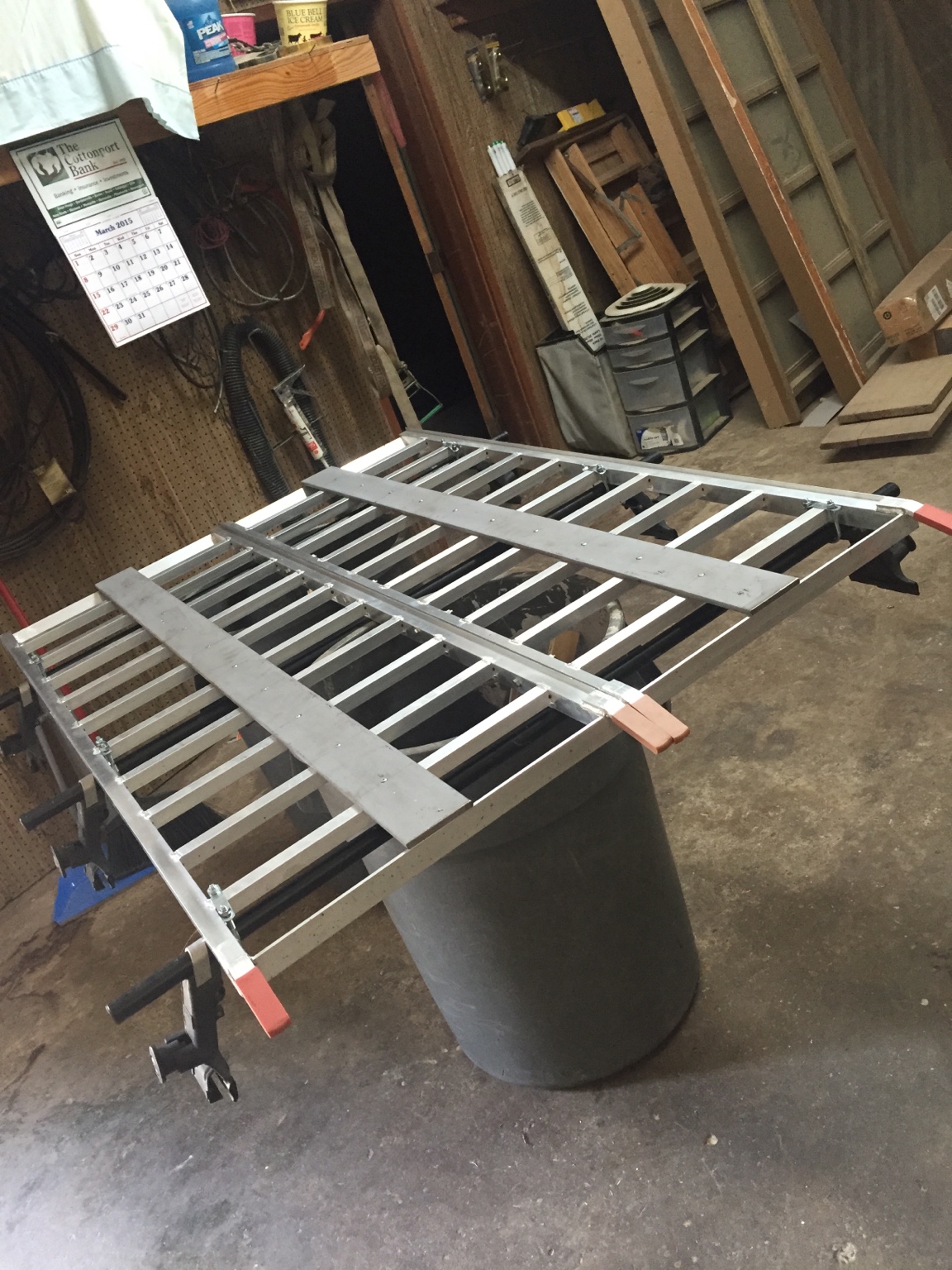

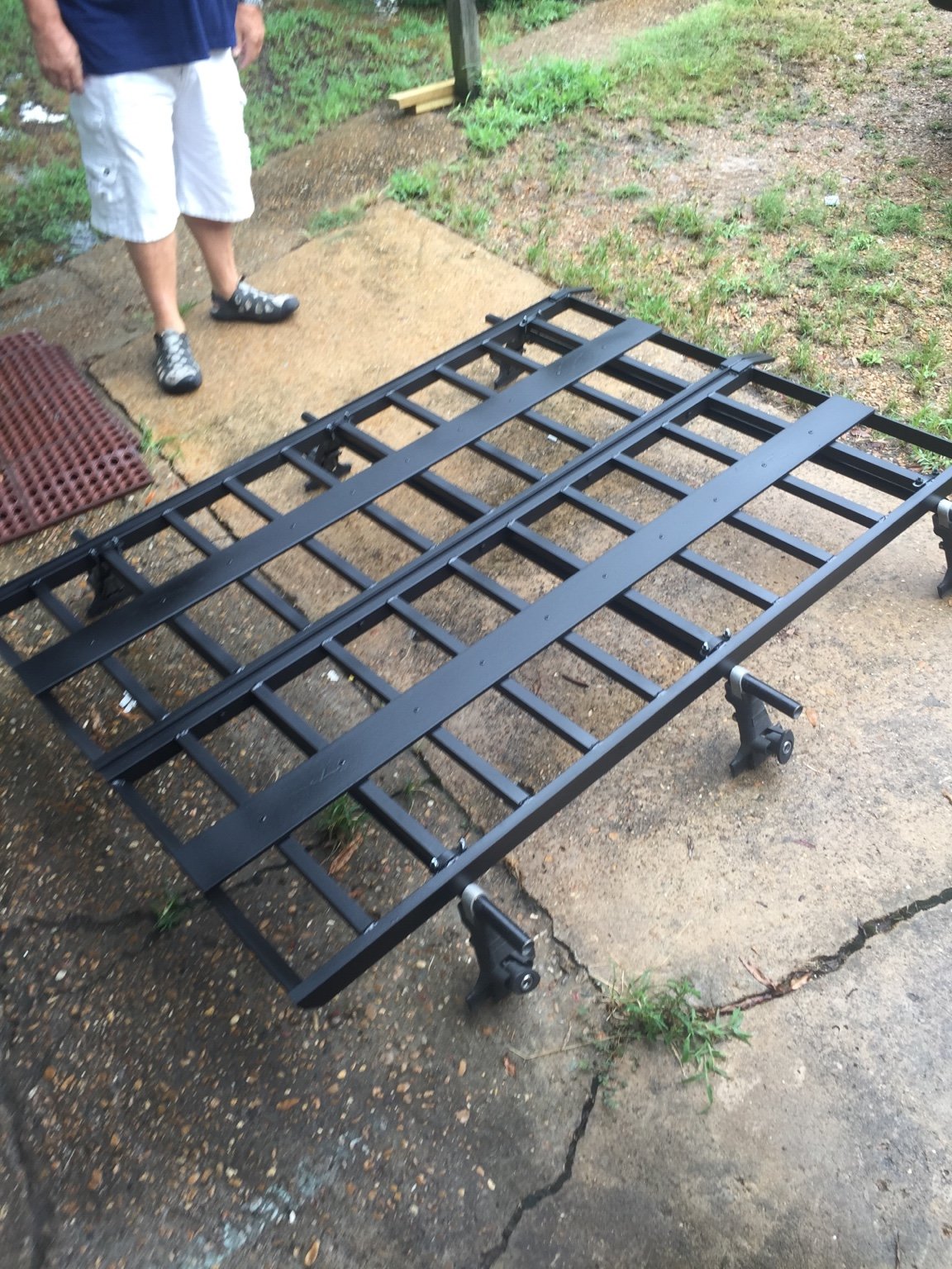

The next step would be building the J-moose flat rack to replace my Yakima mega warrior basket rack. This was a fun project and the old man helped me the whole way through

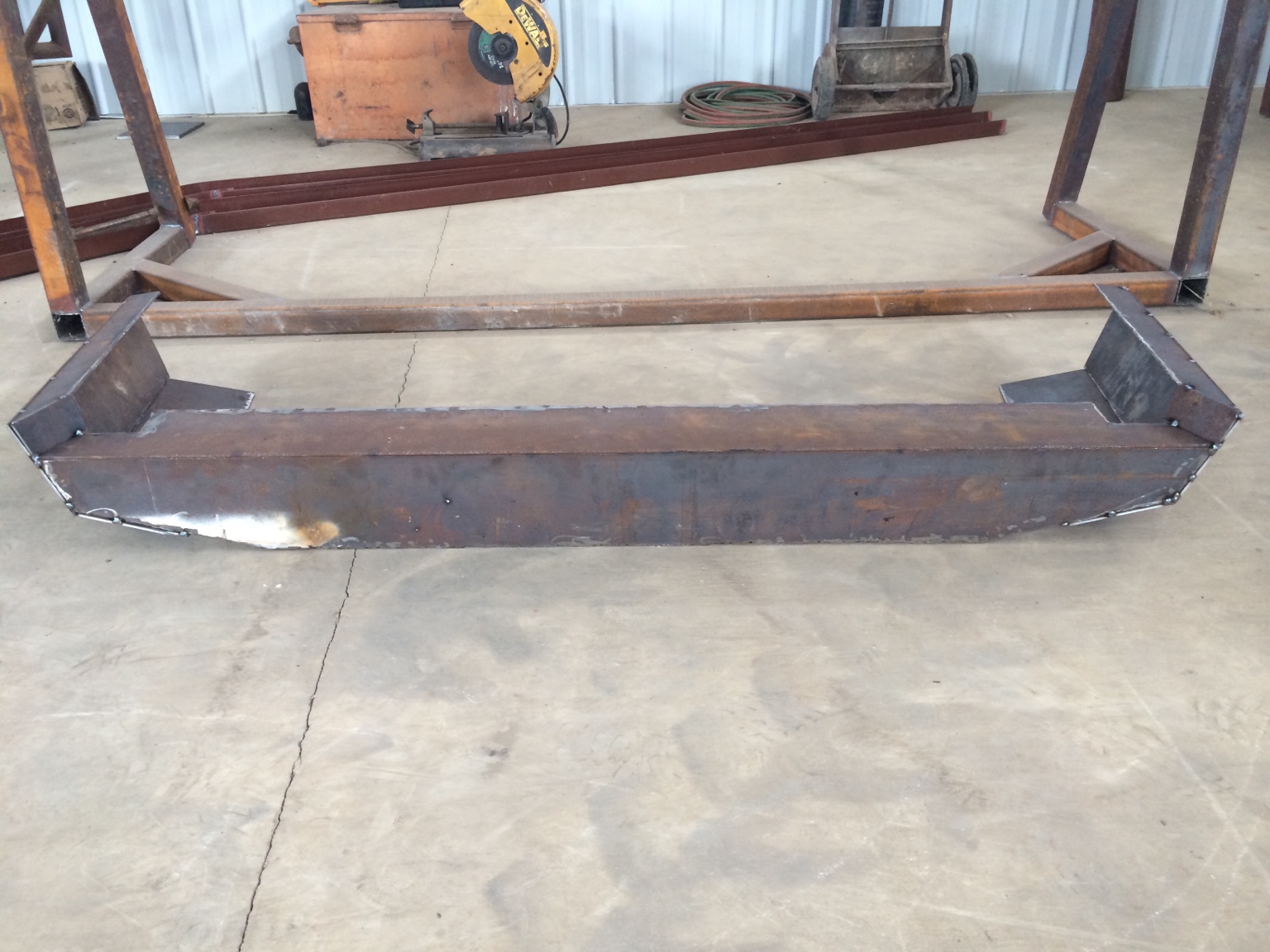

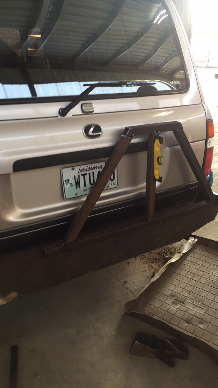

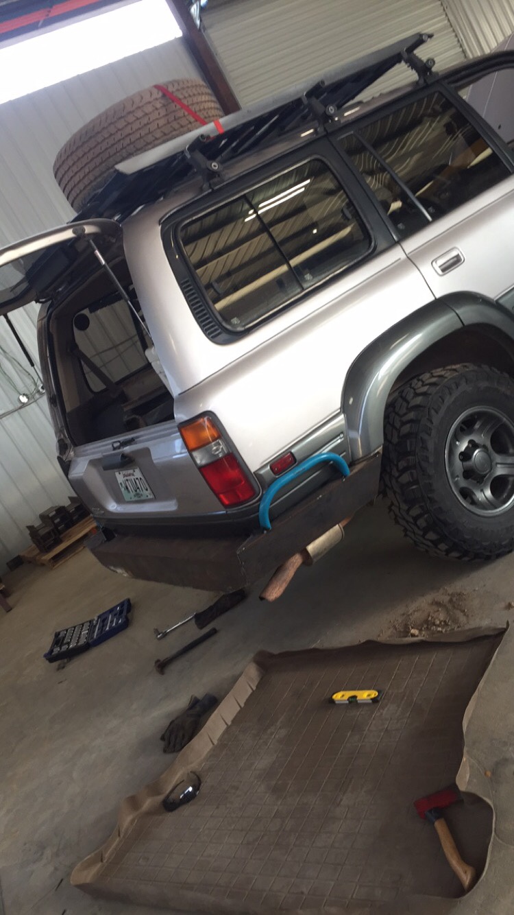

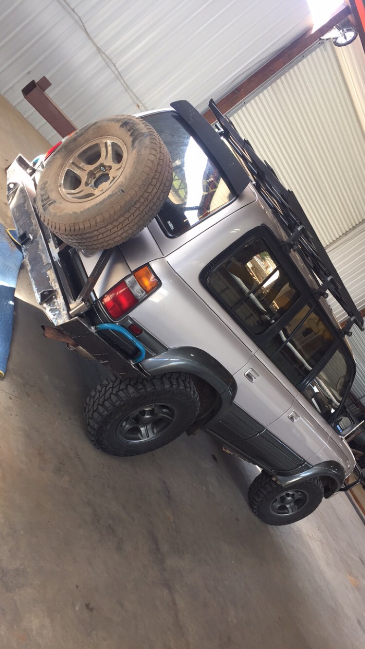

this would lead me into the next project which was a custom built rear bumper, the ones that were manufactured were just way out of my price range so I got a template off of mud and we went to work. After about 2-3 weeks it was finished. Another fun project that taught me a lot

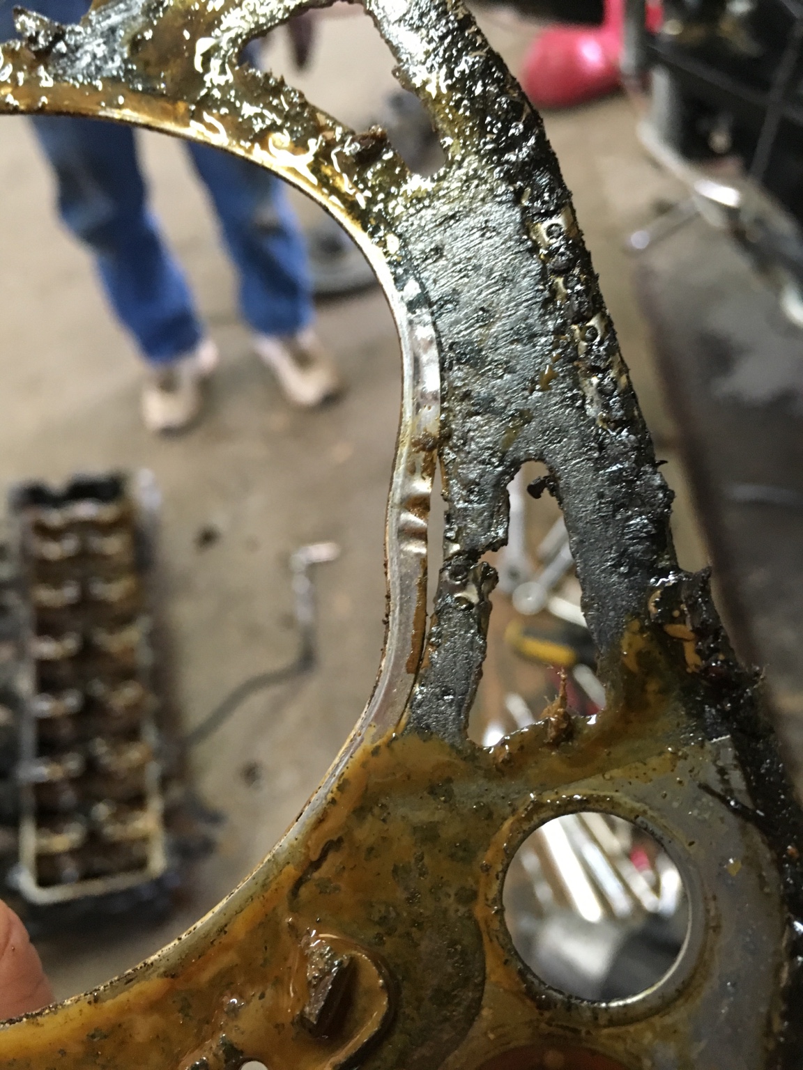

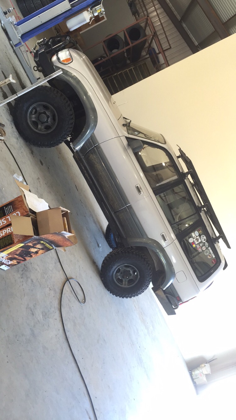

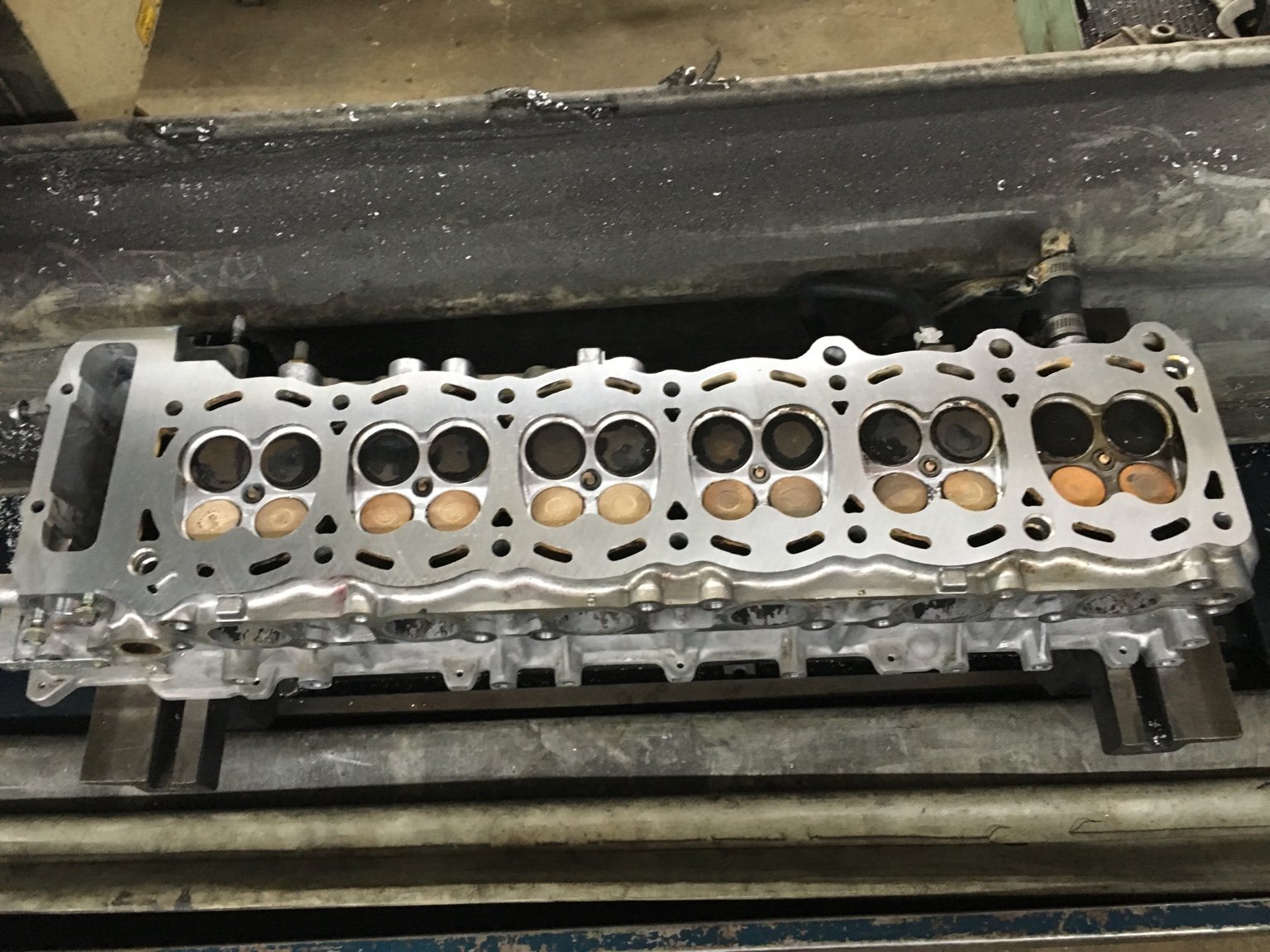

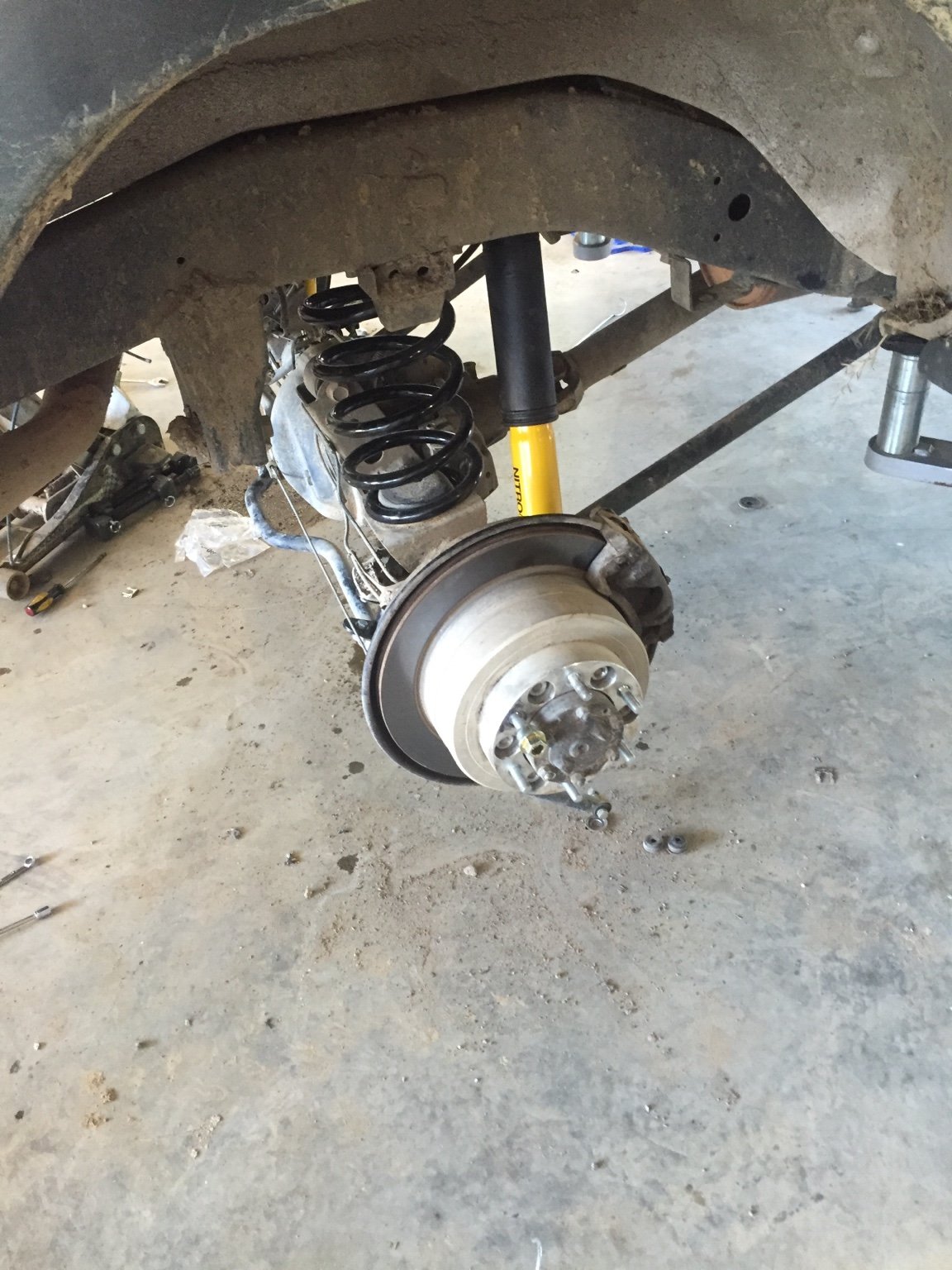

I was finally getting the 80 how I wanted it so next thing on the list was an ome 3 inch lift; or so I thought, the beginning of this calendar year I blew head gasket at 230k. This set back the lift install even though I already had the lift with me.
Although this was a huge setback we got her back running and it was time for the lift and tires. A couple weeks ago I finally got caught up

@wemahfouz What did you build that roof rack out of? It looks like an ATV ramp reinforced and modified with roof rail brackets. If so, what a great idea.
wemahfouz
455
Yeah, just an eBay 4 wheeler ramp. I liked the size but didn't like the spacing lengthways on the ramp, so I got some 3/8 steel flatbar (3/8 was the hight of the seem in the middle and edge of the rack) drilled some holes to match up every horizontal bar and secured it with rivets. The rivets hole great and I love the rack. There is a better build on line under "j-moose roof rack"

This one? http://www.wildyoats.com/the_j-rack.htm
wemahfouz
455
Yup. I didn't do the flatbar around the sides, didn't feel necessary. It's more for ascetics, can't go wrong with the rack tho if you're looking for something cheep. Cost me less than 300 if I'm not mistaken (already had the gutter mounts tho)
