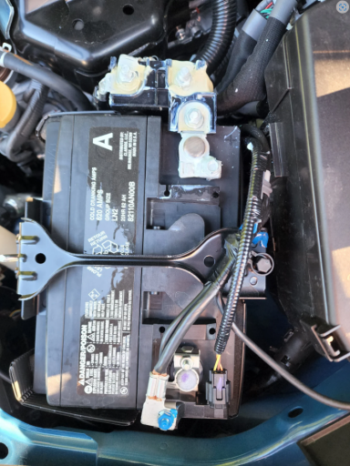

Good to hear, thanks for the help. Now just a matter of finding a spot on this batterie's positive terminal to drop a cable to. Subaru already has a mess with 5 million things attached and a sensor for the alternator charging on the negative terminal to consider. Fun times...

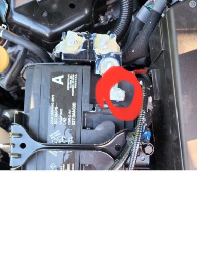

Ground to the frame, not the battery.
Add your positive accessory leads to the bolt I have circled in the picture below.

Yeah, grounding to the frame is the plan, what Subaru told me was that even if I do that, the smart charging for the alternator, the load will still get accounted for. Just in case though, I bought a wireless monitoring device for the battery; last thing I want to do is hit the road for 3 weeks here soon and be in the middle of nowhere with a dead battery.
