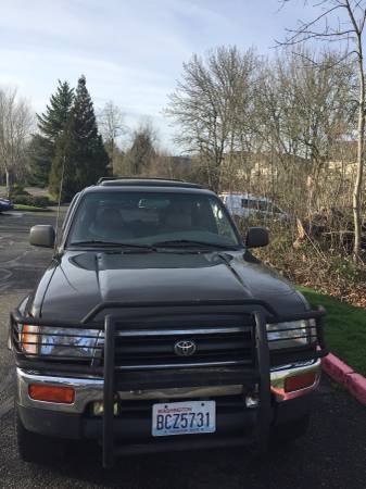

KRose
Benefactor
1,341
La Grande, OR, USA
Kallie
Rose
22599
This is the one @Slimpartywagon says might be the one. I’m showing these pictures from the guy that has it is is all I have of pictures till we go look at it but @Smileyshaun and @Chadlyb i don’t know if by looking at the pictures you can tell if I has the crossover or not
