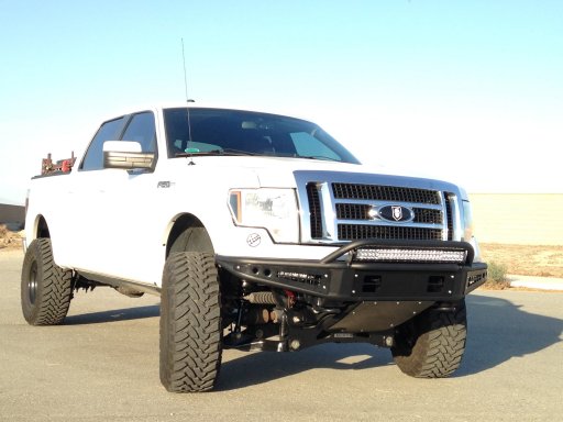

Just lift specs, add ons. That kind of stuff. You say you outfitted it with just 4K on the clock. I was just curious what all you changed.
I started with a “6 Fabtech then upgraded to the Dirt Logic struts and shocks later. The truck drove great with the basic system, but the DL upgrades were very noticeable. Volant intake, Edge programmerI couldn’t find a front bumper I liked but the A.D.D. ones were the closest. I was able to talk them into combining two types of bumpers which came out pretty clean IMO. Also, I like original stuff so it doesn’t look like a catalog build.
The only problem is the style bumpers I like aren’t the best for winches. I modified a front hitch receiver to clear the ADD skid plate and plasma’d a hole in the plate to clear the receiver (not pictured). Also rack leads to the rear so I can mount the winch to the back too. The bed rack is an old ConFerr (Defender bought them out in the ‘90’s and I think Smittybilt owns Defender now).

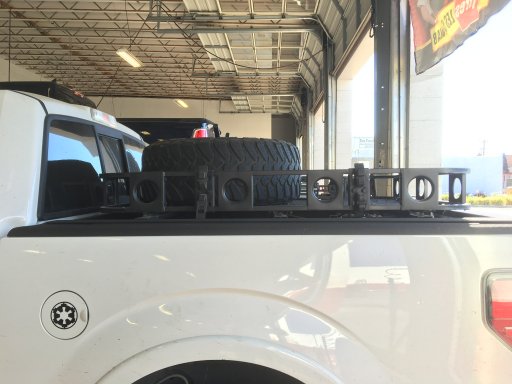

Bed racks weren’t really a thing 9 years ago so I’ll I did was Line-X some angle iron (as well as the bed). Bolted them from the side so it was clean on top. Defender still makes ConFerr’s hinged roof rack mount for gutter less rigs. These worked good because the would fold out of the way when I take the rack out. I put some LED pods on the rack for backup lights since the OE ones are horrible on the trail.
I put LED lights under the rails with a water proof toggle in the bed. I found an old fender Jerry can mount in a junk yard and mounted it inside the passenger rear to the bed so I could pack a 5 gallon water jug.
One random upgrade that has saved my ass was a bed mat. Kinda redundant with a Line-X’d bed but we sold 3/4” thick mats made out of ground rubber at my previous place of work. They’re great to lay on the ground for an improvised campsite but the best thing was I was able to lay it under my downhill side rear tire and drive over it when I got just a little to far off the trail.
There’s a bunch of other stuff that’s not coming to mind at the moment but that’s the big stuff

Love the ITS Tactical emblem! Bumper looks great!
