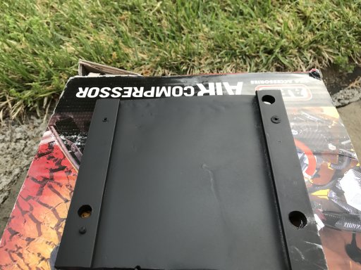

One more vote for the ARB single compressor. Works great for me. Had to make a bracket to install, but they do sell them and I am just cheap and want to do it myself. Bracket made for front passenger side of T4R.IMG_0002.JPG

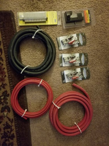

I have entirely too many projects for my landcruiser! Have to do some electrical work before I wire this in.
By going with bigger compressors, you get more output, but you gotta spend more to make it happen.
+1 for ARB, just finished the install about 2 hours ago. I wanted something clean and out of the way so under the hood was the best option, plus I have ARB lockers so that ruled out a portable solution.
