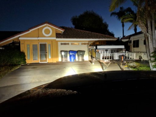

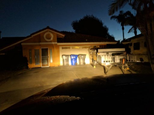

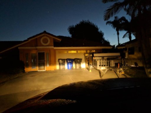

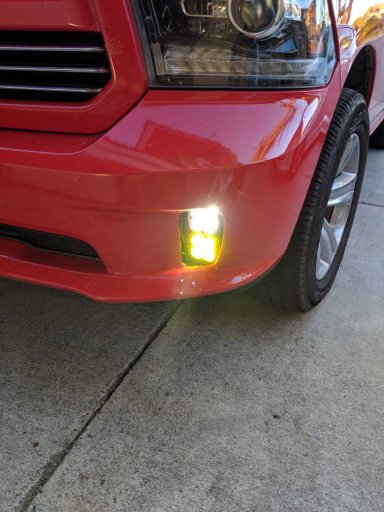

    I have recently mounted Baja design squads in my fog light location. They are by far better than even my high beams. I do plan to mount some ditch lights on the hood. I am not a huge fan of roof mount lights, they are great for the light itself but just do not like the look. Very pleased with the out come, I have floods with Amber covers on bottom and spots on top. Pictures are not great but give an idea between low beam, high beams and then with pods on. IMG_20180915_193129.jpeg IMG_20180915_193133.jpeg IMG_20180915_193144.jpeg IMG_20180917_182400.jpeg

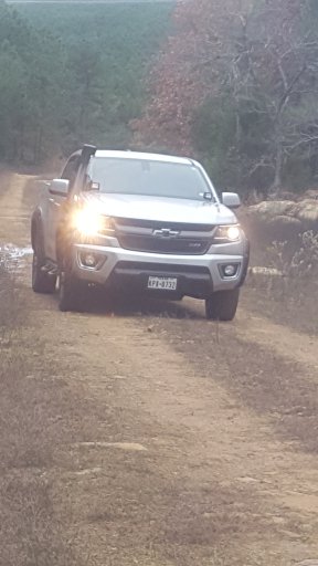

    I went ahead and did 2 70watt led ditch lights last night

  8. Boostpowered

    What mounting brackets did you use? I may do this for side lighting

    I took some 1 inch aluminum bar stock and beat it into shape with a hammer, i then put 2, 8mm nut rivets into each side of the hood to bolt the brackets to. I didn't like the way the brackets on the market use hinge bolts and didn't want to pay 150 for a pair. my brackets line up with the inside edge of the hood hinge.

    There are 2, 35° bends and 1, 90° bend
    madcratebuilder likes this.

    That setup should definitely make a big difference for you. You’ll be asking yourself why you didn’t do it sooner for sure. Looks good too!

    Im not super impressed with the light output, they do great for side lighting on trail but if you expect ditch lights to light up the road out front more than the headlight on a colorado, They dont. if pointed forward most of the light is reflected of the hood back into your eyes. So my review is that if you get them for off road side/ditch lighting they are real helpful but on road they are about useless as driving/fog lights. Due to being up high on hood they are illegal to use as driving lights on the road.
