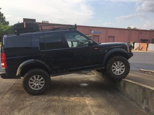

How have the 35’s treated you? Did you add spacers to keep from being DOA with a suspension fault? Bump stop/no roll has me a little intimidated from going larger than the 265/70/18’s (33ish) I currently run.
SYA to take care of the suspension fault. Spacers you have to have to clear the ball joint.

No problems running the SYA kit? I’ve heard they can throw codes of their own. Maybe that’s been sorted, it’s been awhile since I’ve read up on it.
