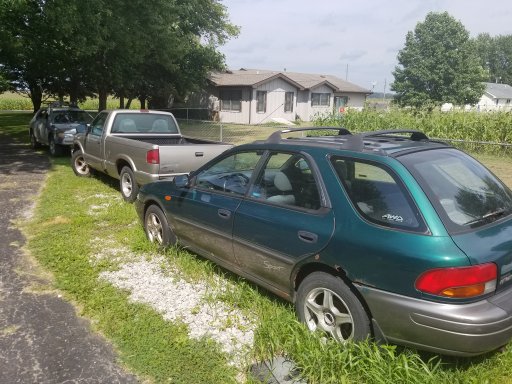

now that I've had time to work some of the kinks out of my rig, I figure it's time to make a build thread. This isn't my first subaru build, but decided to go auto with this one. Having the auto tranny has helped considerably allow my small, under torque engine get me over hills and obstacles I couldn't in my previous manual rig. I started off with a 99 Subaru Impreza Outback Sport with 100k miles for $650. 21013932_10214507151576593_7461563167126782795_o.jpg
My previous rig (the Warback) is in the background.20989303_10214507155536692_5026346757772728633_o.jpg

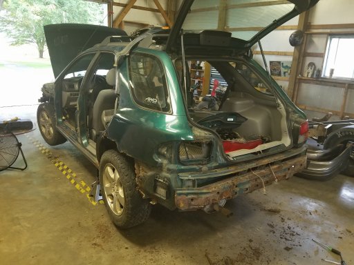

Car ran very rough and hadn't been driven in a few years. There was considerable amounts of rust on the undercarriage, but the unibody was solid. So then I got to work tearing everything apart to see what was needed. Note that there was no front steel bumper underneath the cover when I removed it.21083474_10214507158856775_8361222901015707950_o.jpg 21056198_10214507160336812_525750565070608311_o.jpg

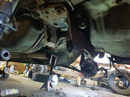

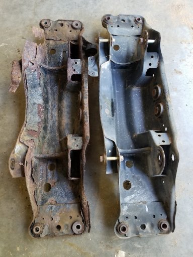

Rear subframe was rotted much more than I originally thought. Everything else was workable. Decided to see just how cheap I could keep this build to help encourage others interested in building a Subaru. Off to the salvage yard I ran and picked up these parts: 99 Forester rear subframe $75, 98-02 Forester front struts $60, 98-02 Forester rear trailing arm bracket $10, 03-08 Forester Rear struts $60, 98-02 Forester front lower control arm bushings $25.

Rear subframe took the longest. here's tear down, comparison, and installed with a coating of bedliner. Gas mask was the only way to keep all the rust out of my eyes and mouth 21740777_10214715948356382_6707296391262837202_o.jpg 21743436_10214715949956422_4850846582979844122_o.jpg 21741041_10214715954436534_4507903302442146290_o.jpg 21740978_10214715963956772_4996627703515649697_o.jpg
