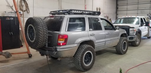

Been a while but latest up date is I got some suspension work done on the front end. Added new adjustable upper and lower CA's from Iron Rock Offroad, 3/4" leveling spacers, Rubicon express quick disconnects and some bushings. My reasoning for the the CA's was two fold, push the axle ahead for more clearance after moving up to 33's and adjust the caster angle. I didn't really want to run leveling spacers but after the bumper and winch I was suffering from some nose sag. And the Discos were just for fun.
The CA's went on easy enough and seem plenty stout, I went with the ones that have rubber bushing as opposed to the johnny joints. The rubber provides better insulation against vibration and jarring hits on rough terrain and since this isn't a full on trail rig I went for better ride quality over flex (for now). When installing them I just took a guess at where I wanted to be for length and went with 1" over stock length top and bottom. Turns out 1" might be a little too much, I now have plenty of clearance at the rear of the fender but rubbing in the front when disconnected at full lock. The front of the diff cover is also mighty close to contacting the track bar when flexed hard. My plan is to pull them back 1/2" then recheck and adjust again if needed. I set my caster at about 5.5 degrees and it seems to help with road manners, I was excited to get the parts installed and forgot to check what caster was before.
I ordered all my parts from Kolak, he suggested the Rubicon Express discos telling me they are the exact same as the JKS but cheaper so who was I to argue with saving some money. Again with these I went 1" over stock length trying to get the sway bar back closer to original angle. Now with the front disconnected it flexes great and I think once I play with adjusting the CA's the 33's will be awesome. I will however need to add some bump stop extensions, but I'll have to get the CA's dialed in first then hopefully only need 2-3" of extension. As for the rear sway bar I'm on the fence if I will keep the Addco HD on it or go back to the stock or come up with some type of disconnect for it. If you look at the above picture you can see how far from the fender the rear tire is, with the stock bar it would tuck the tire about an inch into the fender which is a difference of at least 3". The addco really helps to tighten up the handling on the highway, but I'm not sure how much of that was due to too little caster before. I might throw the stock sway bar on sometime to see what it does with the caster back in spec, but for now I will just get the CA's dialed in and run disconnected which will be fine for most of what I'll be doing.

I have to stick around the farm this afternoon and be here Tomorrow but don't really have much to do so I'm gonna try to knock out a quick tire carrier swing out. Won't be anything special or too nice but something to get the tire off the roof until I build a rear bumper
Reactions: M Rose
That's as far as I got today, doesn't look like much but there is more under the bumper skin. That will be the mount for the hinge and lock. Just need to build the swing arm tomorrow, I'll probably add some type of mount for a high lift and a place to put water/gas can.

Thank you, it will also fit one of those 5 gal cube water containers if I don't need to bring fuel along. I did kind of screw up though, I should have put the hinge and tire on the drivers side so I could still kind of see out the back window.
