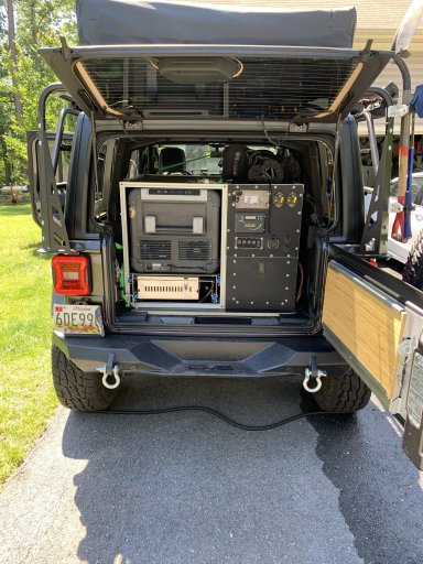

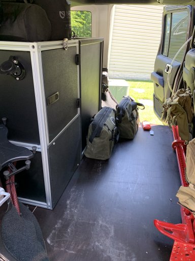

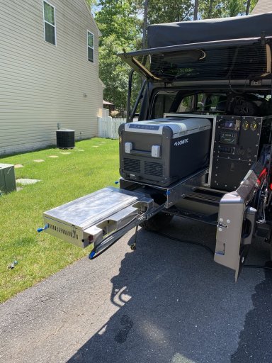

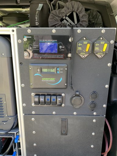

Wanted to share this as I saw someone brought up 8020. I used their stuff for my rear build out. Looked at goose gear, but way too much money for what I felt like I was getting. Plus their kit wouldn’t allow the fridge size I wanted. Running a Dometic 95. Plus I used one of the boxes for storing my rear power. 8020 has some really good stuff. Extrusions are cheap, connectors not so much. But love that it is modular, and I can change it up later.

Nice job on the 80/20 build!
Thank you. Their equipment made it easy. I am actually working on my solar panel mount for the roof rack using their stuff. Won’t to be able to lay it down when traveling and angle it up once I get to camp. I’ll add pictures on my build thread as I get that done.

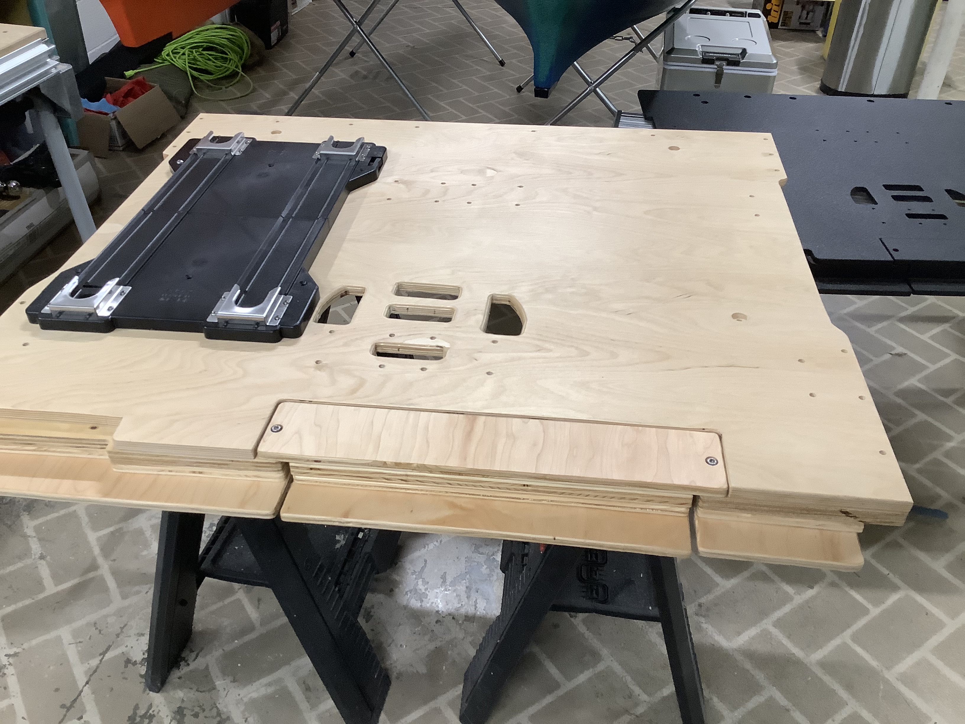

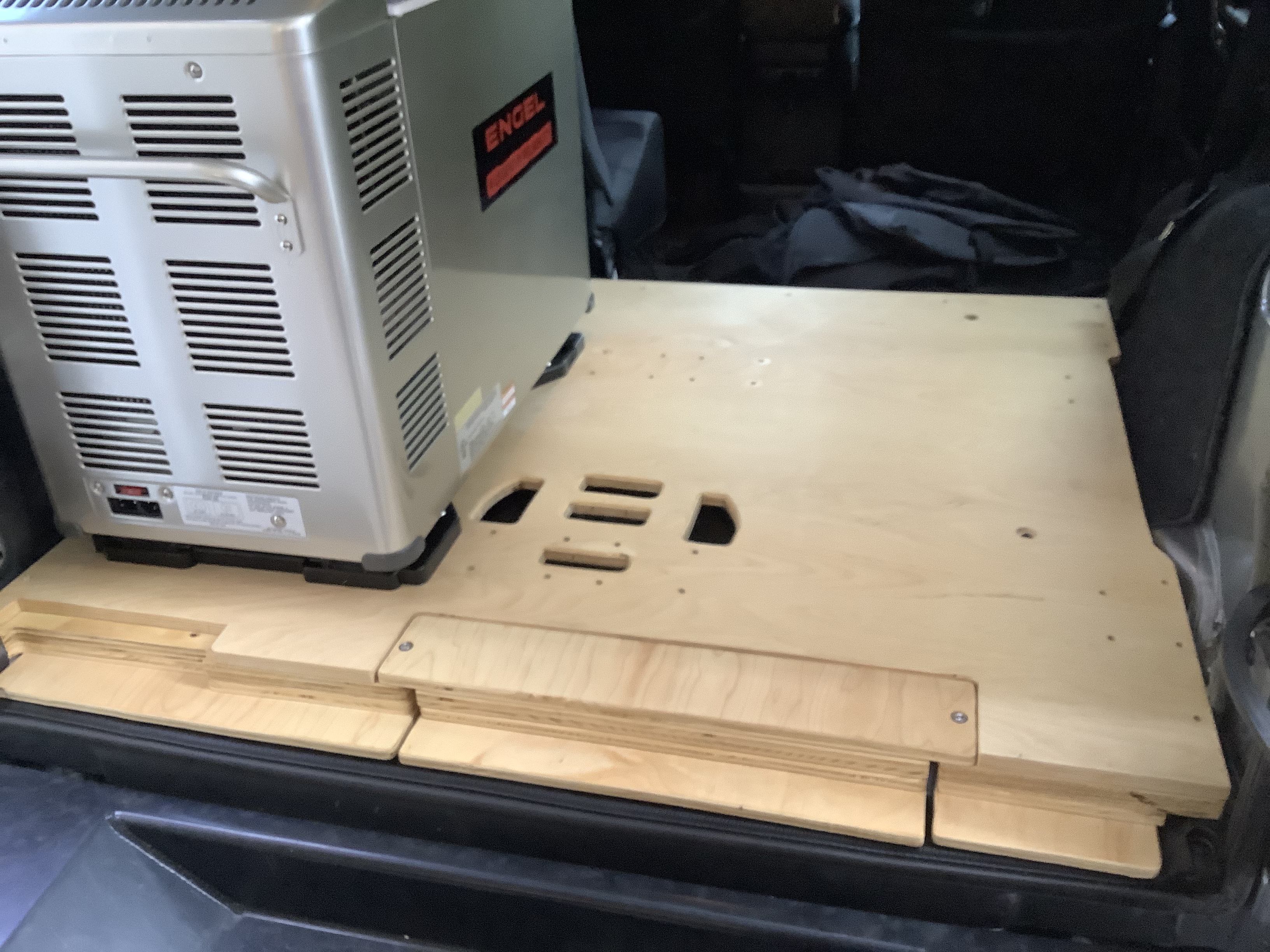

I ended up building the base plate for my Jeep. Took one sheet of plywood and about 6 hours carefully measuring, making templates and cutting.
I did have to fabricate a front mount, but that was relatively straight forward, but someone would need a welder to make what I did.

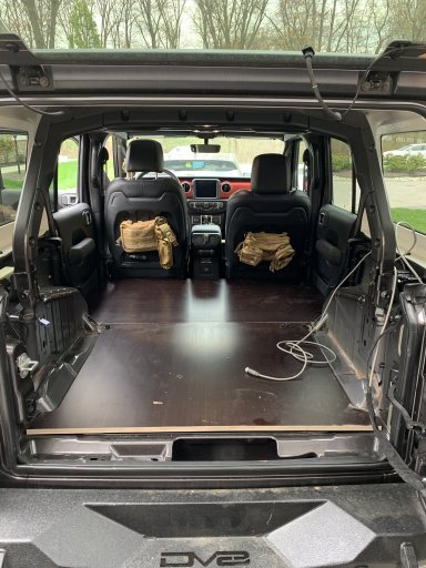

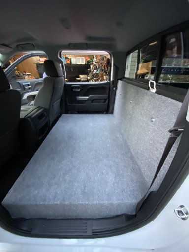

Pulled the trigger on a full plate system "rear seat delete" for our JKU. I debated about this for a very long time due to the cost, I have a fairly thorough wood shop but there is no way I could match the fit and finish of this product.
Here is the main downside of the product.
There are NO directions that come with the system!!! I had no problem figuring it out using a little youtube education but what a TIME SUCK putting enough information together to figure out how it went together and then how it was installed.
Would I do it again? Yes definitely due to the quality.

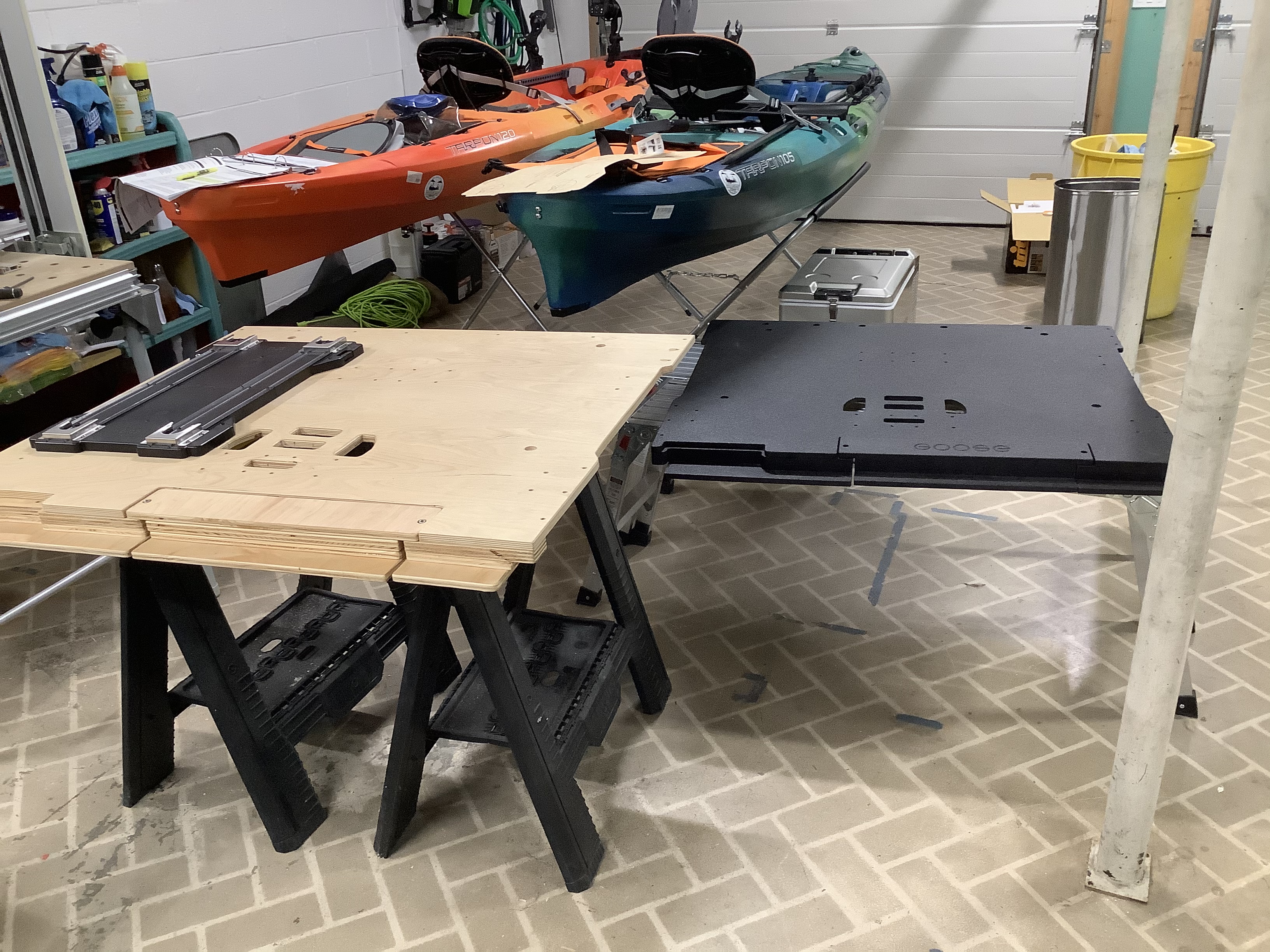

I bought the Goose Gear Plate for the JKU.
Totally worth it.
Great product.
However after appreciating their craftsmenship it challenged me to make one myself as a learning experience.
I have spent more in tools now than it would have cost me to install their entire system.
Including their camp kitchen and a fridge.
Tools purchased (some with 0 interest financing)
Rikon 14" Band Saw with Striatech Smart Motor
Nova Voyager 18" Drill Press
Metabo 18g Staple Gun
Grex 23g Pin Nailer
Rikon Spindle Sander
Countless other items considered woodworking accessories (drill bits, drill press laser, clamps, router bits, DP fence, etc.)
Not even counting material.
Probably $6000 in tools alone if I had to guess.
This was all to make 1 board. lol. Totally irrational I know.
So if you consider the cost if you are tool-less.
It is worth it.
