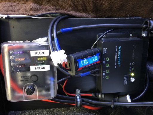

You will have to use a solar charge controller for charging the batteries. I am using the ones from Victron Energy in 2 rigs.
And still it depends on what you plan it to use for.
If it was my post that confused you please forgive me ;). My english lessons were a long time ago.
John, the harbor freight 100w kit comes with the solar charger. The instructions tell me all I need is an inverter and a battery to complete the circuit and have electricity. I plan for longer stays than most people when I go off grid so I purchased 2- 1000w - 27 series deep cycle marine batteries. Now I need the inverter but they didn't give me a clue as to what size inverter I need to complete my package. I listed in another post what equipment I plan to use. The video posted on the inverter seems to indicate I can run just about anything on a 750w sine inverter adequately. Your English is fine for me. I can speak no other language so I am always impressed if someone speaks more than one language, that's cool. Thank you for your input, I feel the OB people will guide me in the right direction since most have far more experience than I.

Will was my main inspiration for my solar build out in my truck. Wealth of knowledge for a young guy.
This is the site I watched. It is for beginners like me. Everything is clear and understandable. I learned a few things I was not aware of besides the inverter. For those who are thinking of doing something similar, here is the site.
This is his video that I based my build off of.
