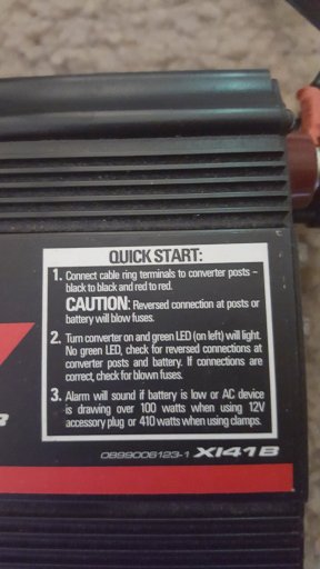

This is the inverter I plan to buy. My 2 batteries are not connected to the car so the solar will connect directly to the batteries I'm guessing. I'm even more confused by some of the answers I am getting. Here is the converter and a video supplied by Harbor freight.

You will have to use a solar charge controller for charging the batteries. I am using the ones from Victron Energy in 2 rigs.
