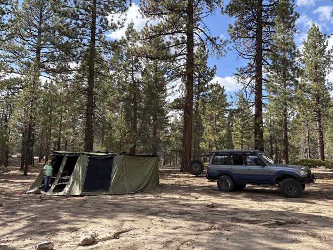

The batwing was one of the best mods I did to the trailer. If you don't have them, get the walls. I have the 23zero. Between a few of us, if its real cold or raining, those become the hang out spots. I've had about a dozen people with two small propane fire pits and a couple tables of food hide out there when our pot luck got rained on. Also, you can walk around the back and straight into the bathroom/shower without having to go outside in the weather. I haven't gone as far as bringing a roll of outdoor carpet but its close.
Here's a poor picture while we were setting up. Cant see the trailer behind it..
