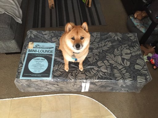

after looking around online and having a hard time figuring out what mattress to go with (most had mixed reviews), i found out about a local guy that makes his own folding foam mattresses and sells them at the swap meet. i contacted him and was able to stop by his place to pick up a mattress during the week and it was cool to see his set up in his garage. he truly does make the covers and cuts the foam to fit. the reviews i did see were all pretty good with people mentioning that they've had their mattresses for years.
with this mattress, i'm now looking at making a sliding platform bed that i can remove if needed. i think it would be nice if i get stuck in the trailer for a rainy day to where i can have more of a couch than just a bed.
That's how I made mine. The platform has slots in it so I can slide the frame in and out. The second mattress will be stuck to the wall with velcro as a back rest. Now I have a bed/couch. When I'm by myself, the second half will stay in the garage. Even though I designed it like that, I haven't built the second part or bought the other mattress. Part of the reason is, I need someone to sew a custom cover or finally break down and buy an industrial sewing machine (which I actually need).

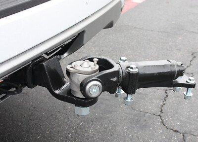

something i'm considering is this coupling to use and get rid of the ball hitch set up. i like the lock and roll hitch, but its a little on the pricey end.

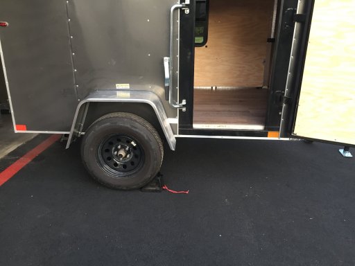

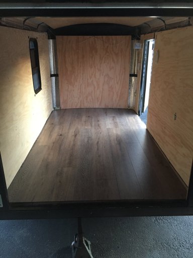

i've been pretty busy with work the last couple months, so the trailer has been less of a priority until now. i'm getting things ready for a trip from SoCal to Montana to visit family and i just got a couple things to work on for now.
first, my neighbor does flooring and he told me before a couple months back that if he had left over flooring, he'd hook me up. last week he gave me 3 boxes of the vinyl slat flooring that looks like hardwood. should be plenty to get the floor done in the trailer and it will look nice. one thing i was missing from my tools was a circular saw, so i ordered a milwaukee kit with a circular saw. will come in handy to do the floor trim along the walls to give a finished look to the floor.
before i do the floor though, i need to open up the walls again to get access in for the fender bolts. i want to raise up the fenders a little more to give a little better clearance for tires and i picked up some 1 inch steel box tube to run across the wall to anchor into. I did this for the window to give it a little support from the bottom and strengthen up the "chassis" a little bit.
i have a friend that offered me some jeep wheels with tires to run on the trailer for $50, but after looking up info on spacers and how they work with trailer hubs, it sounds like the 2.25-2.5" spacers i'd need to make the wheels work with the hubs and clear the trailer, it doesn't sound like the route i want to go. i'm currently looking for some 15" trailer wheels, then i want to pick up some car or truck tires to toss on there. still looking around for some good used tires, but 15" is becoming harder to come by on the used market. may just have to do new tires and suck it up. i'd love to get some all terrains (doesn't matter the brand) so that i can worry less about durability of the tires.
pics and progress updates soon to come.
socal geek guy
1,116
San Diego, CA, USA
Walker
19531

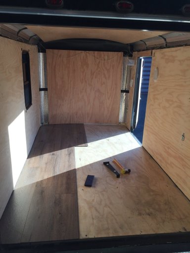

got a decent amount of things done this weekend, lots of little things and some semi bigger. i got some general grabber atx tires ordered and will go pick up some wheels either today or tomorrow so that i have some better tires. i wanted something with more durability and better speed ratings, so that's why i went with the all terrains as i don't have much faith in the regular cheap trailer tires that came with it.
i got the walls removed to trim the bottoms to make room for the flooring and i also to raise the fenders a little more. got the fenders raised and anchored in a little better so that they're more sturdy. sealed up the old holes and put a bead of silicone around where the fender meets the body. while i had the walls down, i put a better bead of silicone around the window on the inside. put the insulation back in and the wall panels, then started on the flooring. i got very lucky and the flooring that my neighbor gave to me worked great and it went way easier than i had anticipated.
if any of you end up using the vinyl plank flooring, it goes really easy using a circular saw with a fine finishing blade and a jigsaw if you need to do any curved cuts. you can clean up some of the cuts a little using a utility knife. i also recommend getting tools similar to these in an amazon link. the job went way smoother with these tools, especially with the metal bar to help tighten up the gaps on the ends of each plank. once again the jackery came in very handy to power the jigsaw and it had no problem giving enough power to cut through the planks.
i got lucky where there was a small enough gap on the last row where i can cover the gap with some trim for the floor boards around the bottom edges of the walls. i'll have to get nicer threshold plates on the entry ways to make it look nicer and anchor in the ends/side. i only used about half of the planks that i had on hand, so i have lots of extra to use if i have to replace any of the planks.
overall, i really like the look of the floor, its a lot nicer to crawl on while in the trailer and i can't stress how easy it was to install. now i need to figure out what i'm going to do with the walls. i'm still leaning towards carpet to have a soft surface to lean against, cut down on condensation, and act as sound deadening.

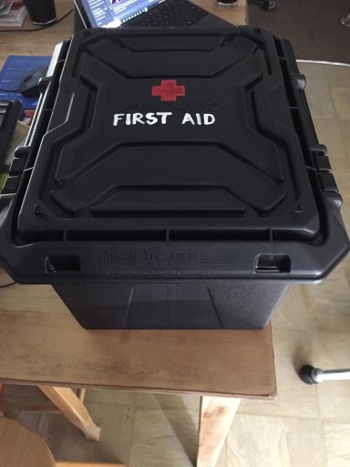

i also have my first aid kit mostly put together and it will stay in the trailer full time. i found a smallish plano sealed container for about $13 and i'm pretty happy with it. i wanted something fairly durable and water tight, so this will work well for this application.

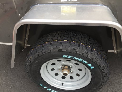

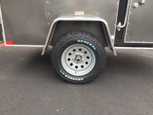

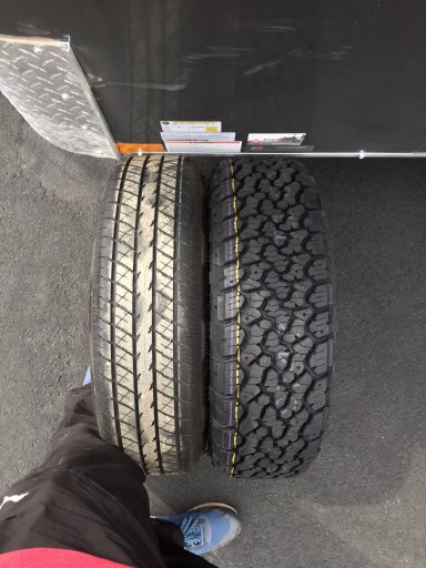

my tires finally arrived this morning after some issues with the shipping company, but tire rack was excellent with their customer service. they contacted the shipping company to have them figure out what happened on their end and also started processing a replacement order to send in case the shipping company couldn't get it together. tires were supposed to arrive yesterday and i stayed home minus a couple times to take the dog out to use the bathroom. tracking info said out for delivery even as i checked before going to bed at 11pm. this morning i checked and it said they were delivered. i guess the call from tire rack sorted it out and they dropped off the tires.
that being said, i got some liquid metal wheels from discount tire back on tuesday, so all i need to do is install them and i should be good to go. the tires look good and its interesting how close the tread patterns and side blocks that lead to the side walls mimic the bfg ko2's. having more durable tires and being able to keep the original wheels/tires inside the trailer as spares makes me feel more at ease on long trips or going on trails.
socal geek guy
1,116
San Diego, CA, USA
Walker
19531
got the tires on the new wheels and they're on the trailer. they're the same size as what was on there, and its funny how deceiving they are side by side new vs old. the old tires had more rounded off tread on the outer edges where the general grabbers have more squared off tread that goes further out to the sidewalls. when you look at them the grabbers look wider, but they actually are the same width. the new set up fits perfectly and looks good. the wheels are a little more grey than silver, but that's not a big deal.

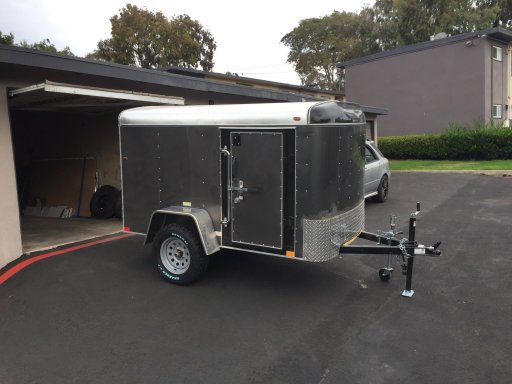

i brought the trailer with me on a trip from socal to montana to visit family and i will say that with good weight distribution and the new tires, the trailer really tows well. it was hot on the whole trip going north, but it wasn't too much for my suv and i was able to cruise down the interstate no problem. the drive up was pretty non stop, but on the way back i plan on stopping at least once at a national park (tbd) and camping in it with the finished floor and the finished insulation (the last trip i didn't have the ceiling done).
socal geek guy
1,116
San Diego, CA, USA
Walker
19531
the trip back home was long, but good. the trailer was great to have and got a lot of use for utility things while i was visiting family and i camped one night in washington east of monroe.

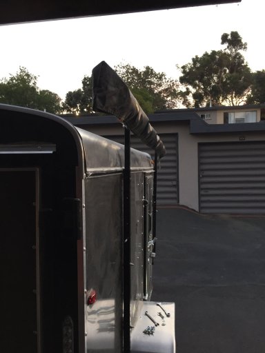

worked on the mounts for my awning last weekend and put some primer and paint on yesterday. i plan on putting a couple more coats of paint on today. i think these will work out nice as they feel very sturdy and i got the clearances i needed when lowered to get the trailer in the garage. it will be nice to lift it up higher when i get to camp since i'm taller.
