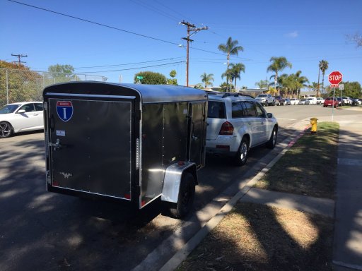

I picked up an Interstate Victory 5x8 enclosed trailer this past weekend and I'm excited to get started on this. After spending probably the better part of 2 years checking out different options and assessing if they would work for me, the last 6 months I came to the realization that an enclosed trailer would be the direction to go. I did make the deal with myself that if I was able to find a Nucamp Tag trailer for under $10k, or a tear drop that I really liked for around $5k, that I would primarily focus on an enclosed trailer. My thought process with the enclosed trailer is that if I can make it modular, I could use it for camping and if needed, remove the camping setup and utilize the trailer for moving stuff. I liked the idea of being able to use it for more than just camping, but it would primarily be used for camping. I don't plan on any gnarly off roading with the trailer, so it will be a semi mild build.
To be fair, this will be a slow build for a while. I want to use the trailer in a super basic setup to not only keep costs down initially, but also get used to the trailer and have time to figure out what features I would really use. Once I have better ideas of what all I want to add, then that gives me a starting point to work on designs to make it work well.

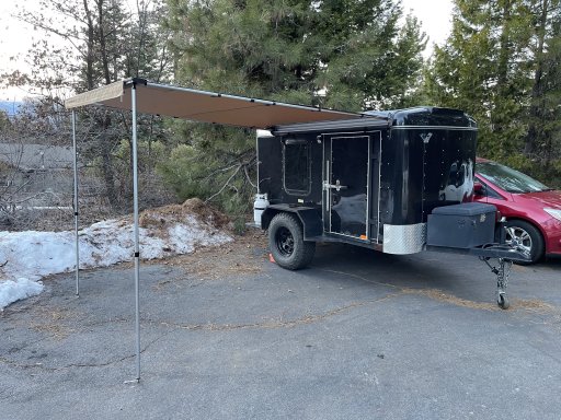

another thing i need to work on is how to mount my awning to the trailer, but keeping it even with or slightly lower than the roof line so that it clears the garage door.

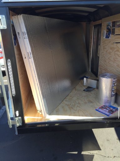

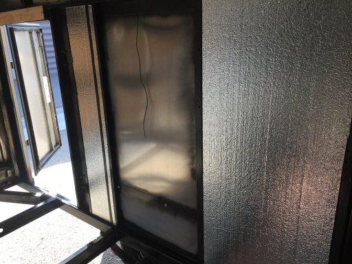

picked up some of the r tech white foam board insulation from home depot today to get started on insulating the walls of the trailer. had to use the trailer to get the 4' x 8' sheets and it worked out pretty nice. i also got to use the new trailer light adapter (my suv has a 7 pin plug, trailer has a 4 pin). the one i got when i picked up the trailer did not want to play well with the suv and the trailer led lights. the one i ordered online was made to get the two to work and i was happy to see that it actually made the lights operate correctly. here's the link if anyone is interested.

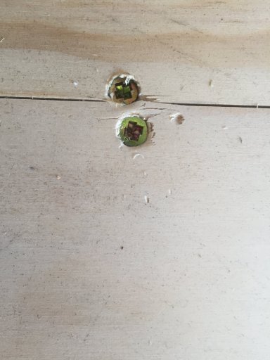

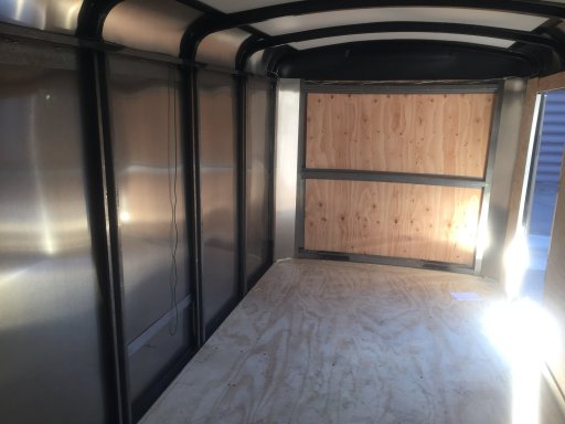

started pulling out the plywood walls in order to put in the insulation sheets, also looking to pull up the floor. they used philips head screws for the walls, but used LOX head screws for the flooring. i'd never heard of LOX before, so it took me about 30 minutes of searching the interwebz to find the name of the strange screw heads. i ordered some LOX bits online since they were not readily available in my area.

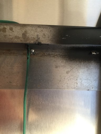

with the walls opened up, i started finding some issues i need to take care of before putting things back together. one is the wiring, which is pretty crappy in my opinion. for example, they just drilled a hole through the sheet metal for the wiring feeding the lights on the fenders. no grommet or sealant used, so i want to do something better where i don't have to worry about vibrations cutting the wire sheath and shorting out all the lights. looks like the lights are mostly in series, so i may look at better options. i did order some protective sheathing to go over the wires and it will show up with the LOX bits.
i'm also seeing some gaps with daylight between the frame and sheet metal exterior skin. i already picked up some caulk to seal up those small gaps.
i did notice the fenders are just screwed into the exterior skin, so i'm going to work on secure mounts on the inside for the fenders.

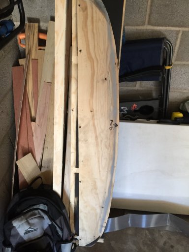

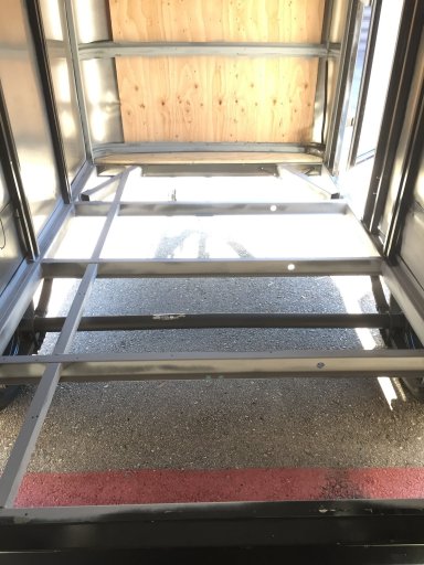

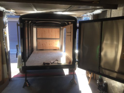

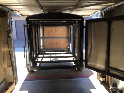

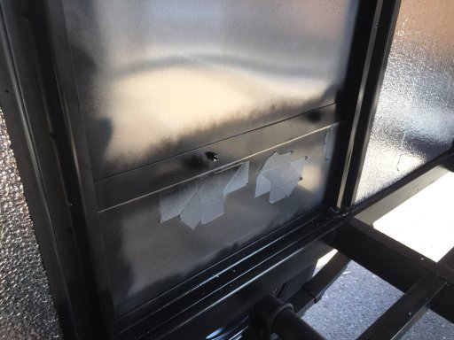

floor is out, started going over the bare metal with primer and spray paint. need to cut a new piece of wood for the front of the trailer to actually seal up where the floor meets the front end cap.

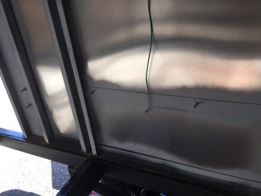

in one picture you can see where they actually got the self tapping screws in the cross bar to hold the fender on. in another picture you can see that they were way off.

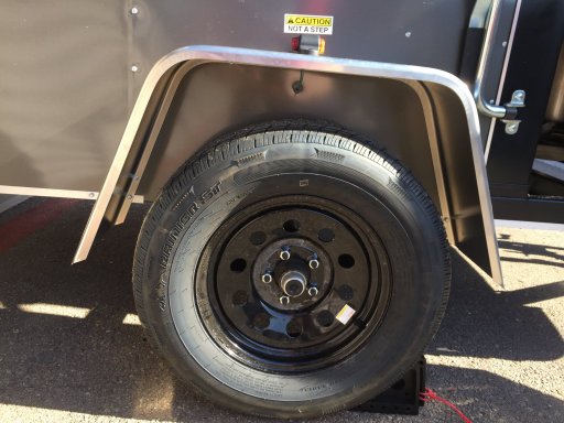

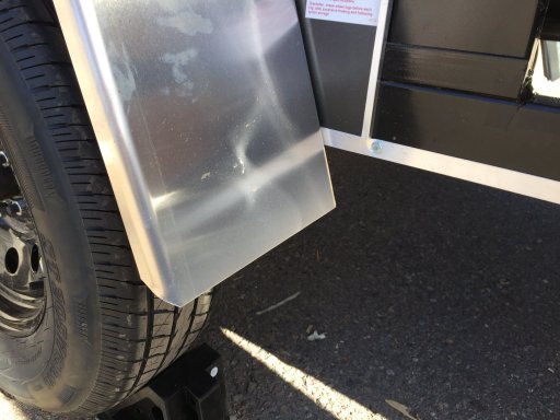

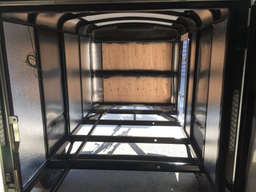

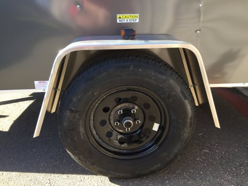

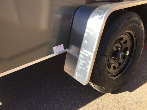

got a coat of paint on the frame and wall beams. also took a closer look at the fenders while the trailer was out of the garage. so the left side is for sure installed way too low. it's about 4 inches lower than the right side. the right side is where the fender height should be, so i'll be pulling the left off and moving it up to the correct height. in the pictures you can see the obvious tire gap difference. also, the fender on the left extends about 6.5 inches lower than the frame. on the right side, the fender only extends lower than the frame by about 3 inches. the first two pics are the left side, the 3rd and 4th are the right side.
i'm also contemplating taking out the fender lights and eliminating the wiring to simplify things. i just need to see if they are mandatory to have.

got the low fender moved up and changed the self tapping screws out for nuts and bolts on both sides yesterday. started getting the insulation panels cut to fit as well, gonna pick up where i left off a little later.
i looked at the wiring for all the lights, and ultimately, i'm going to re-do all the wiring to get rid of the daisy chain mess. for now it will stay as it is until i can map it out and then get the supplies i need.
i'd like to figure out a better way to seal up the holes from the original fender mounting, but for now i just used duct tape to at leas block anything from coming in. i'm thinking of getting either some other sheet metal or a better metal plate to cover the holes with adhesive on the back to seal from water/dust, and maybe rivet it to the exterior skin. definitely something i'll come back to. i want to get it back to road worthy for a camping trip in a couple weeks.

Seal the holes with Silicone not caulk, the caulk will shrink and expand with temp. you will not be able to paint it however.
They daisy chain the light because of cost, you are right to replace with more circuits and a TB board with fuses.
