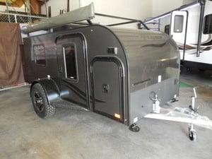

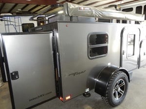

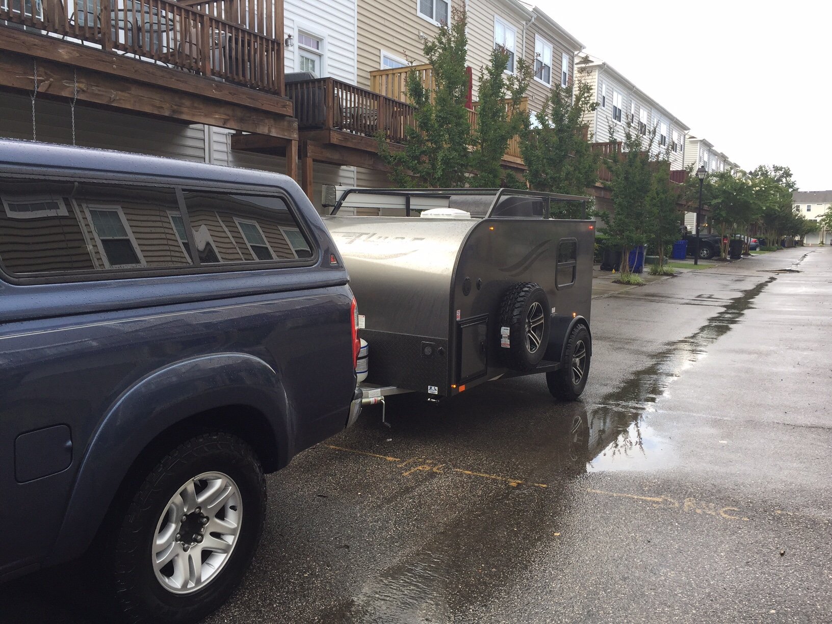

Well, the wife and I were looking into purchasing a travel trailer in the 16 foot range. After we looked at a few we decided they were to big and with more amenities then we really wanted. So the search for a teardrop or expedition trailer began. After doing a few searches we realized 75% of expedition trailers were out of our price range and most teardrops were not big enough for our family of 3 and a dog. So after doing a search of a local dealer we found this:

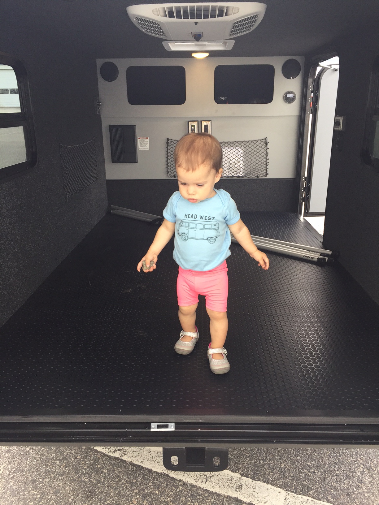

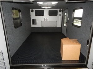

They are made by InTech Rv out of Indiana. All aluminum tube frame, dometic fridge, 2 burner stove, stereo inside, and a Foxwing awning. The interior area is 60" wide and 98" long and the roof rack is strong enough for a roof top tent (an add on option from the factory if wanted).
Website:
http://www.intechrv.com/max.php
So after doing some research on these we ended up putting a deposit down on the model pictured and we get to pick it up on Saturday!
I will post some more pictures when we pick it up and some action shots. This will be my build thread for the many modifications to follow.

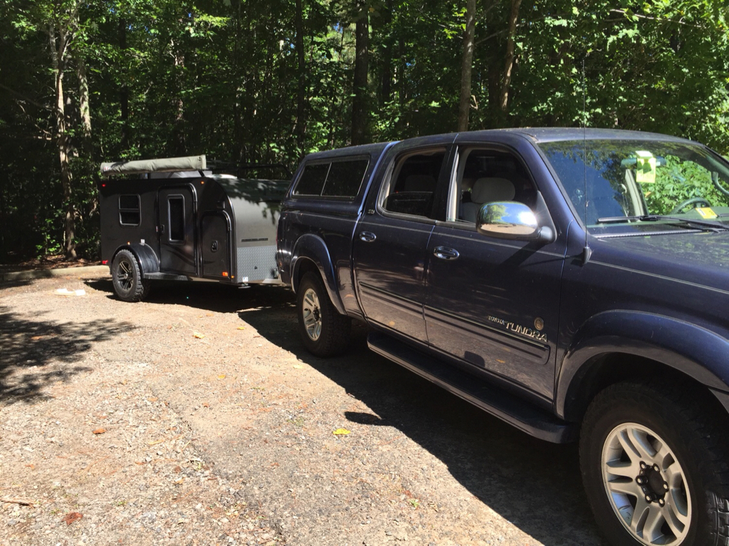

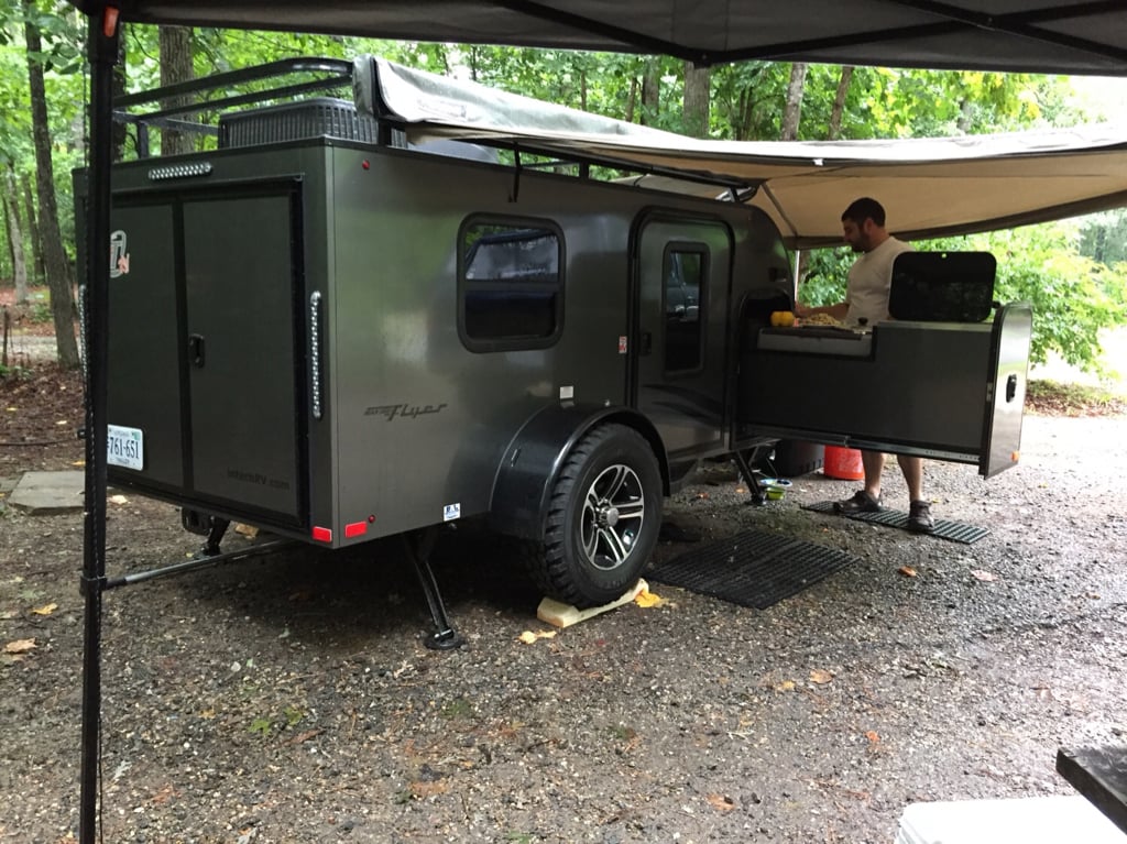

Here’s a bit of an update on the trailer.
We have used it a handful of times and we are enjoying it a lot. There is a few things we would like to do in the near future though. We want to install a 200w solar system with a bigger battery, some more storage on the exterior, and we also are looking into a rooftop tent for more sleeping space for guests.
A few pictures in action-

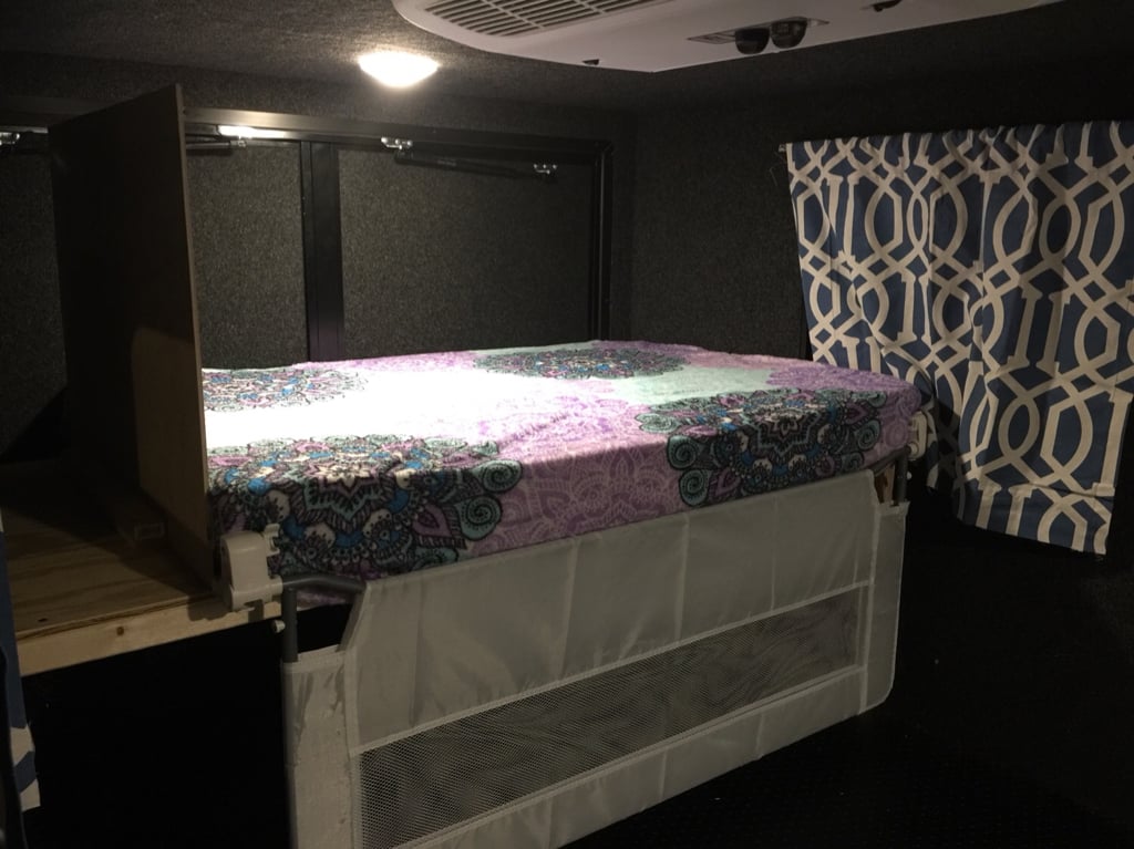

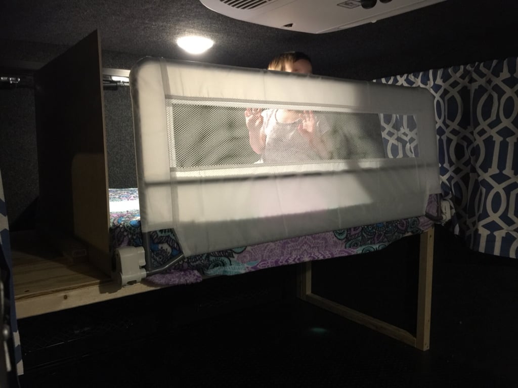

We also needed a better sleeping solution for our daughter. So I built a bunk bed with flip up side so she doesn’t roll out in her sleep.

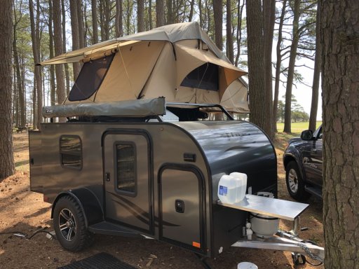

Well here is a bit of an update. I haven’t added any modifications to the trailer lately. I did purchase a Tuff Stuff Elite model RTT for the trailer. I was looking for a little more sleeping space for the family so the tent was a great option. We went out camping this past weekend and everything worked great! Love the RTTIMG_0413.JPGIMG_0411.JPG

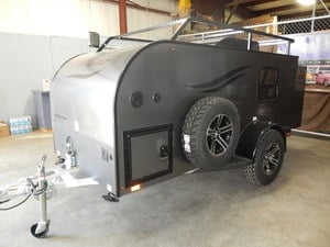

We are picking up our Pursue Flyer this coming Saturday... I already have a few mods in mind
Tounge box w/rotopax
Rear Landings.
Tires & Rims to match my 4Runner... I may need to swap out the hubs to accomplish this.
Add my Tepui RTT & Foxwing Awning
Add Solar
Use it a bit to determine where & what additional storage should be add.
Brackets to the roof rack to hang a shower curtain.
Maybe replace the roof rack with 1x1 tube.

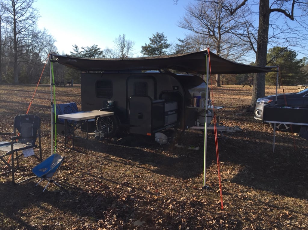

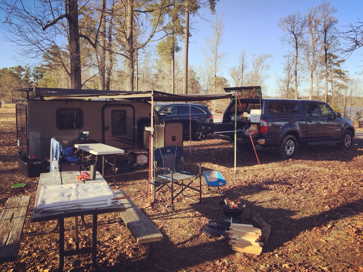

We have posted some of these in the owners group, but here are some mods that we have done
XO Trailer jack
Front wind fairing that doubles as camp table. made from HPDE
Norther tool sprayer on roof. 16 gal. Power from the solar 12v port for water on demand. Also have an ecotemp L5 for heating water

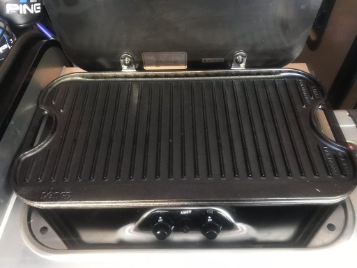

Fold out sink/cutting board added to table. The lodge cast iron griddle fits perfectly on the two burners
Truck box cargo carrier. Used Rola swing out, then added two arms for stability. The system is removable, just like three tongue and receivers. This also moves some of the weight off of the tongue of the trailer
Rhino Base Tent and 2.5M awning. ARB awning for rear of trailer

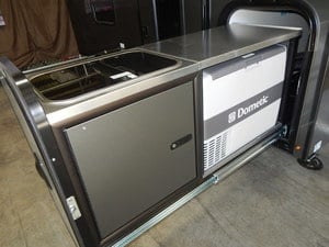

For our use, wind hasn’t been an issue with the stove. There is someone on the intech owners Zuckbook group who is selling a custom windbreak for it. The 12v/120v fridge has served its purpose. we usually use that for food and have a separate arrangement for bevs. No, it’s not an arb, but run time of course depends on the battery which is handled by the rv dealer, not intech and can be upgraded.
the slide out kitchen has been great in terms of time saving when compared to our old folding camp kitchen (stove, propane, utensils, cookware, etc). Like many, we are overcampers, so the less time with set up and take down, the better, while still having the comforts.
The “pursue”/kitchen model is heavy on the hitch; something to consider w the tow vehicle.
