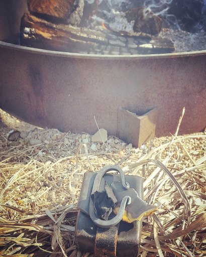

They are eager to learn. I have been thinking about making a video on various fire making methods and tinders.
This is from this past weekend...there are some of us who know the skills. Shot some video to edit down into a blog video in the future of the process too. This is what I posted on Instagram while I was in camp.
With our group was a Aussie ex-pat that we taught how to use the flint and steel, as well as a rod and he even attempted a bow friction start (the first two were successful).
