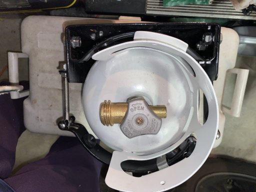

My fire extinguisher, er propane tank, bracket arrived today. A little bit of fiddling and it’ll latch right up.
What exactly did you have to fiddle? I'm looking at getting that same bracket as I don't wanna shell out over $100 for Powertank or Front Runner but wanna be sure it will actually latch up with my 5# flame king bottle in it
I had to adjust the retention strap. I still need to mount it.
Awesome, thank you for the pics! It seem to hold it pretty securely? I'm going to be mounting mine to my roof rack, don't want it taking any unwanted trips down the trail lol.
Sorry to bug you on this one again, I just got my bracket in and my tank won't fit inside at all, did you have to somehow bend out the sides? From your pics it looks like your tank sits all the way in and touches the rubber bumpers on the back wall, mine hits the sides and sits probably 2" or so away and the retention strap won't adjust out far enough to latch at that point :triumph: lol
My tank is right at 8” diameter, so fits mostly. I did adjust the strap at both ends to project out further so I could close the latch.
Dude you are the man, thank you so much. I don't know what I was smoking, didn't even think to move that right side clip bracket up a hole lol that totally makes sense now. She works like a dream now. Super appreciate all the pics and measurements you hooked it up with, just saved me so much money/time!

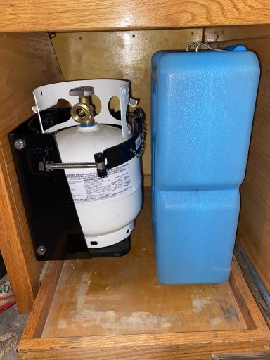

I finally mounted the propane tank in the galley of my teardrop. This niche is where an ice chest has lived for 13 years. Since upgrading to a fridge in thecopcar, I’ve been thinking how to repurpose the space. I’ve got several waterbricks that can be added to supplement the 11 gallon footwell tank in my rig.
Damn awesome! Looks great! These mounting brackets are so much better then shelling out $100+, so glad I found this thread. I also have the 11 gallon footwell water tank myself, can't wait to use it this season. Got a tankless water heater shower set up I'm itching to use on longer trips as well. Here's what I came up with for mounting on my rack for now. Stupid short garage door means I'll have to leave it off till I gear up for a trip but oh well, it's easy enough to get on/off with a couple bolts.
That looks pretty cool. It’s nice to have that kind of rack.
