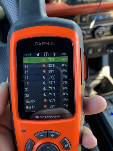

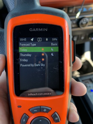

The inReach Explorer+ will let you download free weather reports or you can pay for premium weather reports.
How do those free weather reports look like? What is included? What is missing? Do these reports contain sufficient information for overlanding purposes? Thanks.
They arent bad! I dont remember what the premium ones look like., I think they might just be longer. I'll try getting one today and see how they compare. Here are some images of the free ones.

Premium forecast is for today plus 7 days, basic is just two. Same info though. Both give 2 hour breakdowns with detailed info for each two hour block.
