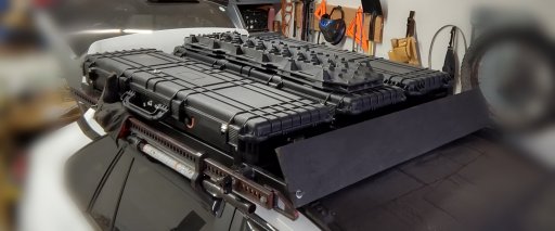

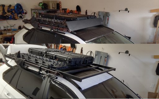

I am planning to do exactly that. I recently reworked my custom roof rack to shift the cases together, mount my traction boards, and cut out the front overhang to add a wind fairing. It looks a lot better without the gap in the center, and inspires me to add a 3rd case for even more storage flexibility. And yes, it is so much quieter in this configuration with the fairing (and yes I will be replacing the wooden fairing with an actual metal or maybe plastic one :P). The 3rd case should give me sufficient space such that the only thing I need to actually keep inside the vehicle will be my cooler or fridge, which I can put in the front seat when sleeping inside overnight.
Original setup on bottom after I relocated the case--on tp is after cutting off the front ~12 inches and adding provisions to mount the fairing.

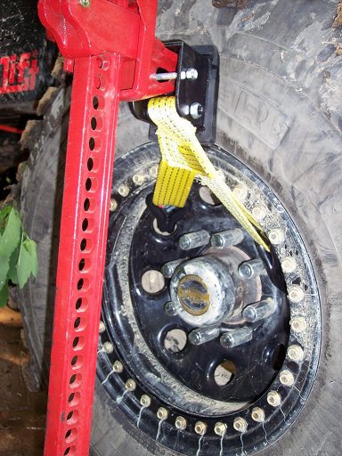

It is both for winching and lifting via the wheels (which is much safer than lifting from the armor). I also do carry collapsing jack stands and the factory scissor jack, which is only for more convenience when simply changing a tire on the side of the road. I carry enough chains to winch about 30 feet.
The only thing I can't do that I could on my fully-armed 4Runner is jack up one end of the vehicle and "cast" that end of the vehicle sideways out of deep ruts. I don't really eff with deep, sticky mud anymore, though, so that isn't a big problem for me.
The Hi-Lift "Lift Mate" is available all over the web. I bought mine for about $40 on Amazon.

How do you change a tire with the lift mate strap? I dont see how.

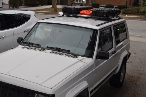

I use my roof boxes on my Jeep XJ and on a rack for my off road trailer at different times. I'm currently building a rack for my Jeep LJ and I've had to coordinate the design of each rack (pretty straight forward). I have 4 bolts in the floor of each box and simply run them through the racks. It's basically the same for my recovery boards.
The rack is not fully painted yet in this pic ...
