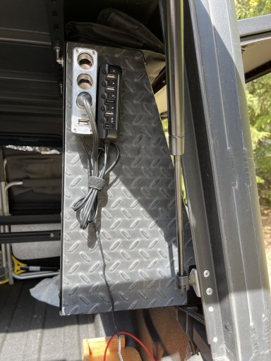

Anybody get out and do anything fun this weekend? We have been traveling via airline lately so took the opportunity for a low key weekend of doing camp prep and around-the-house stuff. I was able to get my second battery setup all finished up and did a little work on the embedded camp kitchen. Itching to get out into the wilder places!
Battery box/charger sitting in its nest
Cut up some diamond plate for magnetic attachment goodness. Kitchen cupboard is aluminum...
Canopy lights saw their first electrons! Continuing to ponder the kitchen cupboard ;)

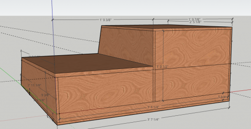

Living out of boxes in the back of my Xterra has been a pain. This weekend I designed my drawer system and ordered drawer slides. Left side will have a tilt/slide for the cooler on top with a gear drawer below. Right side will have kitchen storage on top with a double slide for my Classic Coleman stove and more storage on the bottom.

Looking good Charlie! After building several of this type of project the two biggest recomendations I can give are to use good quality drawer slides and latches, along with pocket screw joinery to attach the pieces together as it is far stronger than just screwing into the edge grain of the plywood. You can also cut fairly large rectangular openings in the bottom panel and the panel between the two sides of drawers to reduce weight without affecting overall strength. There is also a useful extension for sketchup called OpenCutList that will arrange your plywood parts and pieces to get the most of ouf plywood sheets. Looking forward to seeing the finished project at a meetup or trip.

Thanks Dave and/or Michelle, it feels like you were looking over my shoulder. This was my first time using Sketchup and it was a pretty good experience. I really liked having the ability to find problems without wasting a bunch of plywood. 500#, 3" tall drawer slides are on their way (buy once, cry once). I have a pocket screw tool and will add glue to make the joints bullet proof. I'll gve OpenCutList a try. I used optiCutter and it wasn't the most user-friendly, but it did allow me to upload my parts list via Excel.

I do like sketchup but still have a lot of learning to do with it. I tend to use AutoCAD or one of my other cad programs for most designs as I work in those all day for my day job. I have found that sketch up has some pretty cool extensions in the warehouse and a lot of them are free. Cant remember the name, but had one that let you open and close cabinet doors and drawers that was pretty cool for virtual walkthru of projects. Also just found out that my rendering software I use has an extension for Sketchup so on my next build I can do photo realistic images (since i have so much extra time..lol) Now I just have to buy a 3D scanner so I can create a virtual model of the Jeeps interior, would make cutting templates easier.

I have been using Sketchup since about 2008. I really like the extensions… especially the material tool kit. You can load normal dimensional lumber and metals directly into your project. Another thing I use a lot is the 3D warehouse. You can find almost anything (such as drawer slides) already available to import.

Soooo much to learn on Sketchup!!!
