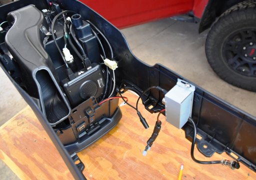

We've used a CB for many years but now the trend with the groups we go out with is GMRS. I think having both, for a while at least, is good practice. We're in the process of doing a custom install of a Midland MXT275 and 6db antenna in our 4Runner. The video will probably be available in a couple days, if you're interestedmidland2.JPG.

We've used a CB for many years but now the trend with the groups we go out with is GMRS. I think having both, for a while at least, is good practice. We're in the process of doing a custom install of a Midland MXT275 and 6db antenna in our 4Runner. The video will probably be available in a couple days, if you're interestedView attachment 138963.
I have a 4Runner too so i'd be interested in seeing your install of this. Looks like a good location to hide everything out of sight.

Our GMRS radio install and test video is uploaded, if any of you are interested.
We went with the popular Midland MXT275 with 6db antenna. We tested it against our Cobra 75WXST cb with 4' Firestik antenna. The GMRS blew its doors off! But we assumed that would happen. We also tested the range of a couple handheld units. They were pretty impressive too.
That was a clean install. How is heat build up addressed?
