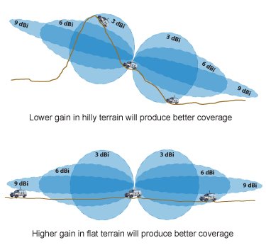

Did you buy an extra antenna or do you plan on using the one it comes with? I am looking at this radio, but know nothing about what antenna to use.
For GMRS, you're looking for an antenna that covers 462MHz and 467MHz. The gain of the antenna determines how "pinched" toward the horizon the signal will be - more pinch meaning greater sensitivity to a signal on the horizon and more transmit power pushed toward the horizon. The downside of high gain is if the other station is much higher of lower than yours, they won't be "in the beam" of your antenna. The supplied antenna is 0dBi (omnidirectonal and certainly good enough to start with), 2-3dBi works well in hilly terrain where distance will be limited by line-of-sight anyway, 4-6+dBi is great for flatter areas (including highway).
I have a stubby Laird Phantom (AmazonLINK, 3dBi claimed, but perhaps less) and a Midland MXTA26 (AmazonLINK, 6dBi claimed, but it's too short the SWR minimum is well of 470MHz) in addition to the antenna that comes with that radio. I've have a Diamond Luggage rack mount that either the Midland or Laird will screw onto, depending on my plan for the day. (The mounts are cheapest on Gigaparts.com. Roof is 2-3 dB better than hood or trunk as a mounting location, but all work. I suggest buying one with the cable included unless you're proficient at soldering the connectors on. HINT: Buy a good mount, since a crappy one can easily lose you half of your signal power (3dB).)

That first graphic is one of my favorite to share when people start getting really worked up on high gain antennas. Many times in the terrain we work in that's counter productive.
There are several versions of it, but I appreciated seeing it (or one like it) one of your (?) earlier posts - it *really* clarifies what's happening for those starting out!
