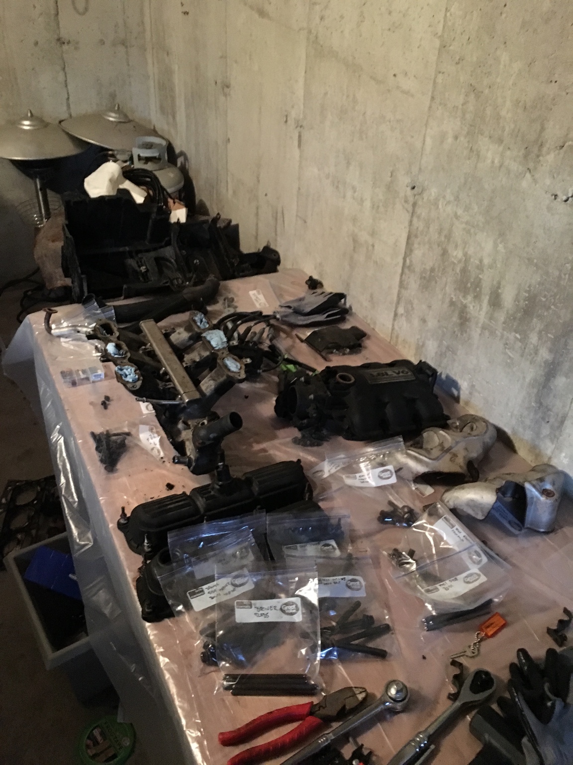

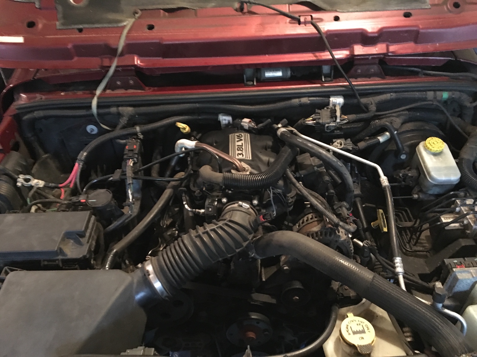

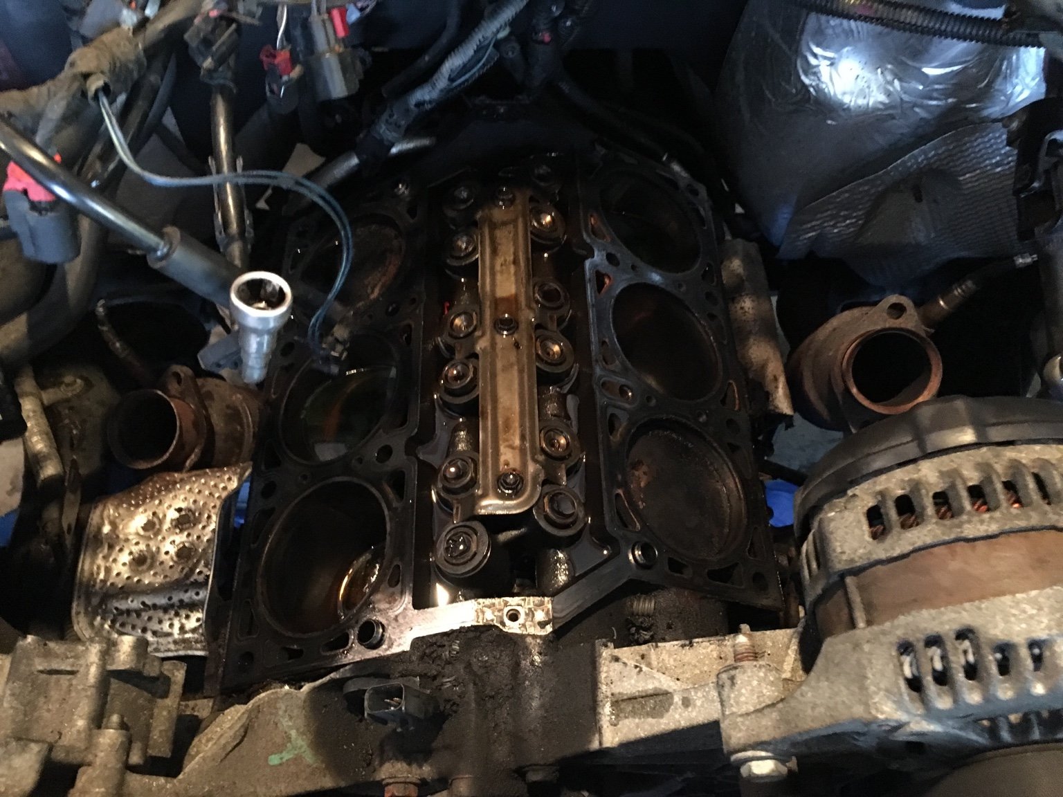

So 9 years and 200k miles later I have retired it from daily driver duties and really only use it for when I need it in winter, trips, and weekends because of some big maintenance I just completed. Last fall the radiator blew and after having it replaced, the head gaskets started to leak. I'm never getting rid of this rig, and couldn't afford to have all the work done, so I did it all myself. Tore the engine down to the block, had the heads checked and cleaned up, then put it all back together with new exhaust manifolds, thermostat, and all the gaskets, bolts, etc. that go along with it. This engine is running as smooth as the day I got it, it really is unbelievable.

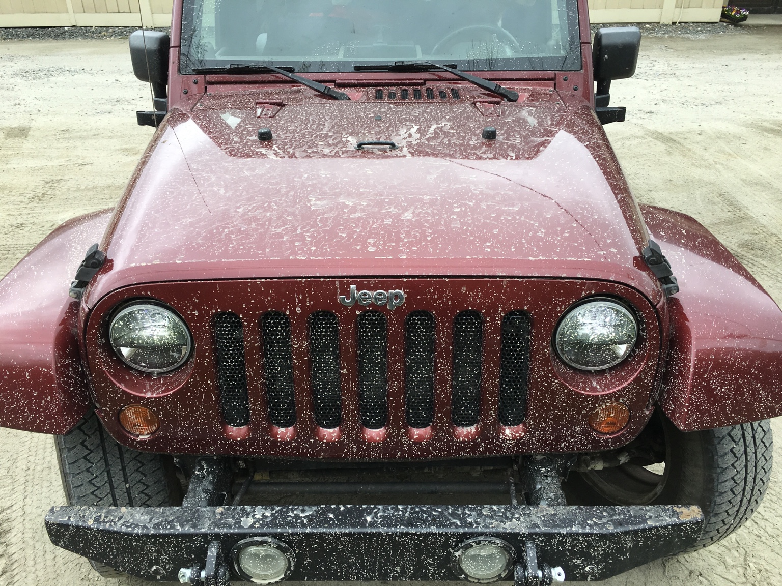

Added heated Trucklite LEDs, Olympic 4x4 front and rear Rock bumpers with D-ring mounts, and some pictures of the engine getting pulled apart for the head gasket replacement.
Down to the block
Everything spread out
And back together again...

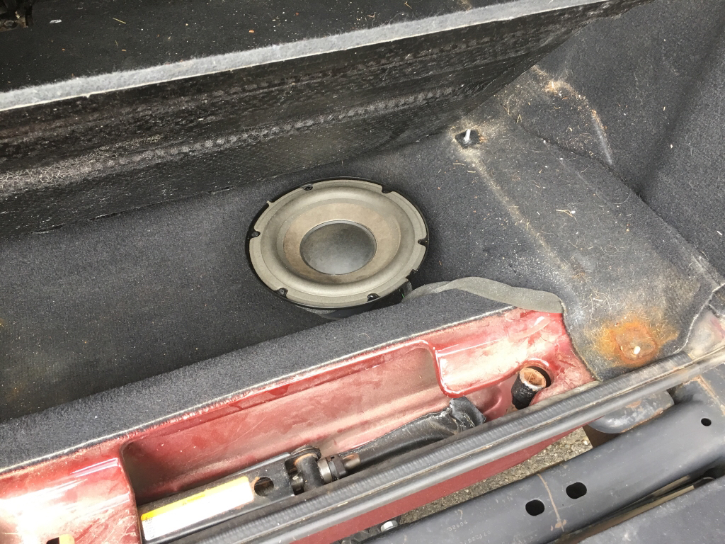

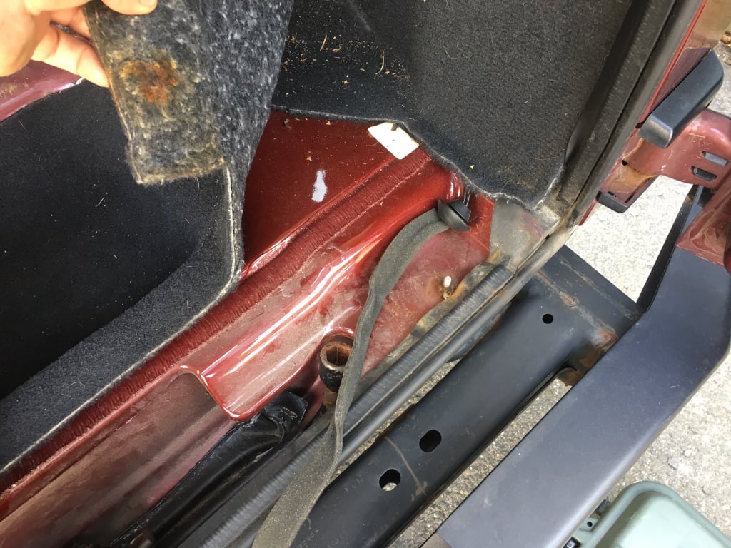

One of my least favorite designs of the JKU is the subwoofer box in the trunk space. It is so awkwardly placed, blocks about 6 inches of space and creates this little nook behind it that rarely gets filled with gear when loading up. I was surprised to see that nobody had really posted any fix for this on any of the usual forums, which was especially surprising when I started taking it apart and realized how easy it was to fix. I unbolted the box, took the cover off, unclipped the electrical connectors, and it was gone. Then to move it, I pulled the wires back under the carpet and routed them down in the cubby hole below the trunk, reconnected everything and secured the sub so it couldn't move. Piece of cake, took about 5-10 minutes and the only thing I am trying to decide is whether or not to cut a hole in the floor and reuse the cover to make it look nicer, but it sounds fine like this so I may just leave it. Here are some pics.
The wires are long enough to just pull them back under the carpet and route them underneath the carpet to the cubby hole.
Speaker sits right on the end of the cubby.
